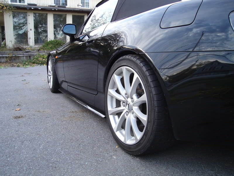

OEM AP2 rims with 15mm front spacers and 15mm rear spacers:
15mm rear spacers installed:
25mm rear spacers installed:
