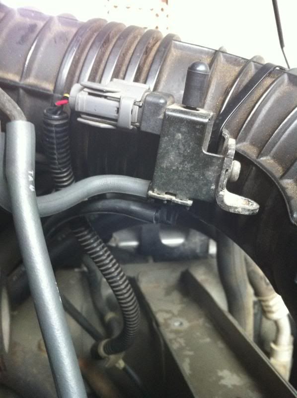

Thanks billman. I read your post prior to checking my air pump and I specifically looked around and felt around it by taking the front bumper off. Everything all good. In thinking it's the valve sticking. Anyway to treat it before replacing the valve completely? Btw anyone have an actual pic of how the white check valve is positioned. Several diagrams are confusing.
Btw what type if electrical failure do you mean. The stem works, turns on and off during cold starts.
According to this pic here I found, my white check valve is fitted on correctly:
http://image.hondatuningmagazine.com/f/886..._Space_View.jpg
Another issue it may be is in this pic. of the solenoid valve, there is a long round item placed on top of a suction valve, in mine, it is just some sort of plastic cap that restricts suction.
http://image.hondatuningmagazine.com/f/886...enoid_Valve.jpg
vs mine:

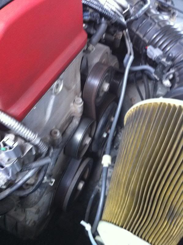

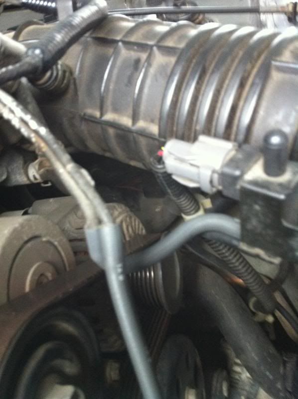

Here are a few more pics i took in case you guys can spot something that i couldn't:

I think i see your problem
Take that vac cap off the valve. That is supposed to be a vent. Not plugged.

i've tried removing it off but the code came back, ill try one more time. The other link I found with the picture of the valve has some sort of Round cap on the valve..

I believe the part of the solenoid that was capped off vents the vacuum out to the atmosphere when the solenoid turns off the vacuum that opens up the air injection valve; when I had this code my solenoid lines were swapped and I heard a constant sucking noise; it almost sounded like a bearing going bad. Mine showed up after I put in a K&N FIPK - just FYI for future readers.

Funny thing is I suspected that cap few days back examining the hoses at work. Anyway, I took the cap off, reset the ecu. Drove it around and my idle started dipping low.. I suspected the cap was supposed to be on so I stopped and put it back on.
Anyway, I believe the RPM dipping was only due to the ecu being reset trying to re learn again. Ive reset the exu multiple times after this situation and the rpms dip low after and returns to normal after a few min. of regular driving.
Anyway, I've taken that cap off again, did a cold start and no light so far. Drove around for a few min, rpm is good again. I'll follow up the next time i do a cold start.
