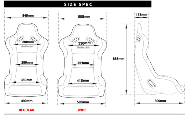

Hel, these are MB's seats, check out the XL's
http://www.sportseat...bP1SeatSize.jpg
and these do fit in OEM
http://www.sportseat...lubSeatSize.jpg

Thats a brilliant help, many thanks for this, makes the whole thing a whole lot easier. I can see already that the Corbeau seat is narrower than the seat here, will do the other measurements this week and post up.

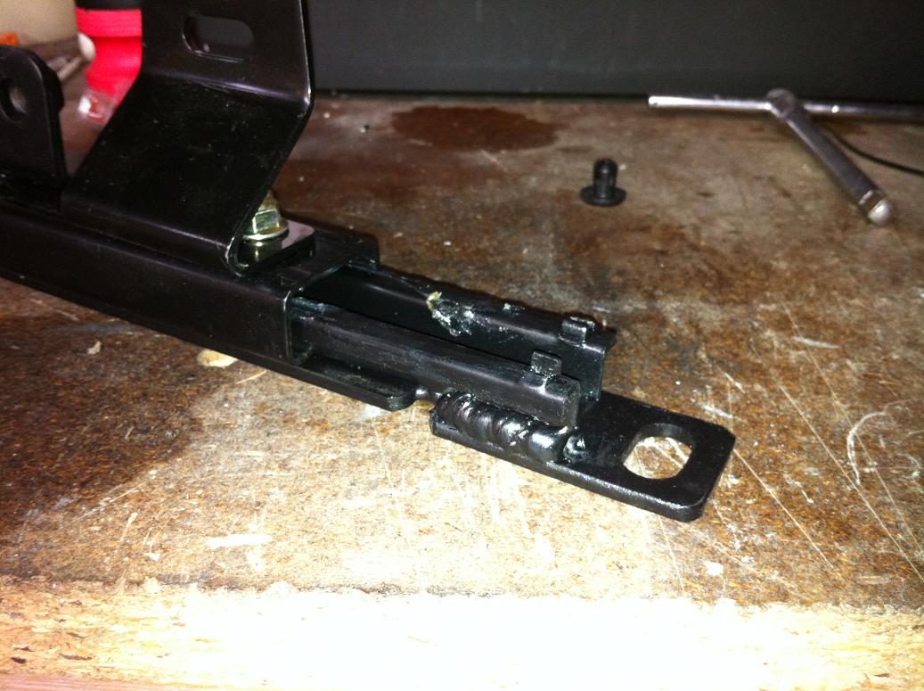

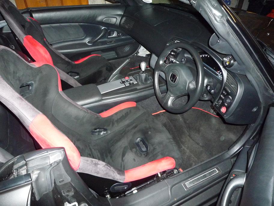

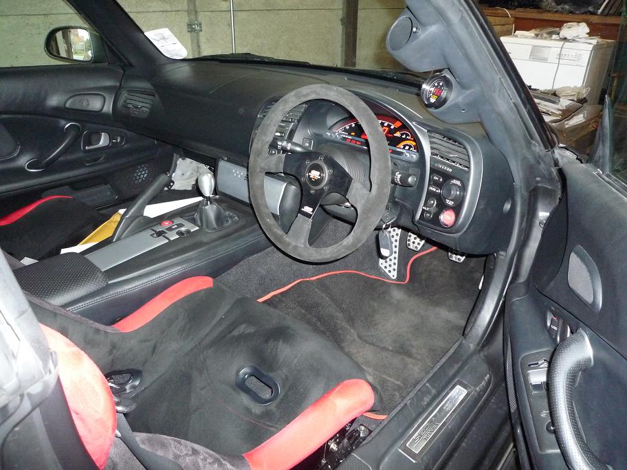

Here's some pics of those Buddy Club XLs fitted on BC rails.
They are a bastard to fit, although don't foul the door or the centre storage thing.
IMO they are a little too wide for the S. They struggle to fit into the rails and have to be at quite a specific height setting to not clash with the gearbox tunnel.
Posted Image
Posted Image
It's probably the rails at fault. I had to slot the bolts so I could push them out a bit wider in the car. Also had to reinforce the welds on the rails as they snap.
Posted Image
Love them though, one of the top mods for an S2000 is a seat.
