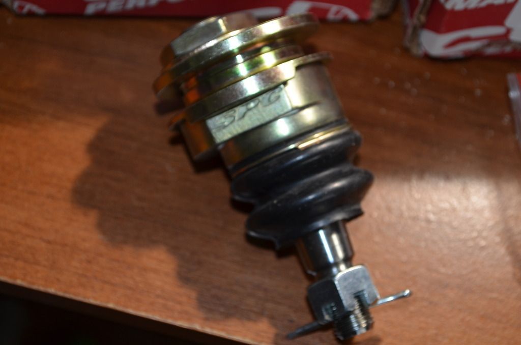

Received 7 Likes on 7 Posts
Spc camber ball joints came in. I will only be putting these in the front. From my research i understand the s2 is capable of alot of camber in the rear without needing camber ball joints
