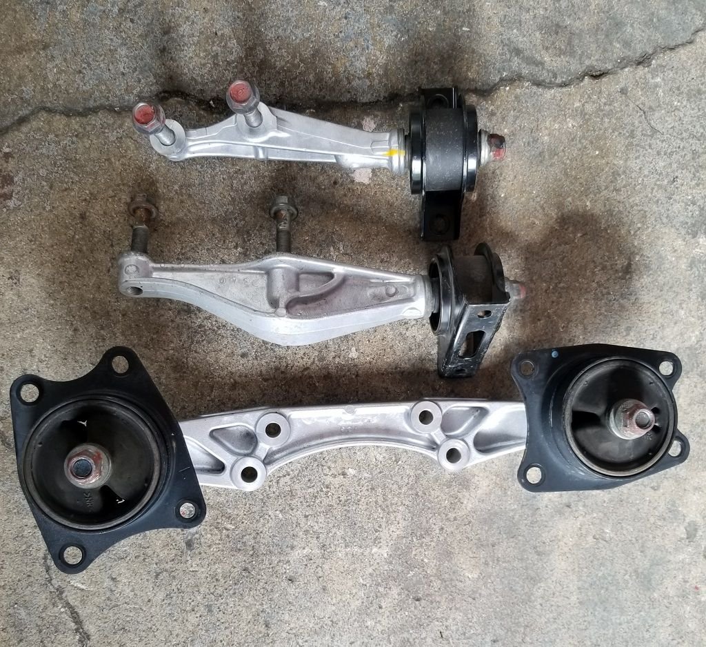

I found a good deal on all four diff bushings, used but in good condition. Saved some money on this expensive project. There was only one bolt in the original assembly that gave me trouble. Fortunately, the seller supplied me with the bolts. I applied anti seize to them.
Here is the difference between the OEM rear lower ball joint and the Buddy Club unit.

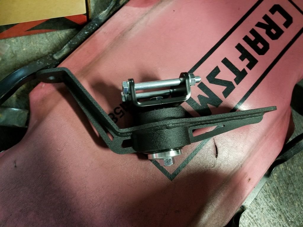

This has been a mod I have wanted to do for a while in my previous S2000's, I want that trans firm in its place. The Innovative Mounts transmission mount is a very nice piece.

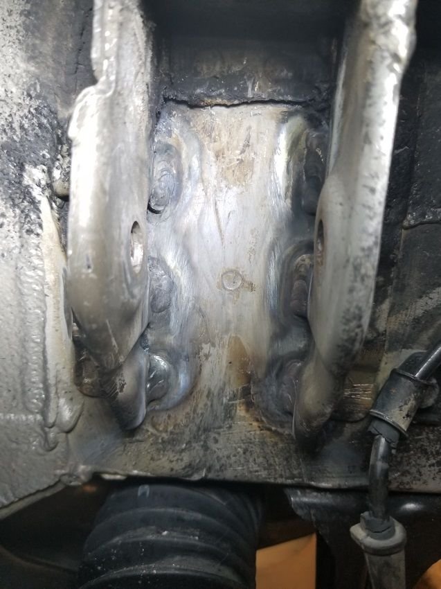

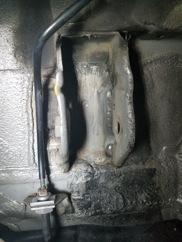

Had the inside of the UCA brackets welded. I am going to add a small bar between each bracket like the AP2 as well.
