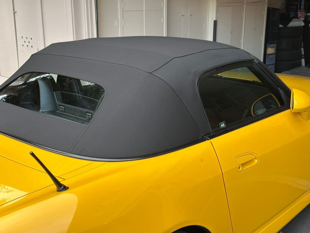

Here is the
Here is the "after." Stayfast is a dark black. Nice and tight. Crisp glass window.
Wonderfully done.
Wonderfully done.

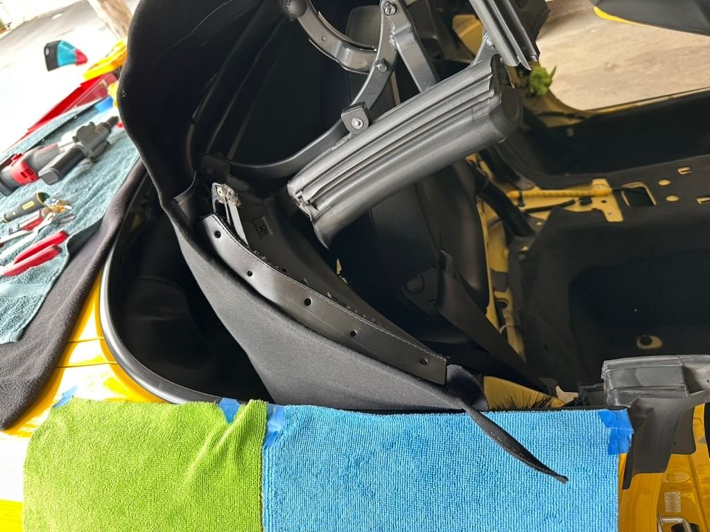

Organized and detailed, he puts down towels and microfiber cloths to prevent paint damage.

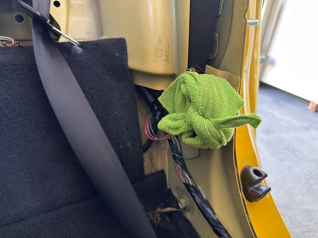

He even goes the length to protected the gas door opener by making sure it doesnt catch on clothes.
He even goes the length to protected the gas door opener by making sure it doesn't catch on clothes.

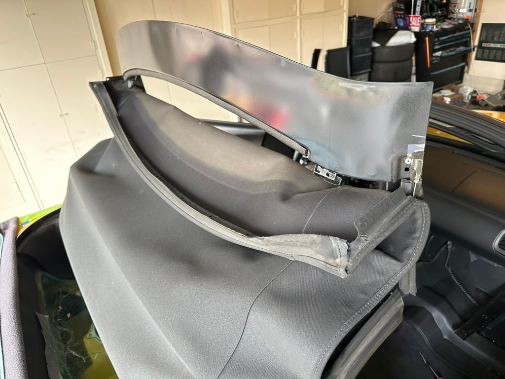

Hes efficient with disassembly. Even working in tight spots like the rear, he tries to not damage the plastics.
He's efficient with disassembly. Even working in tight spots like the rear, he tries to not damage the plastics.
Seeing progress with the removal.
Seeing progress with removal.

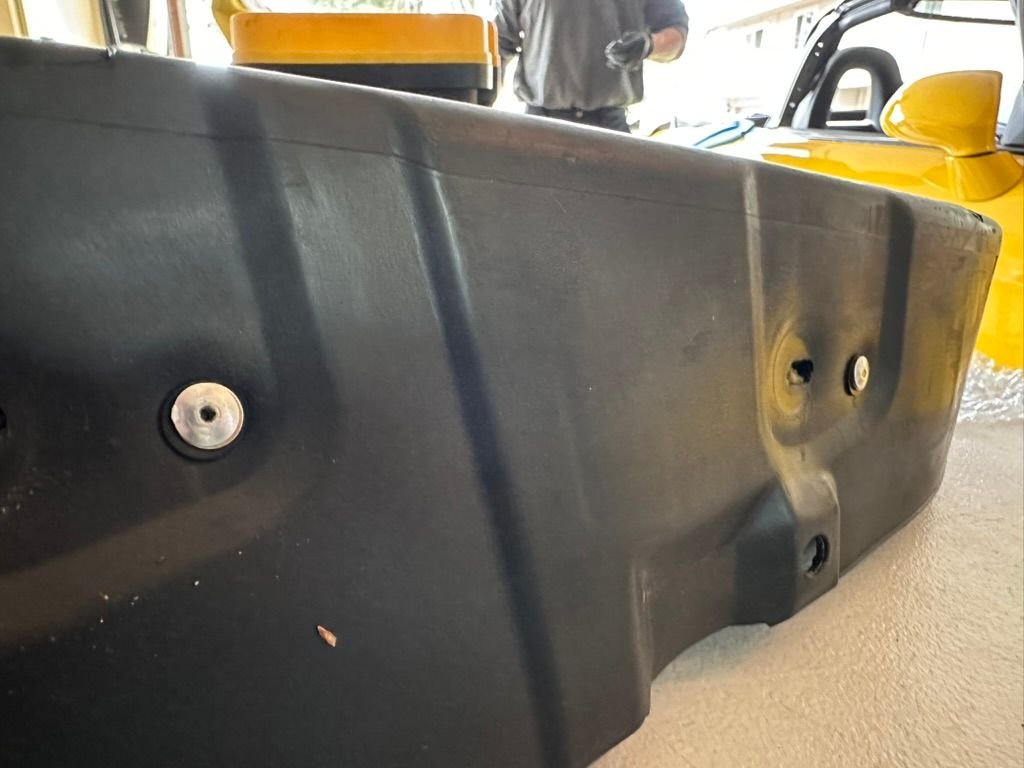

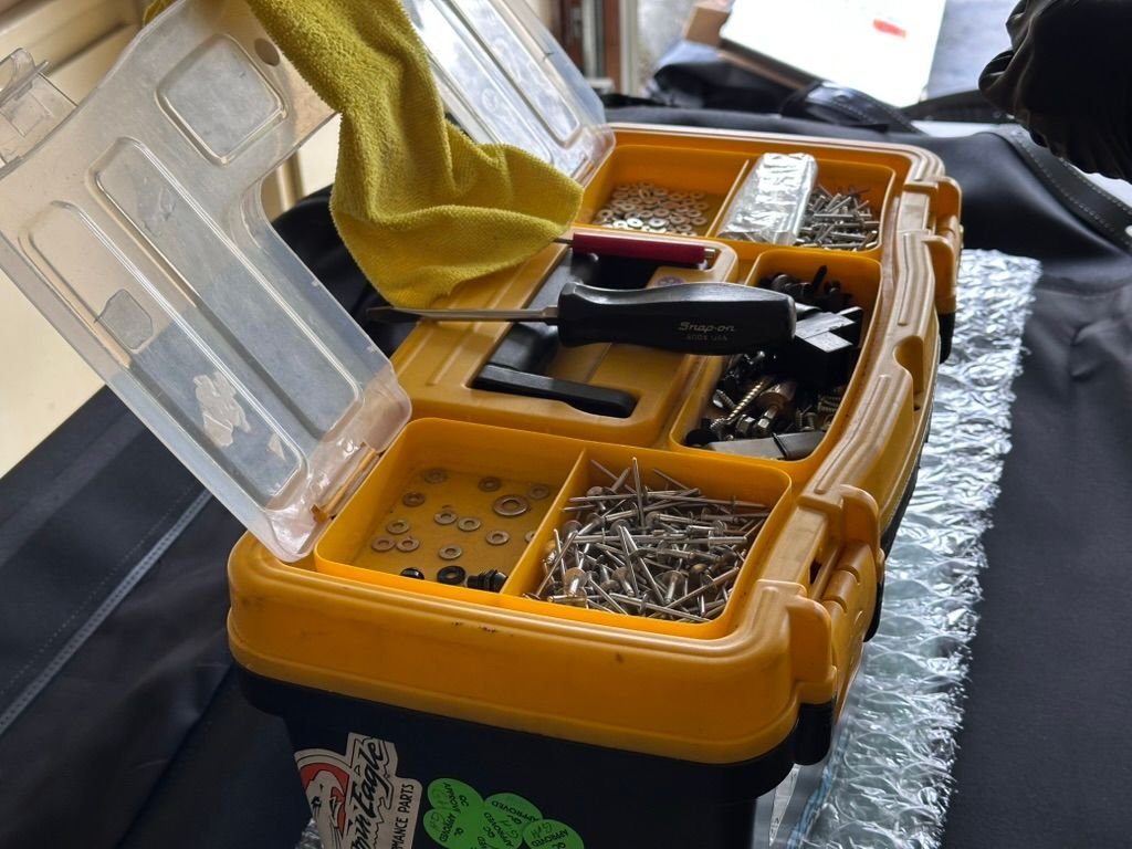

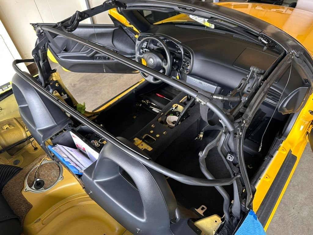

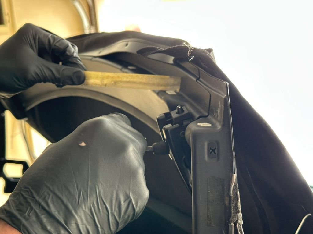

This is an example of the extra steps he takes to make sure his work is quality. He collects the metal shavings whenever drilling out the rivets.
And there are A LOT of rivets. Heres a catch cradle he used to collect more shavings.
And there are A LOT of rivets. Here's a catch cradle he used to collect more shavings.

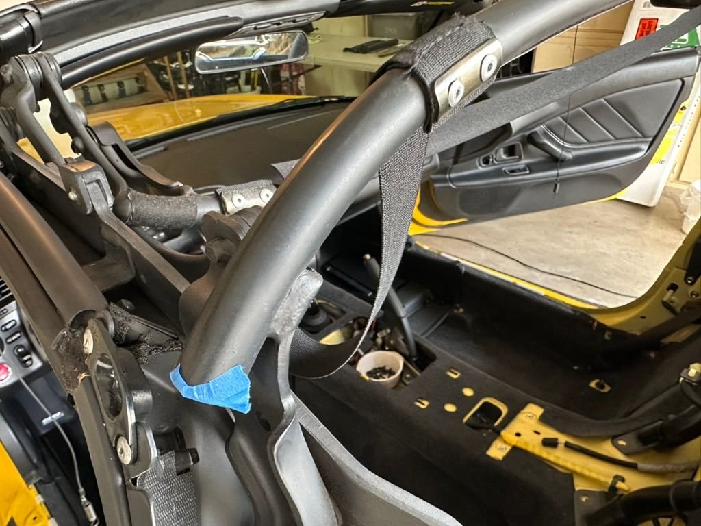

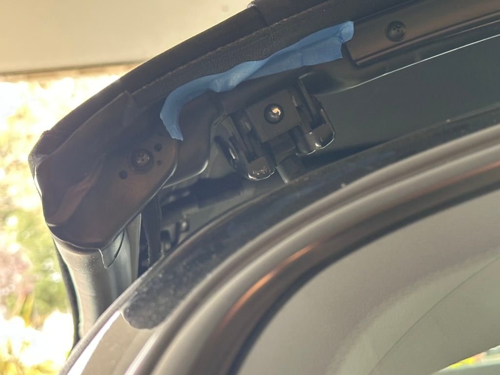

He used some painters tape to plug the frame while drilling out the rivets to prevent the metal from falling out into the interior.
He used painters tape to plug the frame while drilling out the rivets to prevent the metal from falling out into the interior.
Looking like a race car.

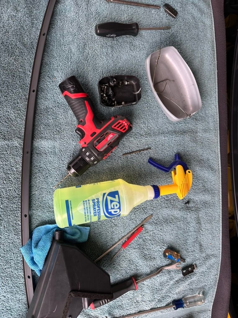

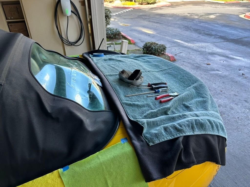

Even while working he kept his workspace tidy.
Very organized.
Very organized.

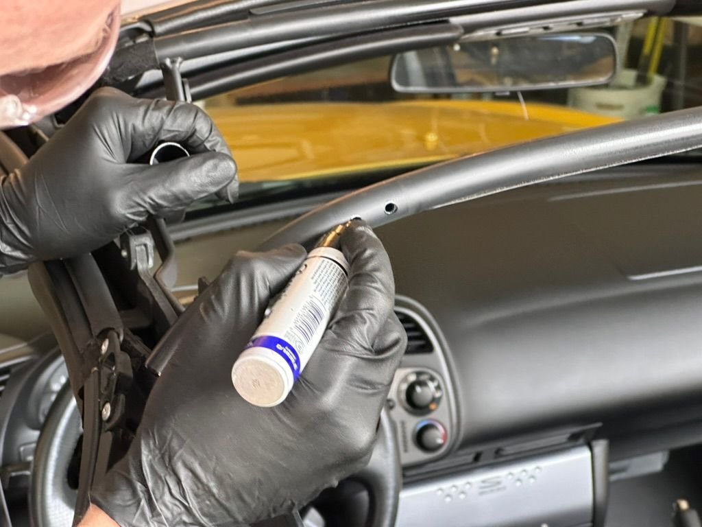

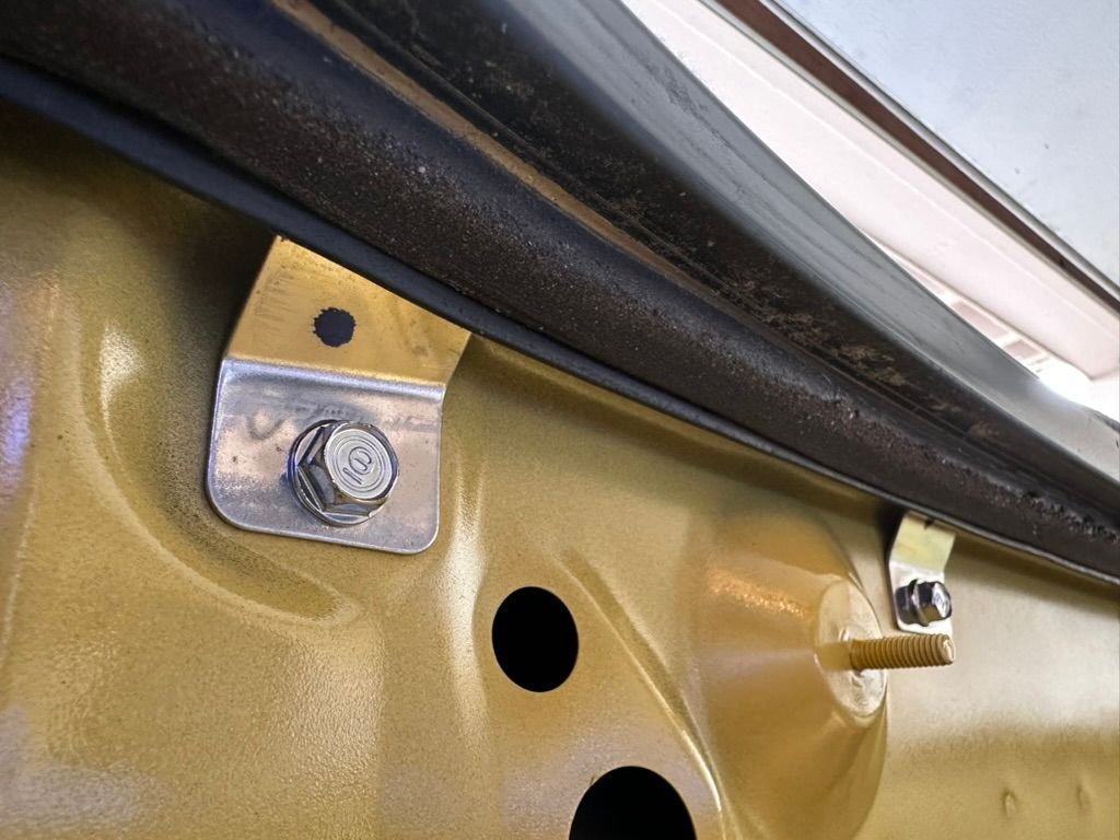

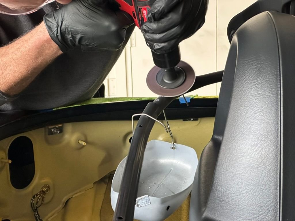

This is the extra things Mike does. The exposed metal from drilling he touched up with paint. He checked for burrs on the frame, sanded it down, and touched that up with some black pain too.
This is the extra things Mike does. He used touch up paint on any exposed metal from drilling . He checked for burrs on the frame, sanded it down, and touched that up with some black paint too.
Protectional against corrosion

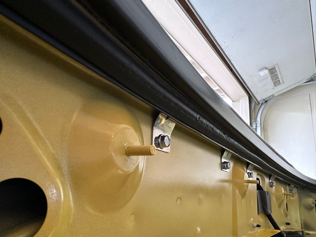

Early AP1s needed extra holes to attach the straps to.
Early AP1's needed extra holes to attach the straps to.
He measure meticulously and drilled out each hole cleanly. Use a flat disc to clean the edges. He also filled in the exposed metal with paint.
He measured meticulously and drilled out each hole cleanly. Used a flat disc to clean the edges. He also filled in the exposed metal with paint.
He used some of the Robbins hardware and for other rivets, used his own to keep it close to OEM as possible.
He used some of the Robbin's hardware but for other rivets, used his own to keep it close to OEM as possible.

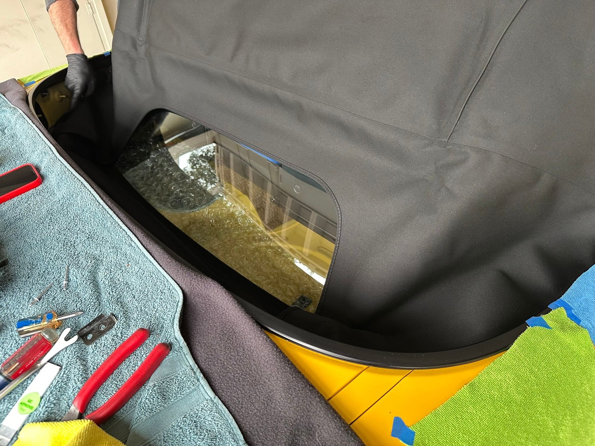

First time setting the new top being mounted.

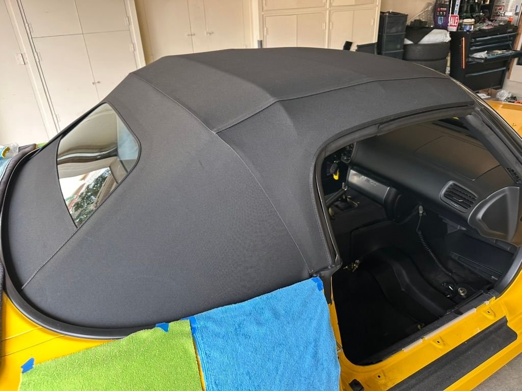

Some painters take to prevent lifting.
Then he used a clamp WITH microfiber cloths to prevent marring the finish. Steps like this show that hes proud of his work.
Then he used a clamp WITH microfiber cloths to prevent marring the finish. Steps like this show that he's proud of his work.

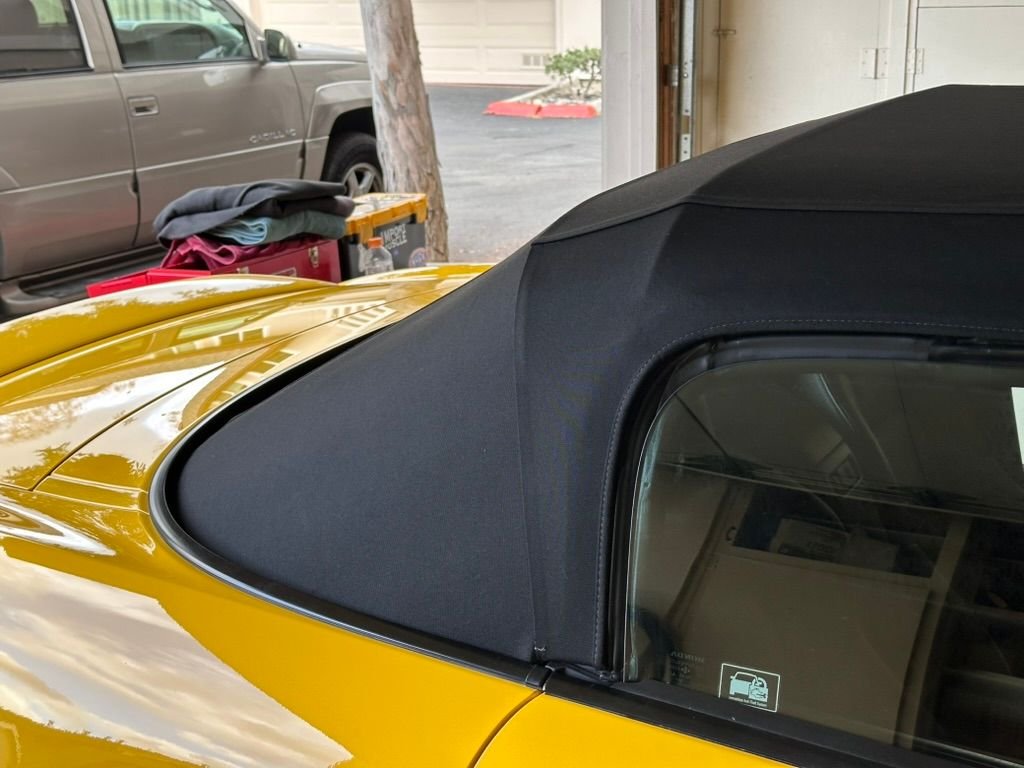

The weatherseals were massaged with Shin Etsu.

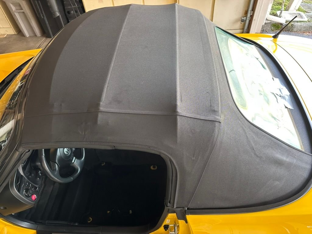

The best the car looked since coming out of the factory.
