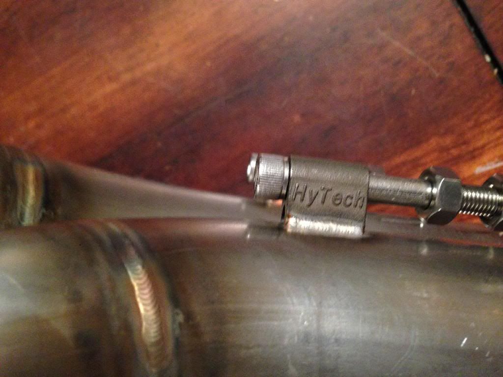

Gotta jet coat it then install

Neat!
I recommend you under the car and someone else above, feed the header up towards them and the two of you talk it out as you gently work it upwards. this will minimize the chance of rubbing/scuffing/scratching it at all. Not my favorite thing to take on/off the car.

Yeah it's a pia

Not sure if all sequential headers are like this, but my Ballade Sports necessitated the removal of the passenger side engine mount to go in smoothly. I would recommend that route. Oh,your car is going to sound a little weird as well. Something about the way the exhaust gases pulse out. Almost sounds cammed on cold starts.
