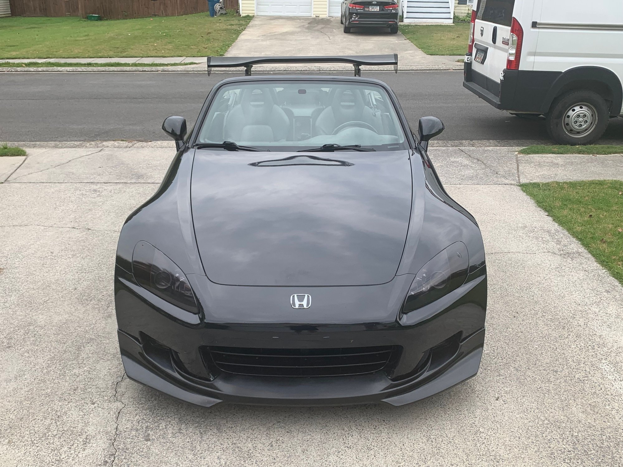

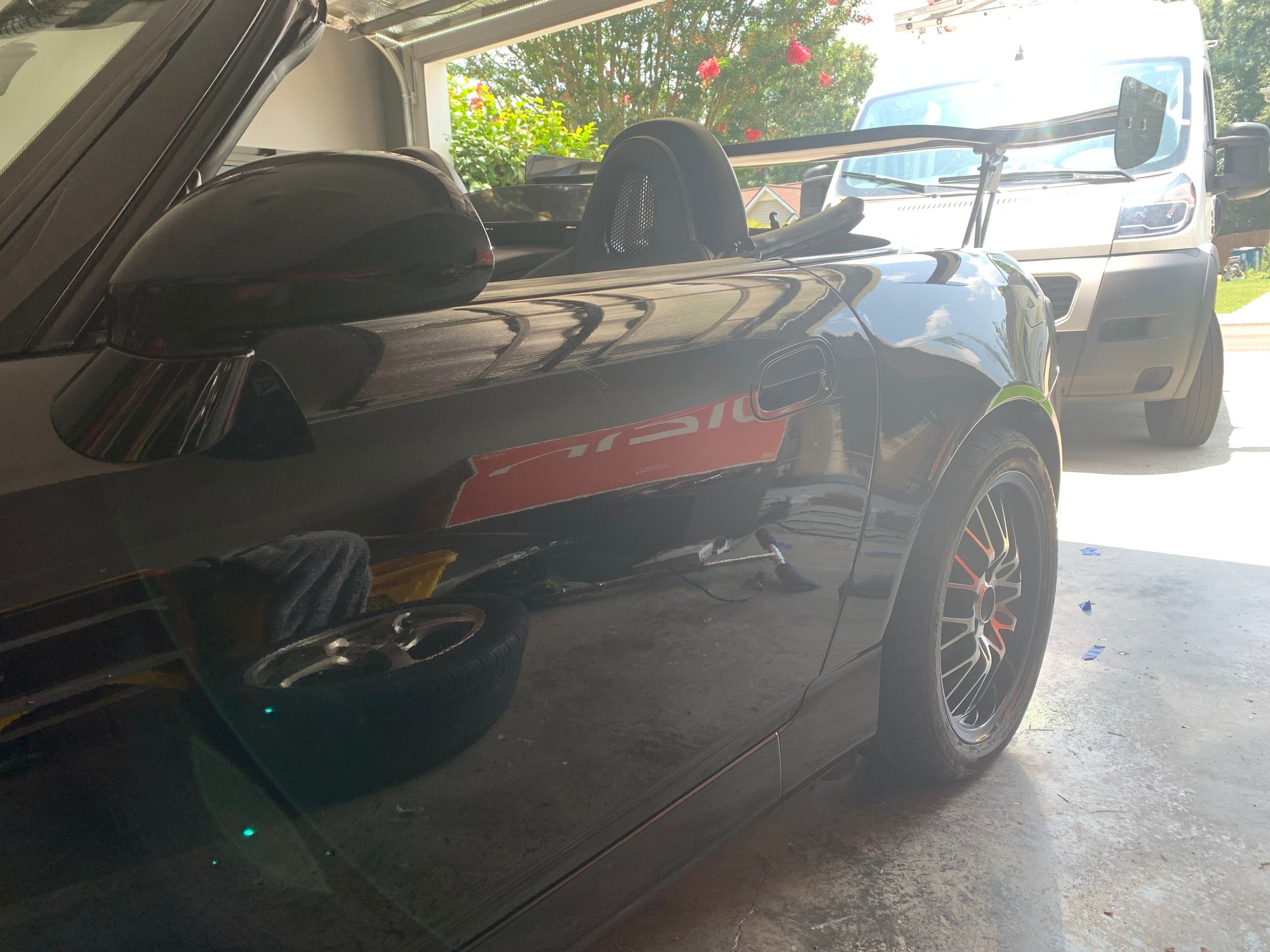

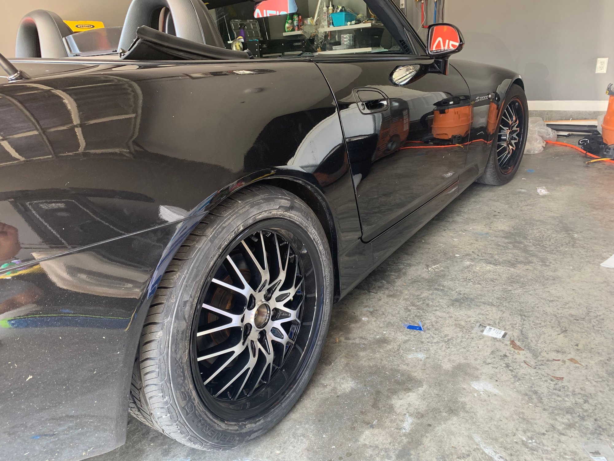

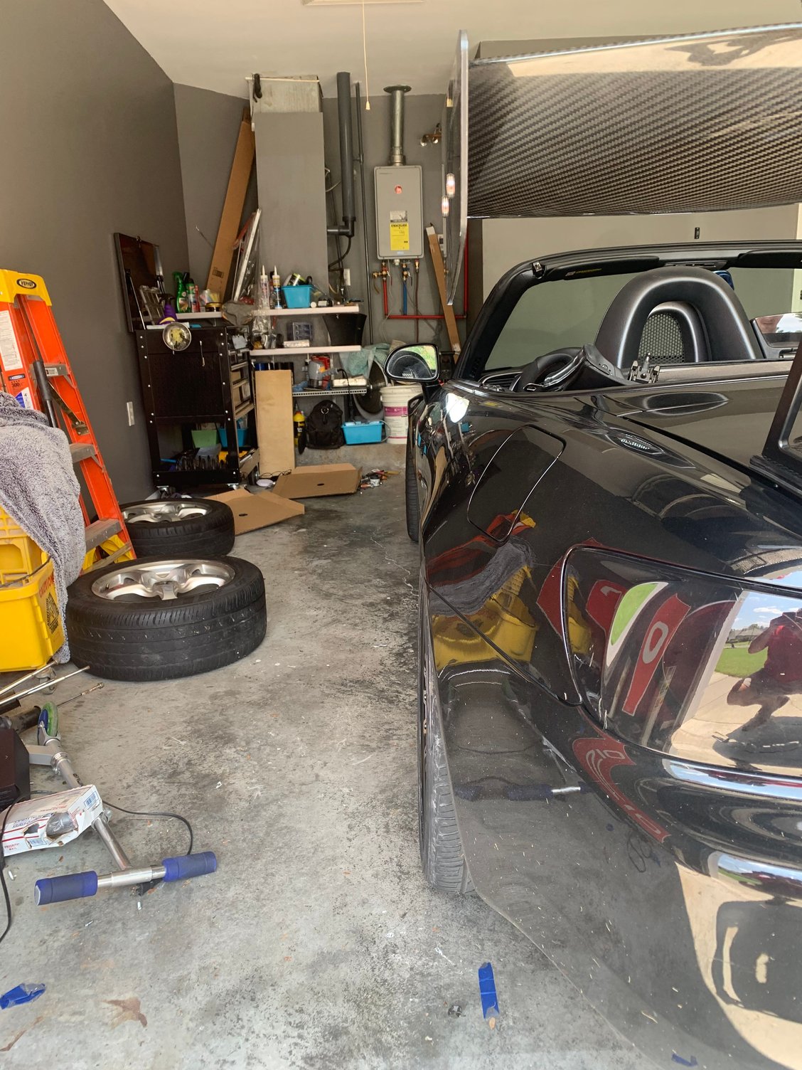

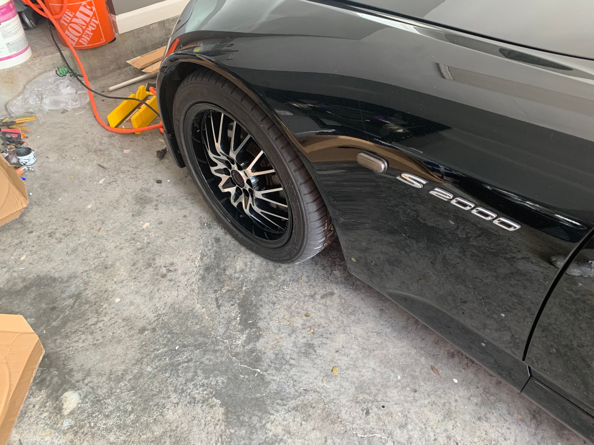

Just thru the absolute best spec wheels on my s2k. Talk about fitment. Just look at the pics.
Konig lace
17x7 40 offset w215 tires
17x8 45 offset w/245 tire
brand new koni yellow wSpec R springs
pends reclocking and alignment. next week.
absolutely no modification needed to fender.. I’m not even hitting the rear bumper tab., but I may still relocate.

Those headlights look amazing, how did you achieve that blacked out look? I just got some JDM AP1 headlights to get rid of the amber but man yours look sick!

VViViD+ Ultimate Headlight Taillight Tint Vinyl Wrap.. super easy..
