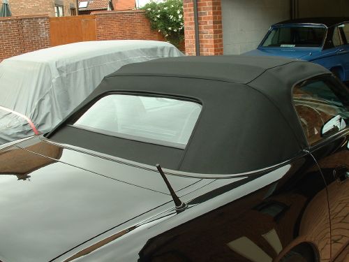

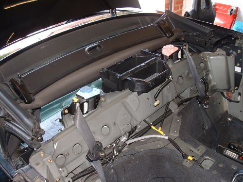

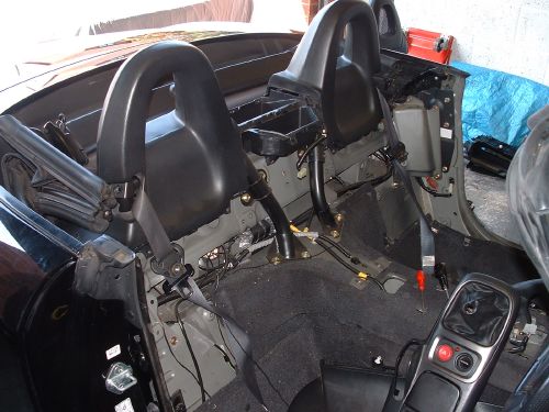

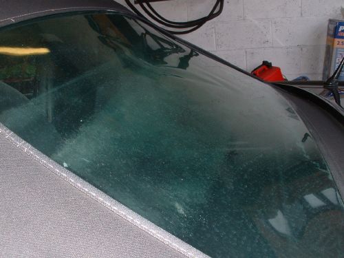

My new hood arrived from Monsoon first thing Thursday morning. So I made a start on dismantling the S. I decided to follow the write-up from the FAQs, the main difference being that I didn't slash my old hood off to start with. My theory being that, yes ok, it would have been easier to dismantle everything with the old hood removed, but I still had to reinstall everything with the new hood in place. Replacement would be the reversal of removal. This isn't an in-depth step-by-step guide, just a few pics I took along the way. I had to ring Monsoon 2 or 3 times for assistance, I spoke with Michael the fitter & he was very helpful.

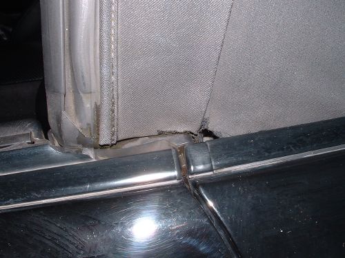

The old hood...
Removing half the interior...

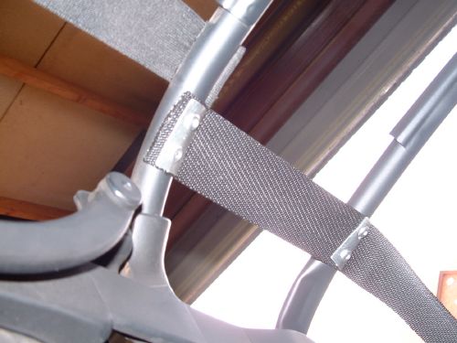

As I was changing from a plastic to a glass rear screen, I had to rivet on an extra strap either side...

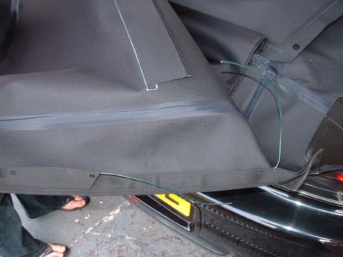

I threaded some plastic coated wire through the new hood where the tension wires need to be pulled through.

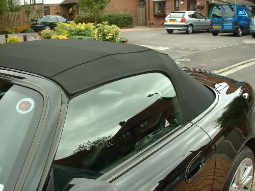

The rest of the install was much the same as in the FAQs.

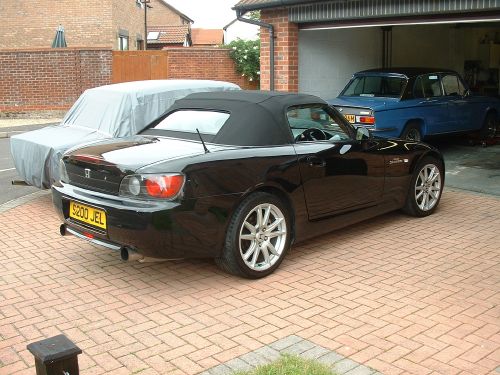

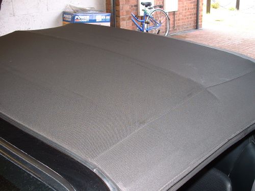

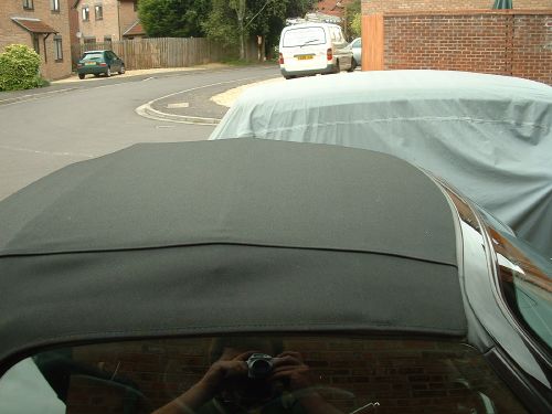

The new hood fitted...
An early Birthday present for my S, who will be 10 years old on the 9th September.
I wanted to replace the hood myself, mainly because I like to have a go at these things and also to save the installation fee. If anyone wants to ask me any questions about the install, I would be only to pleased to help.

Excellent job! well done.

Looks like you did an ace job, and I am impressed by the cleanliness of your car too. Great job.

Your S looks fab with the new hood. Good effort for giving it a go and succeeding
