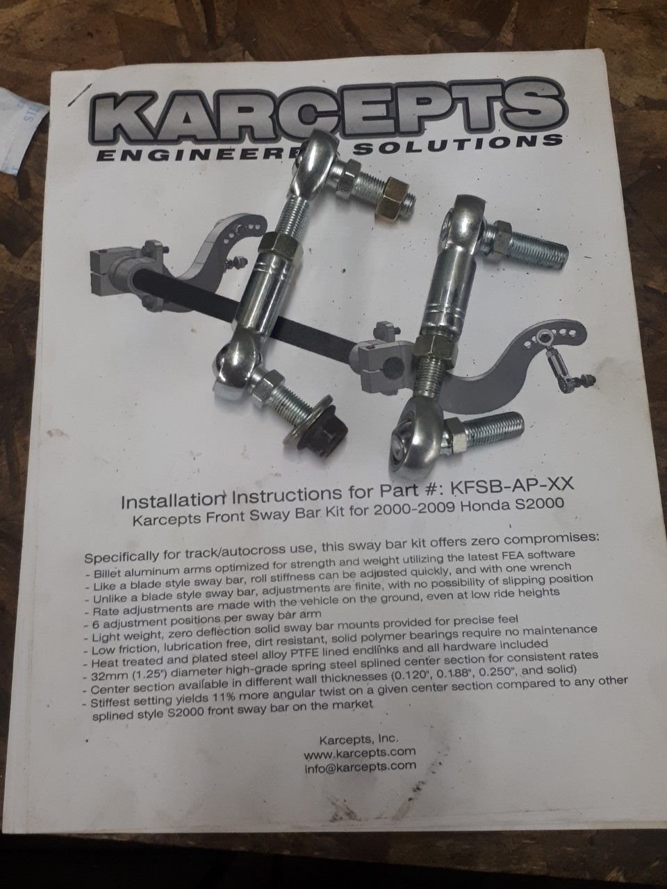

Pressed in some new Hardrace compliance bushings. Both front and rear upper control arm bushings, and front lower shock bushings on order as well, but due to being on back order, will be a project for a later date. Bought new end links for the front Karcepts sway bar, as the old ones had developed some play and were rattling .
