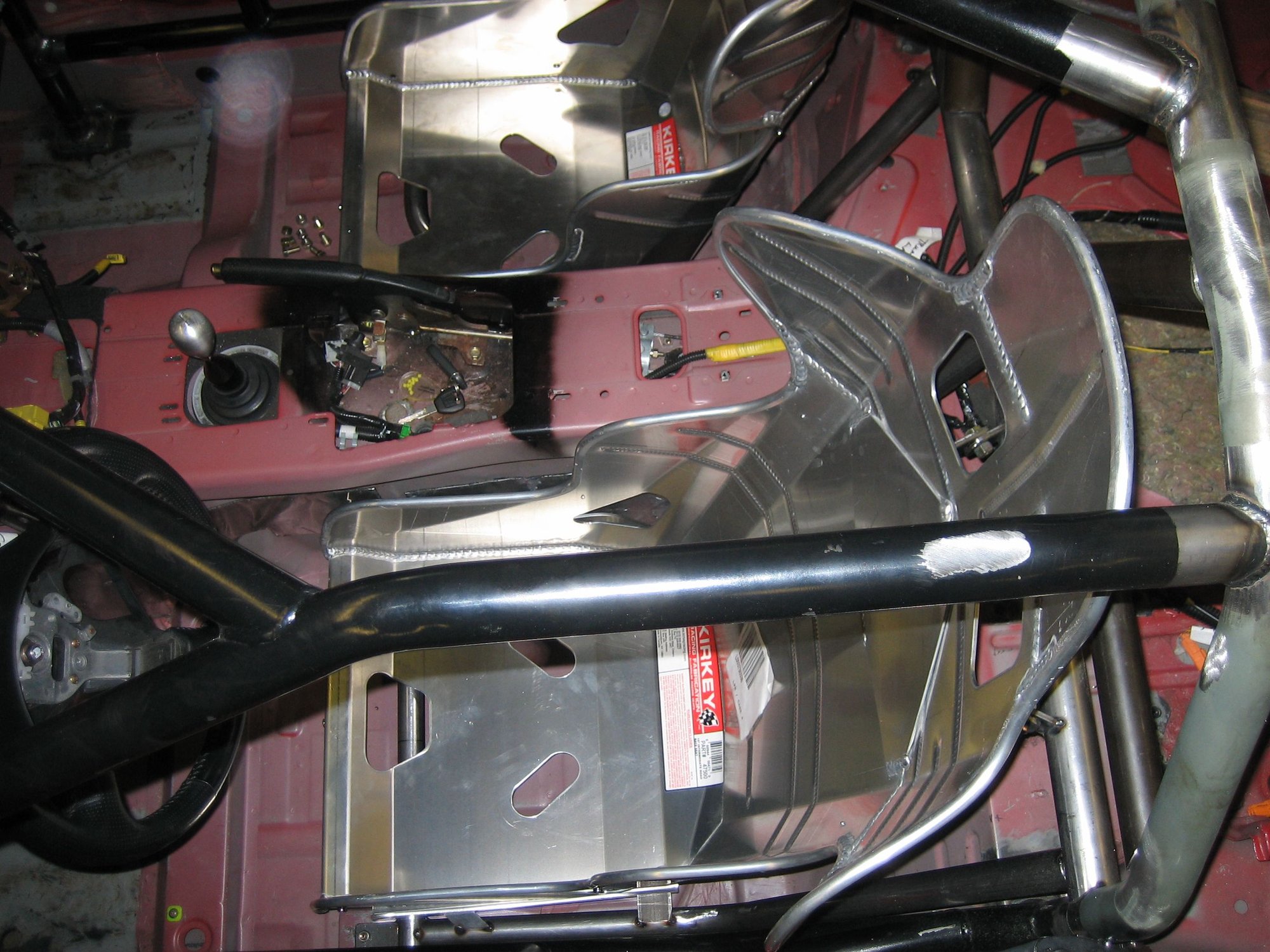

My setup is a one of kind setup because my seat/seat rails attach to my cage. The cage is built in such a way that the cage has an extension that goes into the seat well area. I use a Kirky aluminum seat and their mounts work easily for my seat/cage setup.
The seat rails attached to cage extension.
Seat in place.

Thanks for the pics Greg. I`ve heard of guys mounting them directly to the floor, but was never really sure what that looked like or whether it was an option for me. I think that they all had cages so I assume that it's something like what you did.

Interesting to see how Kirkley cut the anti-submarine hole in the seats. I need to so something similar to my Vintage 31 seats.
Ah, sitting on aluminium is hard on the rear end. I had to get some surgical foam and make myself a cushion.

I hadn't noticed the 3 holes my first time through the pictures. Why 3?
I assume the two further back are for the 6pt parnesses, but what's the one at the front?

I believe that would be (not really sure) to release the belts in a situation where the seat is mounted so close to the floor that you can't slide your hand under the front of it.
Some race belts have a quick release latch that holds the belts down under the seat.
