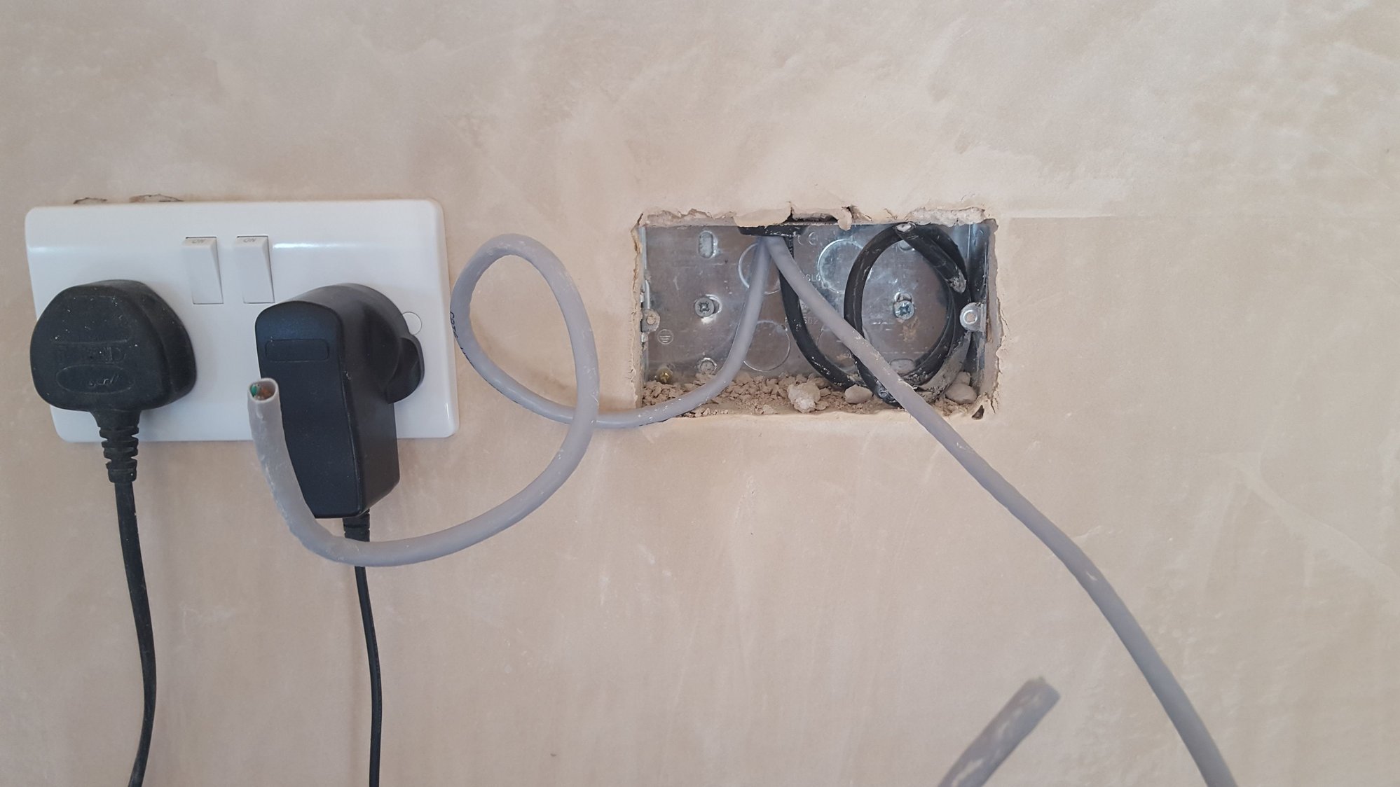

One socket with two Cat6 cables plus one coax
I know it's Cat6 cable coz it's written on it!
There are three more such sockets, two of which are at TV sites with the other one at the furthest point from where the connection enters the property (each has a single Cat6 cable and single coax apart from one of the TV sites which has a single Cat6 cable and two coax cables)
All cables terminate in a cupboard on the ground floor which also contains the telephone/broadband socket and where I anticipate siting the router

Are you still speaking to your sparks? Presumably he has/had a good idea of your requirements vis-a-vis smart TVs, Sky and the internet.
First off I would ask him how he planned for your needs to be met by his first fix coax and cat 6 cable runs - can he give you a diagram - and what devices he had in mind e.g. TV coax signal splitter/amplifier. Are you sure all the coax cables go to the cupboard or is there one coiled up in a loft space ready for a specialist aerial man to fit a TV terrestrial aerial or satellite dish? You will of course need mains power in the cupboard for your router.
edit: Your house being big, the 'furthest point' cat 6 may be intended for a wifi retransmitter, though in my experience one alone of the powerline variety still might not give you 100% coverage. See what performance /coverage you get with your (the ISP's provided) wifi router in your cupboard by the line entry box and go from there.

Architect will have all that stuff but I remember ruling out anything in the roof spaces. As I said, there is a cable between eaves and cupboard which is for a dish but I would be much happier with a streamed service sans dish. There is a map/plan somewhere so I will find out what wires lead where. There is power in the cupboard which houses the supply entry and fuseboard. The router and/or Sky box can run off that.

Ok await diagrams but where there are double cat 6 / double coax electrical boxes suggests added devices/function not just a smart TV to watch.
The person buying may be old school and want to use direct terrestrial TV or satellite. That is why your architect/sparks provided for coax.
Although there is power in the cupboard is it ventilated? Dunno about Sky but my BT Youview TV box used to get quite hot.
Also you will need to get command signals from the Sky remote control to the Sky box - magic eye or such.
