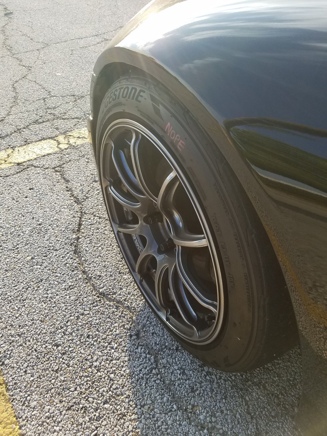

Originally Posted by s2000Junky
There will be a problem up front without wide fenders or a serious pull. Especially so if this car is getting tracked with 255 tires. We aren't talking about some yahoo looking to run a 215 on this wheel and limp from parking lot to parking lot. I assume you understood this from the OP, but maybe not.
They're like...3mm more agressive than my wheels. 17X10 +50. Easy peasy fit.

Received 0 Likes on 0 Posts
Looks good! What camber setting is this?

Received 1,240 Likes on 941 Posts
I'm using like -3.2F and 3R. Stock (folded) fenders. Not pulled or flared. Just lip rolled. Fender liners have slits in them for the edge of the tires.
They're SPC upper ball joints. They'll never slip if you install them properly.
I track it a bunch.
