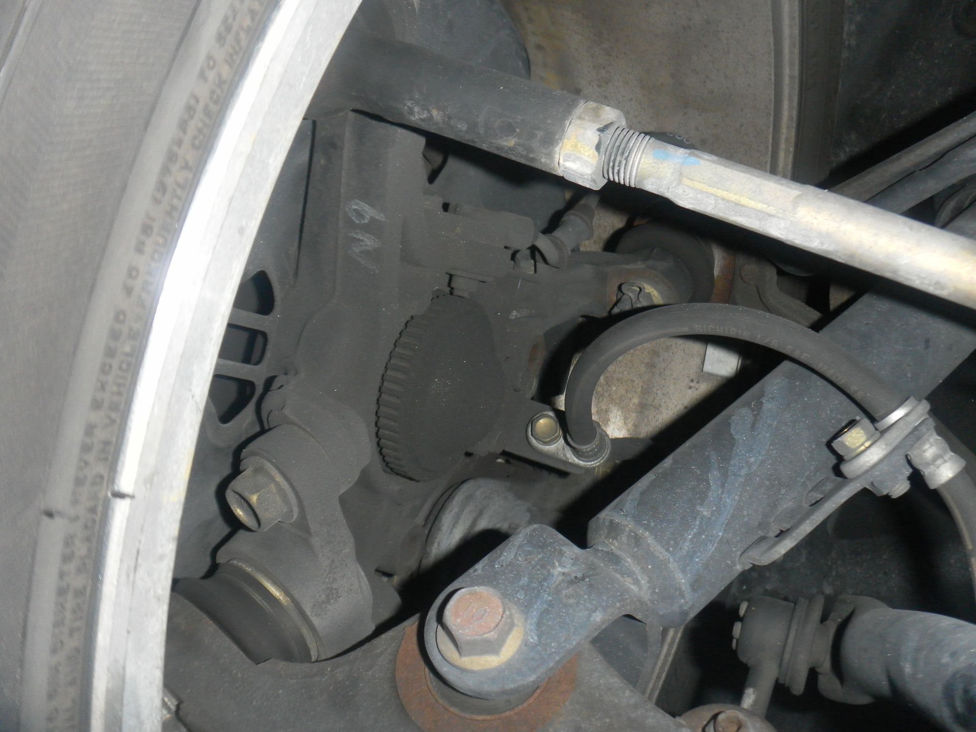

Bit of new information. There is no fluid coming out when hardline to flex connection loosened.
Also noticed evidence of some leakage on back of passenger side, none on drivers side (no significant rust either).
See attached images.
Not getting an ABS or fault light. Wonder if the wheel sensor is indicating passenger front is in a skid. Didn't notice any modulation when braking, but didn't try to skid.

If the sensor were indicating the wheel was locked all the time I would expect you to notice either an ABS light (aka abs code present) or the abs trying to engage constantly when braking.
Curious if you disconect that hard line from the ABS module, if you see any fluid coming out when pressing the pedal. Do this with the engine/ignition off so ABS module should basically be allowing fluid to pass through it. Be careful as brake fluid eats paint like crazy, so you will really want to have a way to catch it and not make a huge mess.
You could use a brake master cylinder bleed kit which are cheap. You could remove the hard line, and add one of the adaptors and run a hose into a bottle so you dont spray fluid everywhere when testing it.
https://www.oreillyauto.com/detail/c...der/mtm0/14151
Put some fluid in the bottle/jar and submerge the test hose in it too, so if the ABS module is not the issue you at least are not sucking even more air into it testing and making way more bleeding work for yourself later.
