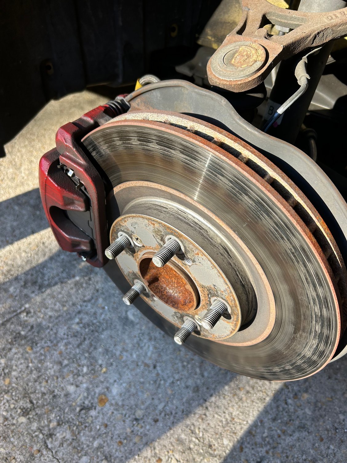

Brakes seem to handle the heat well enough, I would like to add ducting. Another one of my analysis paralysisessss

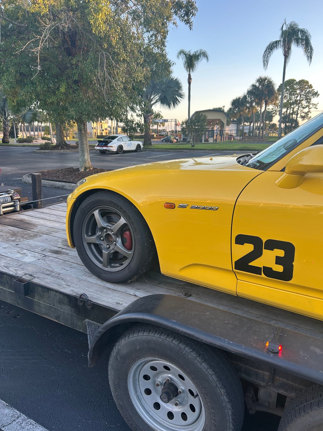

Don’t know if it’s my fat tires or if my spring sag a little, I can’t imagine running this car on the streets where I live any lower. This is with about 2.5* of negative camber

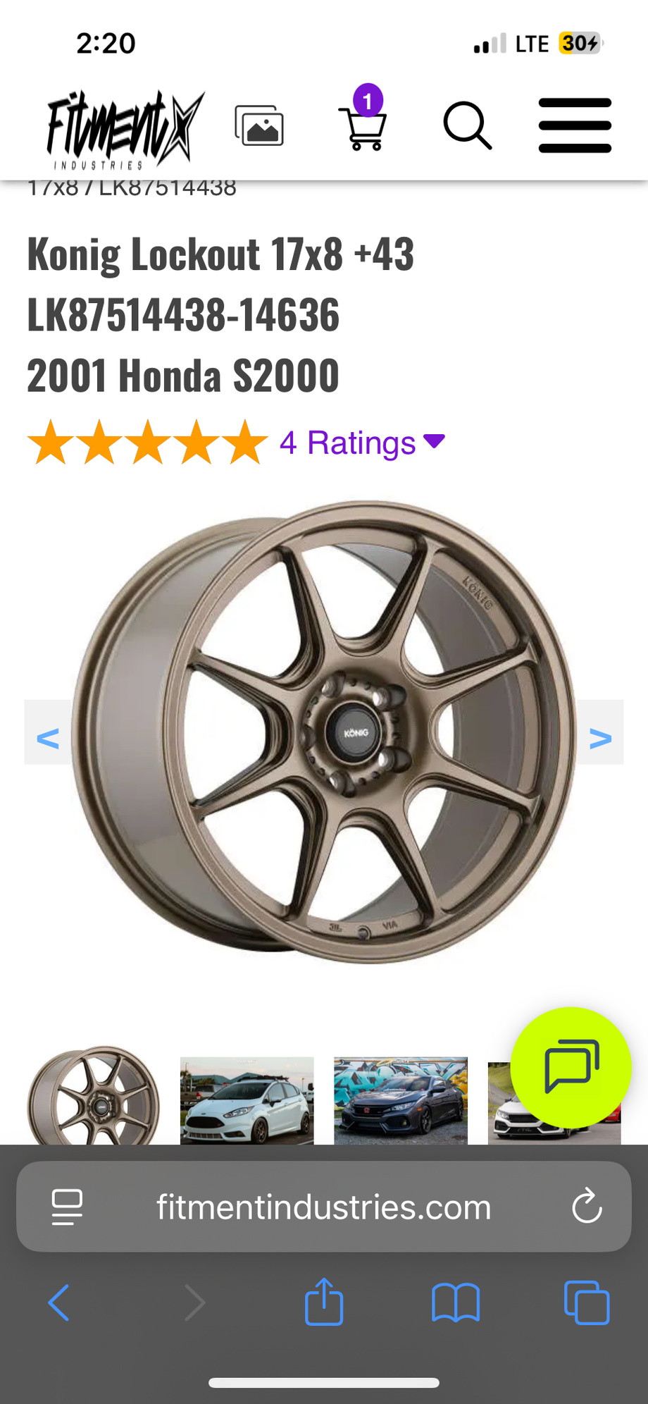

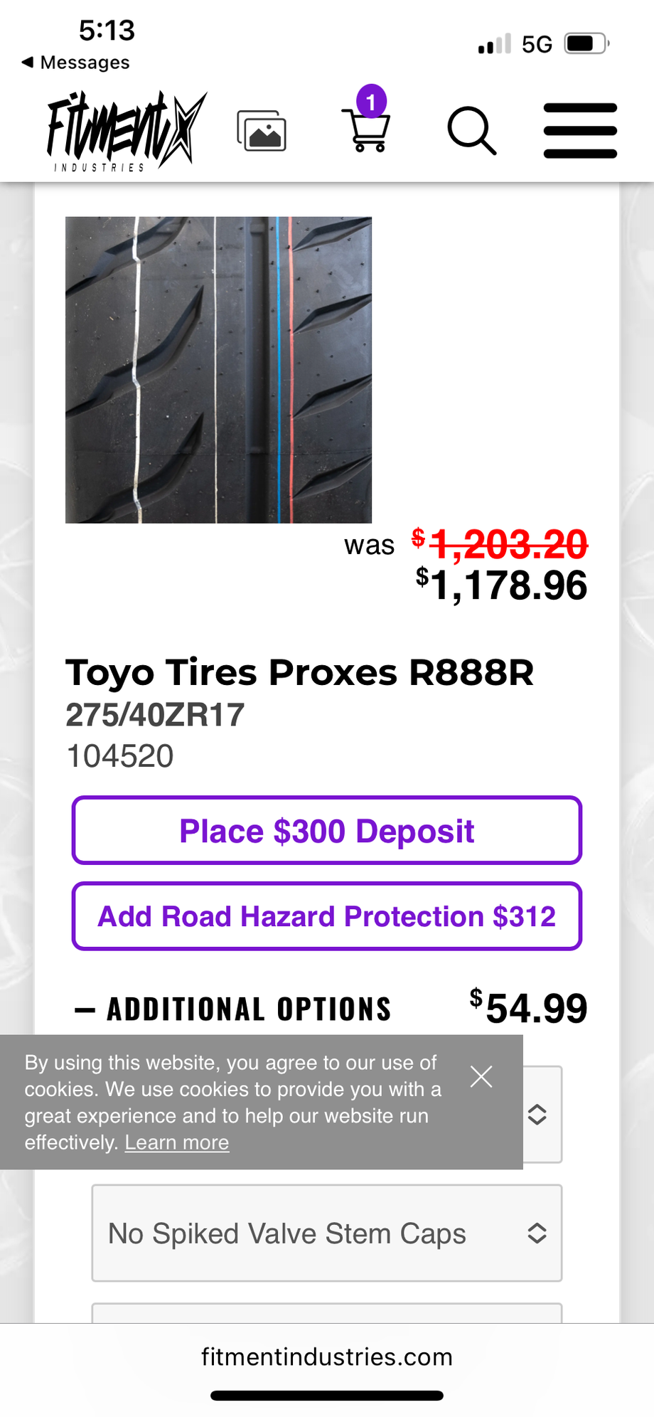

had these in my cart for Black Friday, then my son wrecked his truck. Glad he’s ok but he F’d my plans.
This is white wheel direction I’d like to go
This is the wheel direction I’d like to go
And the slightly more aggressive 100tw r888

offsets are too high. Need to keep your offsets at +45 to +55. that's the sweet spot, unless you're looking to really mangle up your fenders with some heavy rolling and pulling.
Toyo R888R are garbage tires. pretty much every single 200TW tire released in the last 5yrs is better than any 100TW currently on the market. Tire diameter on the 275/40r17 is massive and will make an already long geared AP1 feel even more sluggish - 275 is also super super pinched on a 9" wheel. I'd keep it to 255/40 for 17s. There aren't really any good options in 17s wider than 255. Need to setup up to 18" wheels if you want a good selection of tires wider than 255 with the correct rolling diameter. As far as compounds - all of these are better options - V730 / CR-S / RE-71RS / RT660+. Don't get the R888r

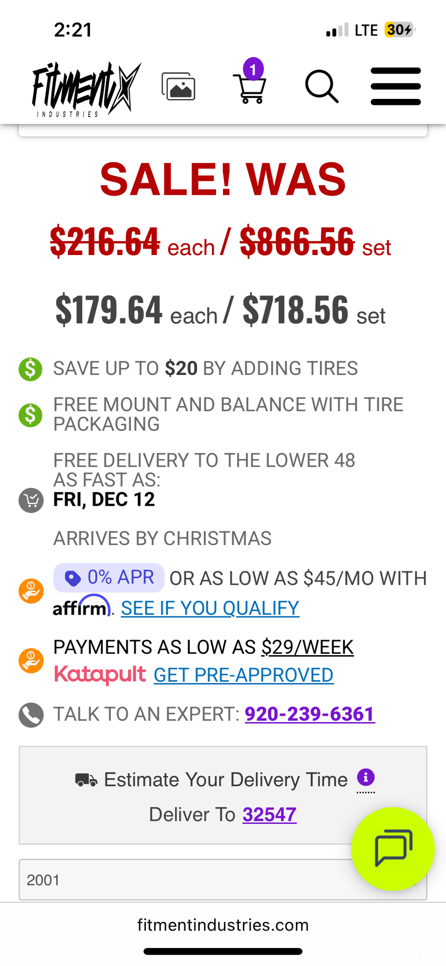

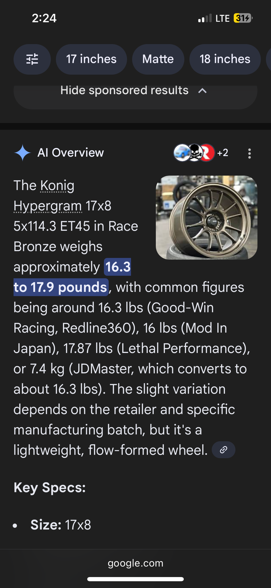

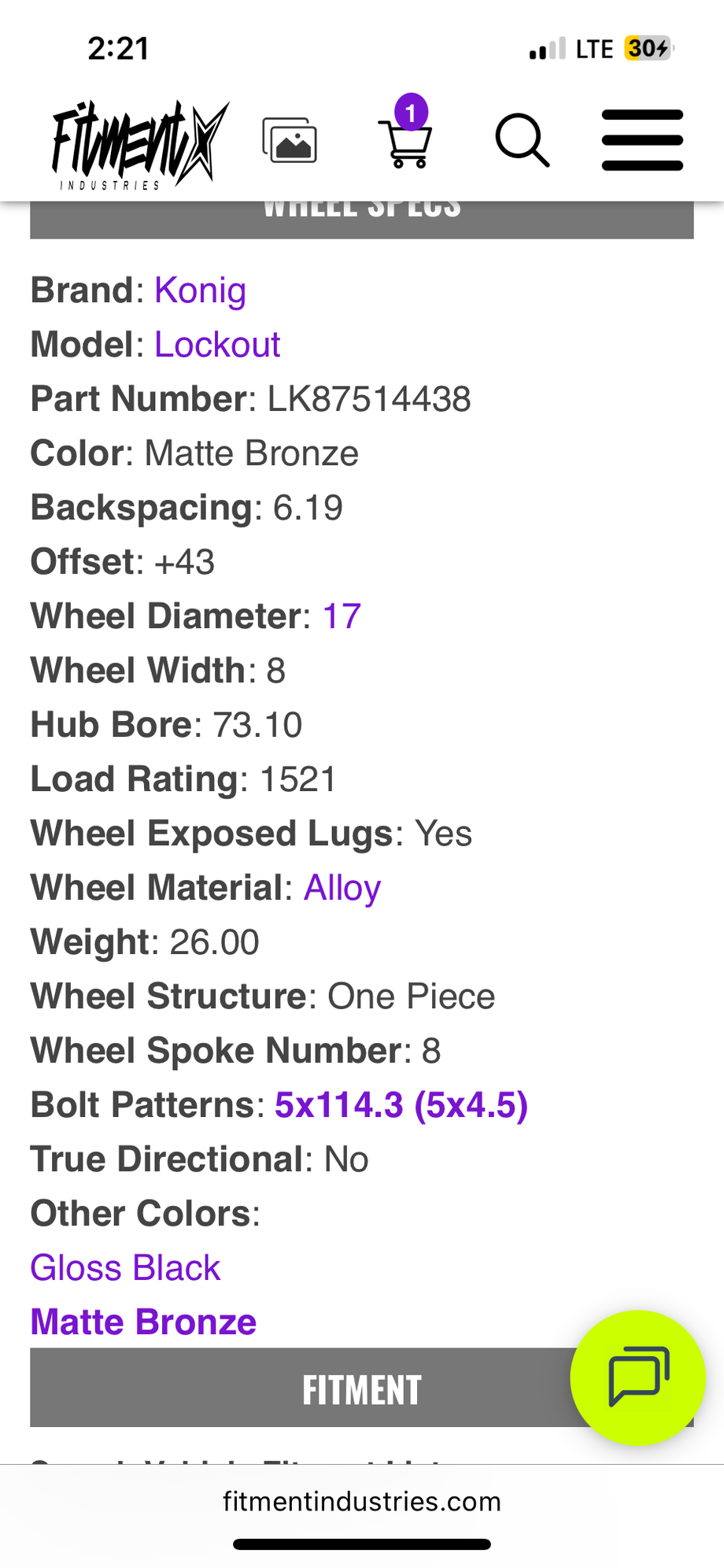

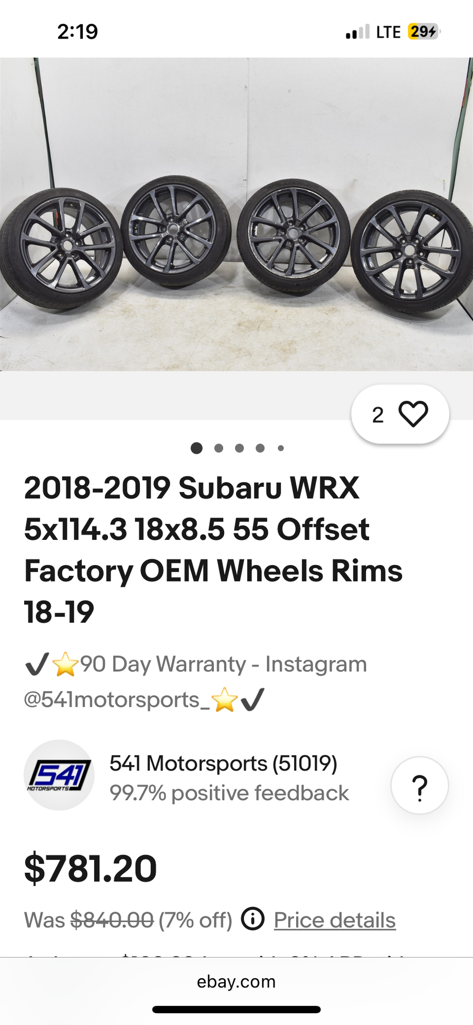

I’d love to just square up on a set of Spoon wheels. I love the color, they are forged and light weight. They just cost $5k for a set. TE37 are also great, albeit a little played out, but also expensive. Here are a couple alternatives;
If I was going to run 18s I’d like to start with something like this to get a feel for it. Although I’d rather pay $500 for heavy wheels with curb rash
These are cheap but kind of heavy…
…and these are cheap and light so maybe kind of weak.

If you want to run a square setup I don’t see any benefit to a wheel less than 9” wide unless there’s a class specific rules reason and you’re extremely focused on that.

You don't need to spend a ton of money on wheels. But inexpensive wheels in 17x9 really limits your offset options. 17x9+40 is fine...but you will need to mod the fenders. 18" wheels would open up some more reasonable offsets at wider widths. 9.5 to 10 is the sweet spot for rim widths on a stock-ish power S2000. If you don't want to mod your fenders, and you want inexpensive wheels, you're adding too much complexity to the equation.
I'd stick with a 200TW tire. Bridgestone just came out with a new version of the RE71. I can't remember what its called. But worth looking into.
