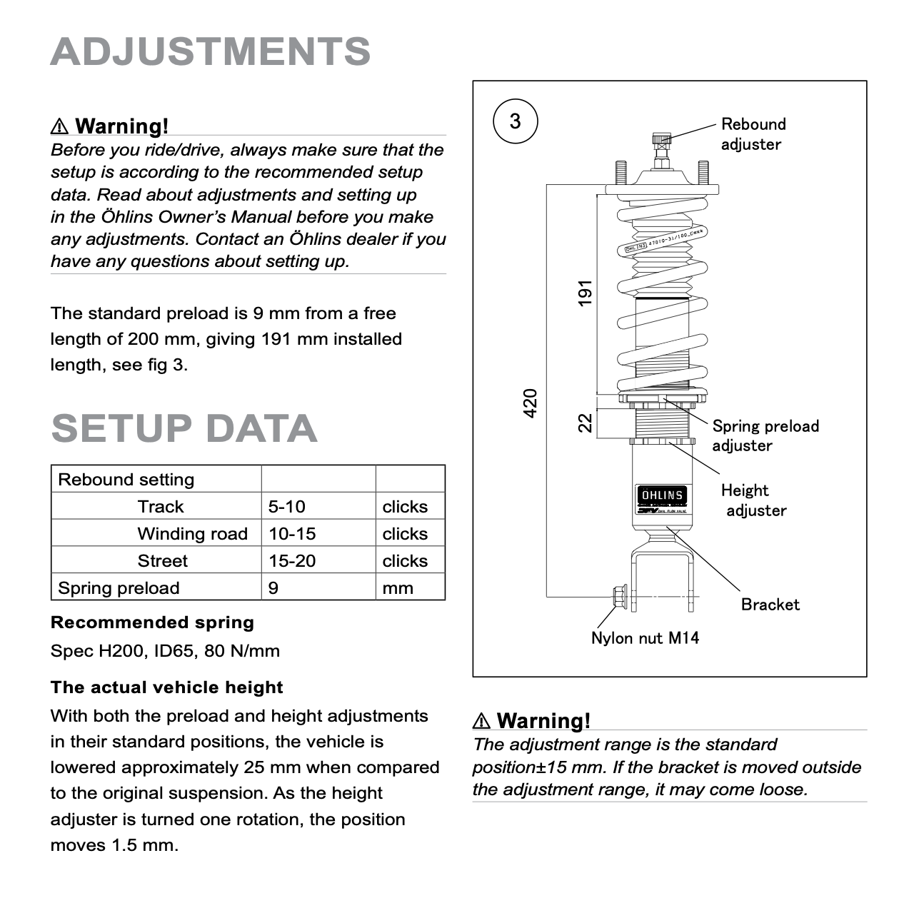

I want to add more details on the length of the OEM shock as a reference for you guys when doing a custom coilover.
The OEM shock length Front is 560mm; Rear is 440mm; Travel for front and rear should be about 63.5mm
This is the reference from Ohlins DFV.
This is the reference from Ohlins DFV. the length of I am talking about is this 420mm place

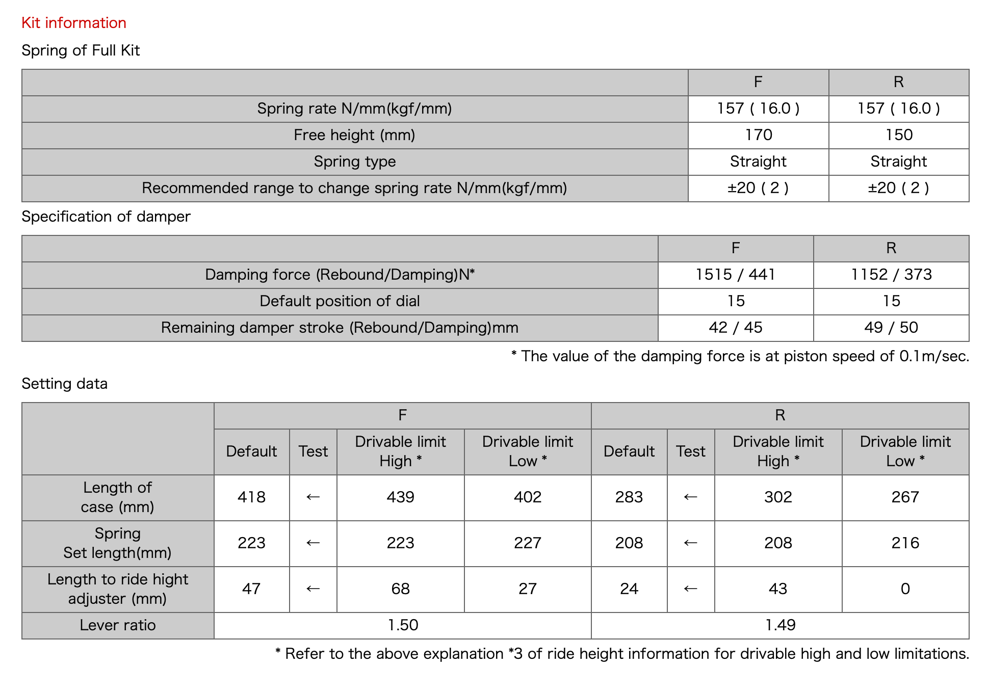

Motion Ratio reference from HKS HiperMax R

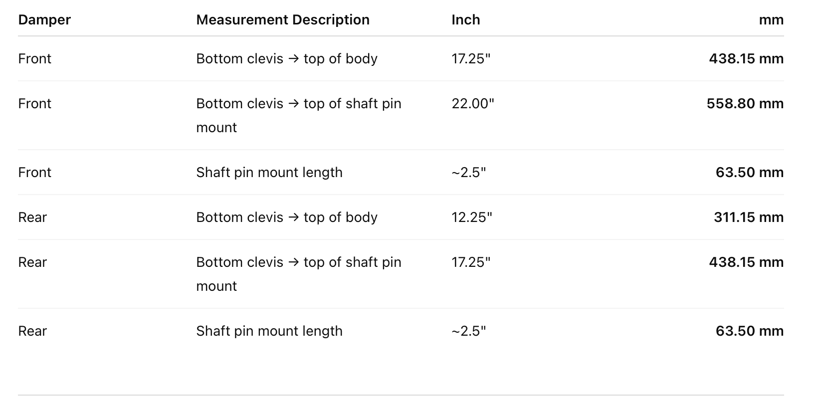

here is some data I found from the s2ki forum and convert it into the metric unit.

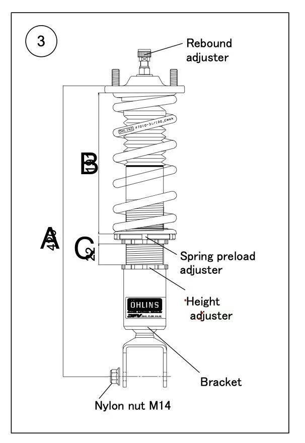

The full length I am referring to is the distance from the top hat surface, where the contact with the car body occurs, to the middle point of the clevis bolt.
the full length is A
The full length is A
The OEM shock's full length:
Front 560mm and Rear 440mm
The PSI TTX that I saw:
Front 530mm and Rear 410mm
The Default Nitron R3 with the 30mm thread in the clevis :
Front 545mm and Rear 410mm
After I specifically asked for four 10mm longer clevises, which means adding 10mm to the bump stop :
Front 555mm and Rear 420mm
Why should we get the same length as the OEM shock?

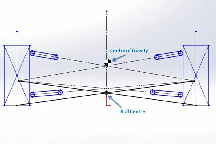

Because the suspension geometry is designed to use the OEM shock's length, I understand that people will say the car should be lowered to lower the center of gravity for better handling; however, that is not how it works. The better way to say it is to align the roll center with the center of gravity. Which means reducing the distance between the roll center and the COG by applying the Roll center correction ball joints. That will automatically lower the car's ride height.

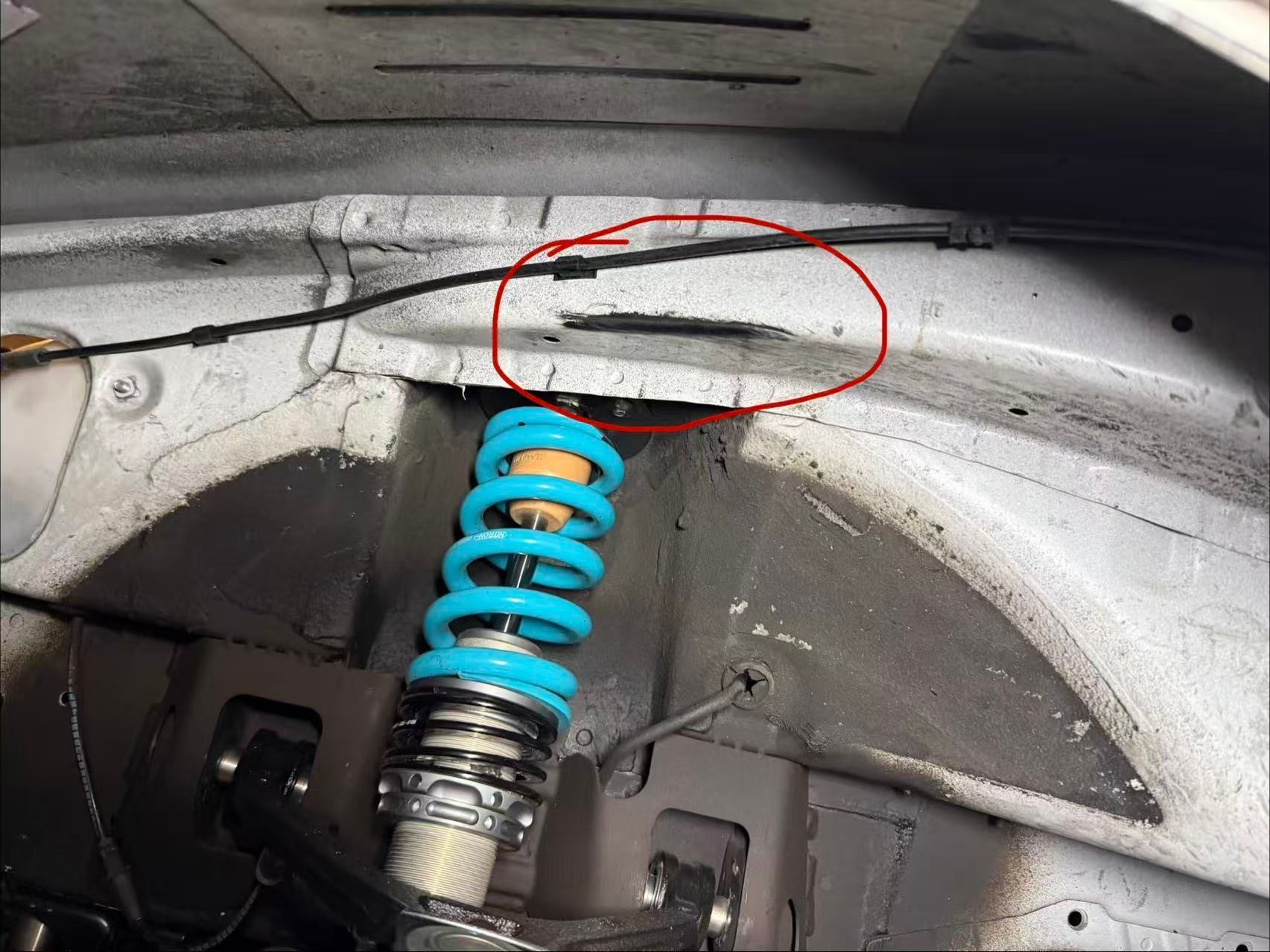

This is the part I am talking about on the front of the frame, contacting the tire during high-speed cornering. That is why the right bump stop length is essential.

It's not a coilover issue. It's a wheel and tire issue - too wide with too high of an offset. Get a narrower wheel/tire and a lower offset. Roll/pull your fenders more if you want a wider wheel/tire. Pick where you want to have contact issues, the outer fender or the top of the wheel well.

In Fact, for the aftermarket wheels with aggressive width and high offset, and wider tires. It is very common to see those issues. After I have increased the 10mm clevis and resprayed the scratch area. It is still scratching on the Laguna Seca when using the Apex wheel with 17x10J+48 with Hoosier TAP 245 tires. Yes, I have the steering rack limiter to reduce the lock-to-lock steering.
If it really cares, do not scratch that area. It is better go for the OEM ride height. Either by longer the cleivs or thicker the tophat.
