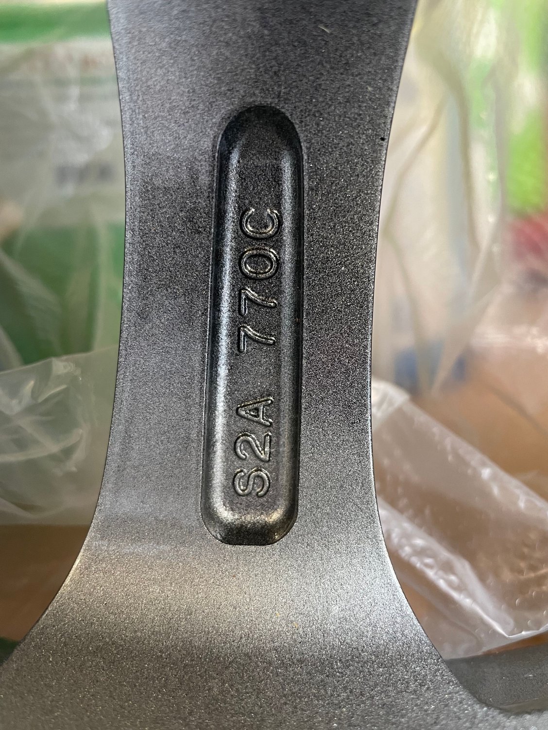

BTW I have an AP2V2 front wheel sitting in my shed marked S2A 770C (Charlie vs Delta). Don't worry I didn't pull a wheel it's a spare from when I thought I damaged a wheel.

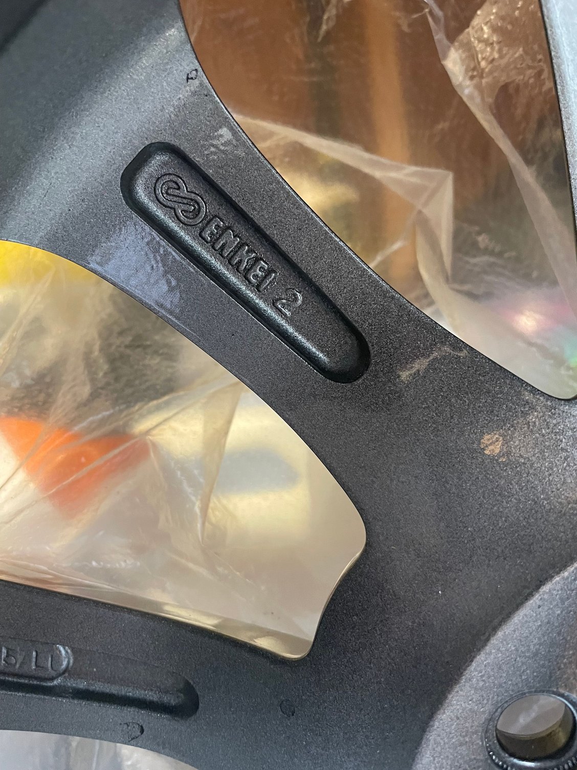

Sources for the 2008+ wheels shows HITACHI as the OEM -- any manufacturer listed? My 2006 wheels are made by Enkei. Maker listed for yours? Yeah ya gotta pull one.

Thanks for posting! The front wheels show 770x consistently (no surprise).
S2A 770C -- AP2V2 (Chuck's 2006 wheel)
S2A 770D -- AP2V3 (HondaTN)
S2A 770E -- CR (Apinecone's wheel)
H404 on the inside of the CR wheel indicates HITACHI? This mark on the AP2V3? Since these marks are in the casting die there's evidence that the AP2V3 and CR wheels are different (D vs E) other than just color or at least made on different dies. My 2006 wheels are made by Enkei.

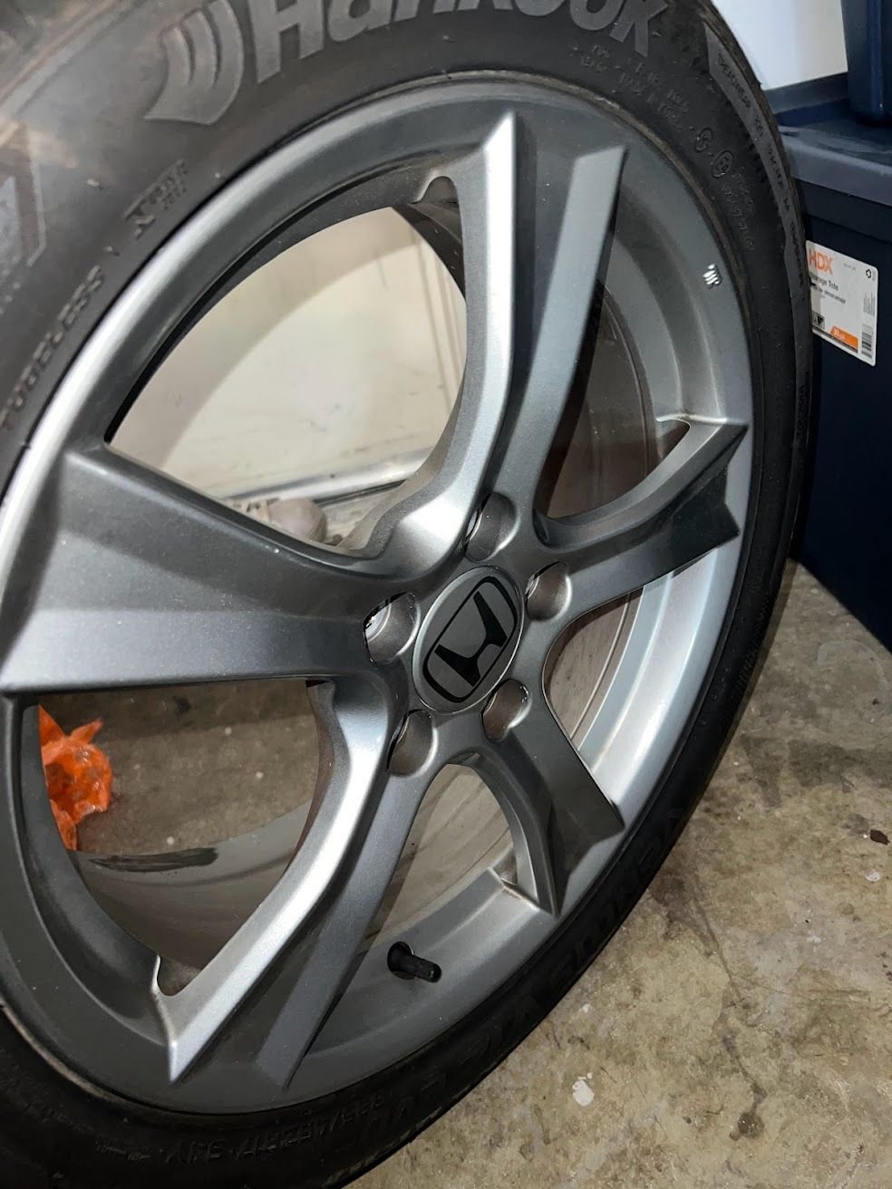

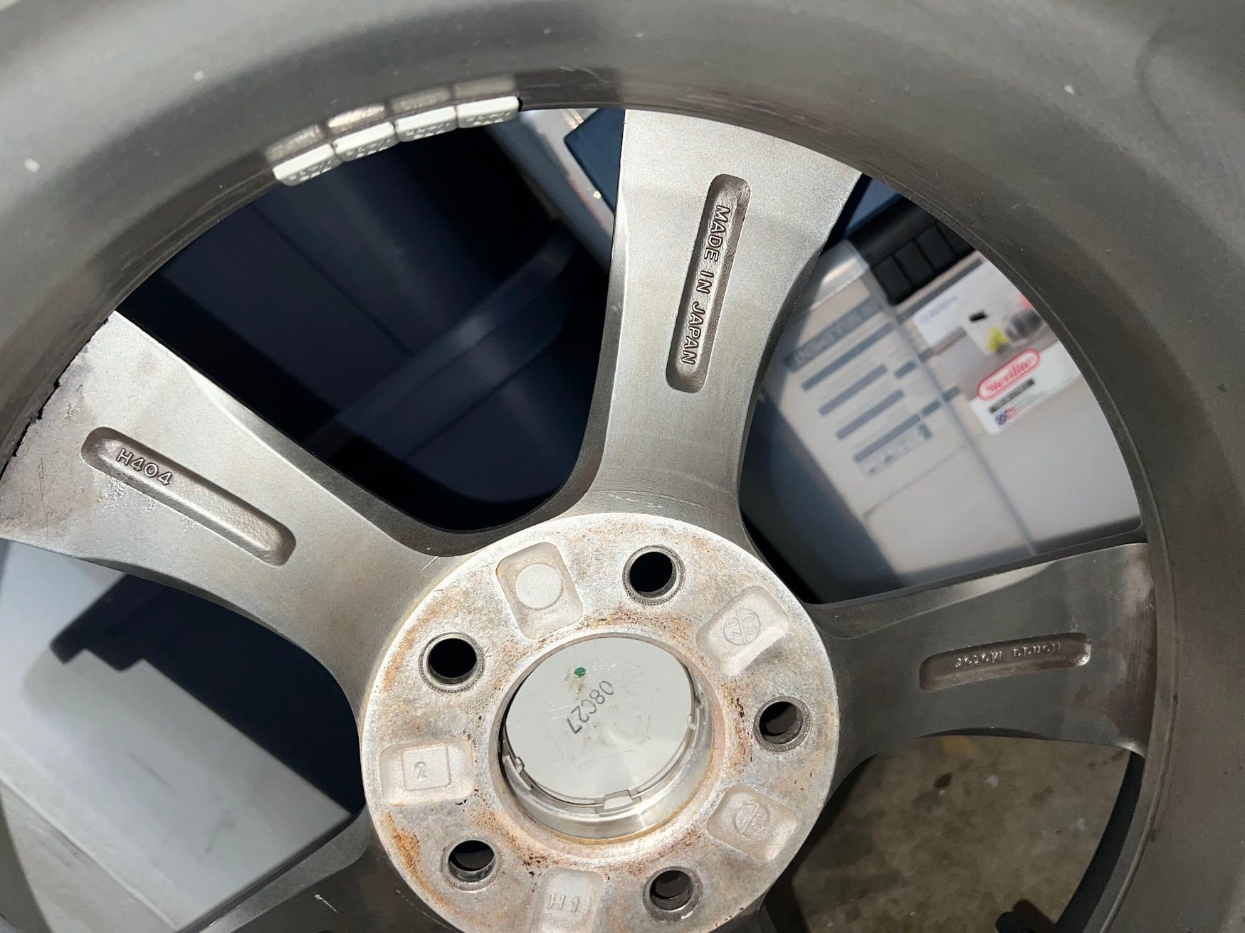

My MY08 (EU version) came from the factory on normal silver V3 wheels. The cast markings on these wheels were S2A 770E (front) and S2A 785E (rear).
I had also bought completely new original Honda V3CR wheels (kaiser silver) and these had the following cast markings S2A 770D (front) and S2A 785D (rear).
As this is in contradiction to what was reported here so far, my assumption would be that the cast markings do not indicate the difference between regular and CR V3 wheels. I would also not expect that the wheel itself (from cast and structure) is different and only the finishing differs. The cast markings might reflect different manufacturing lots.
