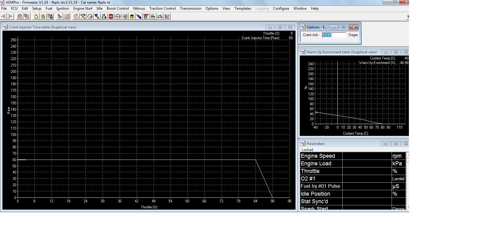

DiegoB16 Mar 24, 2017 02:58 PM
Follow the adjusts below:
https://cimg1.ibsrv.net/gimg/www.s2k...6833abc9e9.jpg
https://cimg3.ibsrv.net/gimg/www.s2k...5b9a3be89b.jpg
markforrester99 Mar 25, 2017 12:36 AM
What about the idle section. What do you have your target idle speeds set as? It might be worth adding some more RPM when cold so the idle is abit stronger while it warms up
