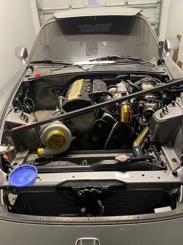

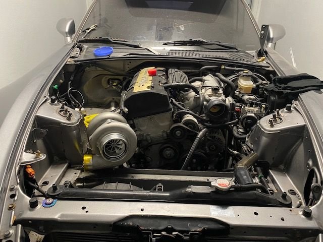

Hello everyone, wanted to document and post my current turbo build. The main components of the build will the pulsar GTX3582r turbo, Koyo rad/intercooler for cooling, my custom v-band turbo manifold and alot of titanium parts. Official parts list will be up soon... I will try my best to upload weekly and keep the thread interesting. Also there will be quite a bit of fabrication so ask any questions you might have. Overall goal is 700 on pump E85 fuel
Here are some progress photos
Pulsar GTX3582r
62mm turbo
Stainless 1.03 hotside

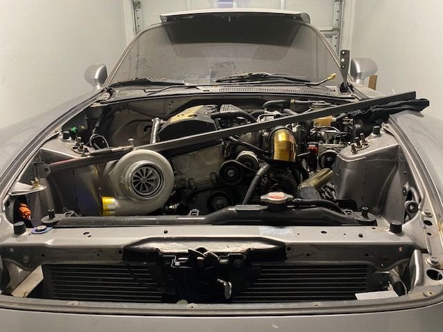

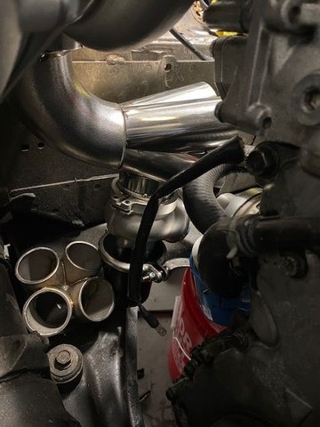

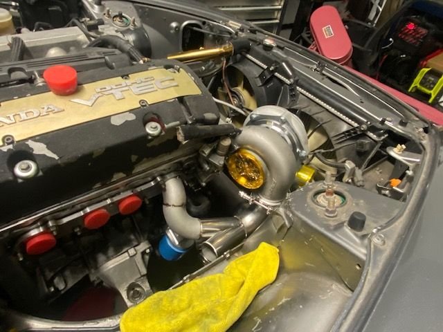

Here some shots trying to figure out best turbo placement ended up going with the sidewinder style
Mounted the turbo and its being held by on runner

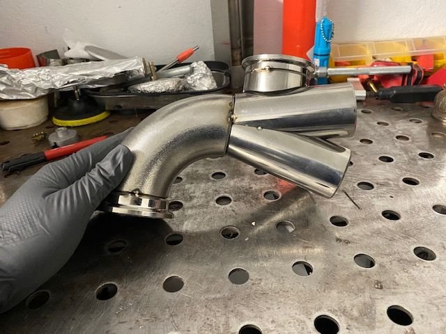

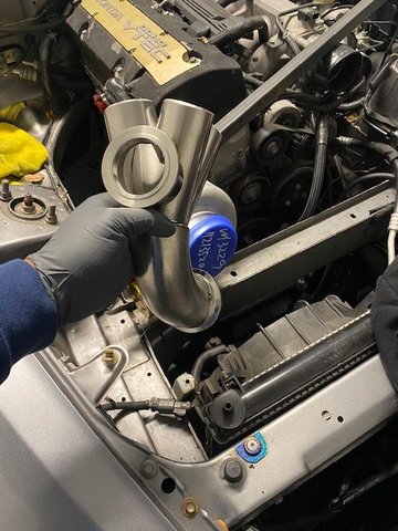

Collector and vband elbow

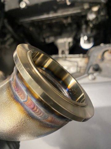

Started to do some welding turbo flange to elbow

Looks really nice. Curious to see how that open 1.03 housing responds. Wondering if it'll be a little lazy spooling up or not.

Curious as well, went with the larger back housing to make 700 without having to upgrade to a bigger turbo.

here's a test pass on another collector
can you still say "taste the rainbow" or is the new gen to sensitive lol
