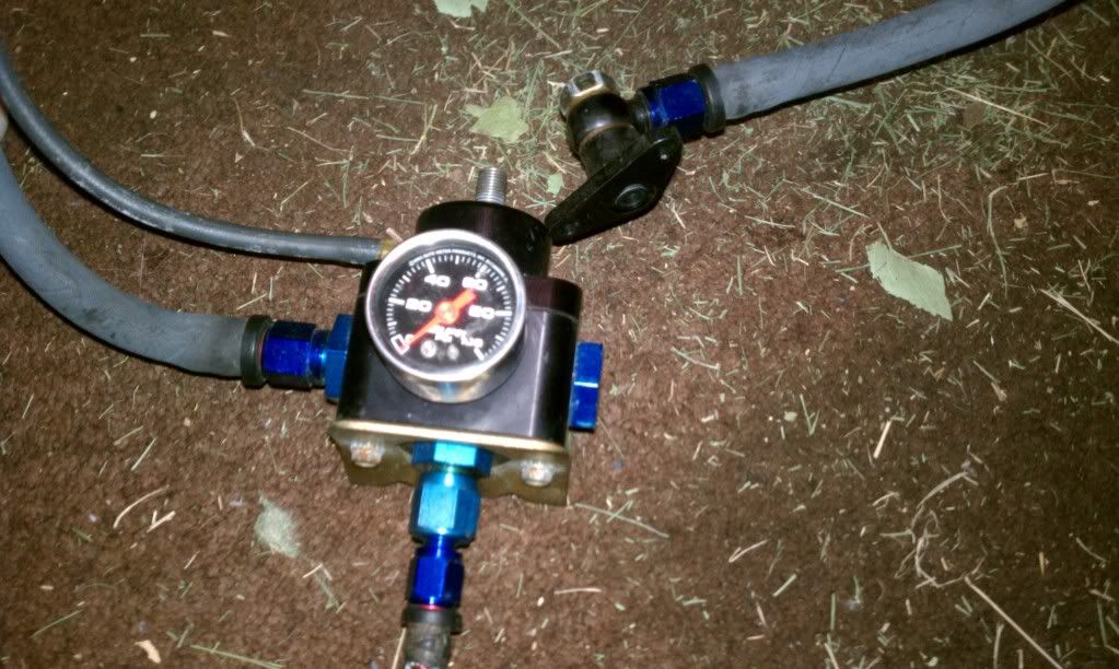

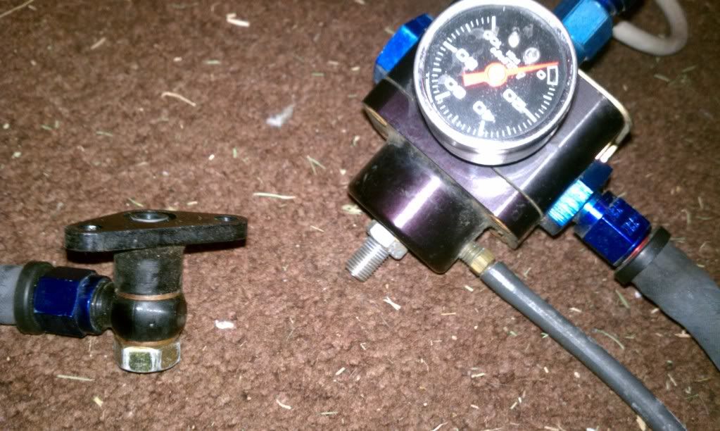

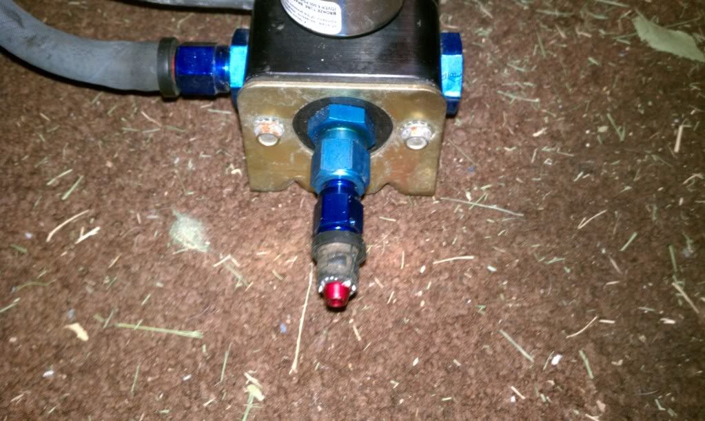

s2kbtos Oct 8, 2012 08:03 PM
Photobucket
Photobucket
Photobucket

s2kbtos Oct 8, 2012 08:09 PM
i dont have any other piggybacks besides the esm that comnes with the comptech. i'm only going to be pushing the stock lbs of the kit.
Will the fuel pressure regulator above work with the base kit setup ?
s2000Junky Oct 9, 2012 09:34 AM
I see what looks like a similar spring pre load adjustment like the one comptech offers, and a vac source so it could very possibly be a rising rate. Looks like one to me. However, If it is, we cant tell what the ramp up rate is, and if that’s going to be compatible for your boost delivery. All you can do is install it and do a couple trials and see if you can get some proper fuel enrichment throughout the rpm range. Be careful though. Hope you have a wideband to check your afr.
Threading that adjuster down increases fuel pressure by the way, if its showing too lean. There is adjustment. Backing it out does the opposite obviously. Stock idle idle pressure is 43.5, but Comptech calls for a start place of around 50 if I remember, but this is rather arbitrary, what matters is your afr through boost. The stock ecu will correct for any reasonable idle pressure. Hope this helps you somewhat.
