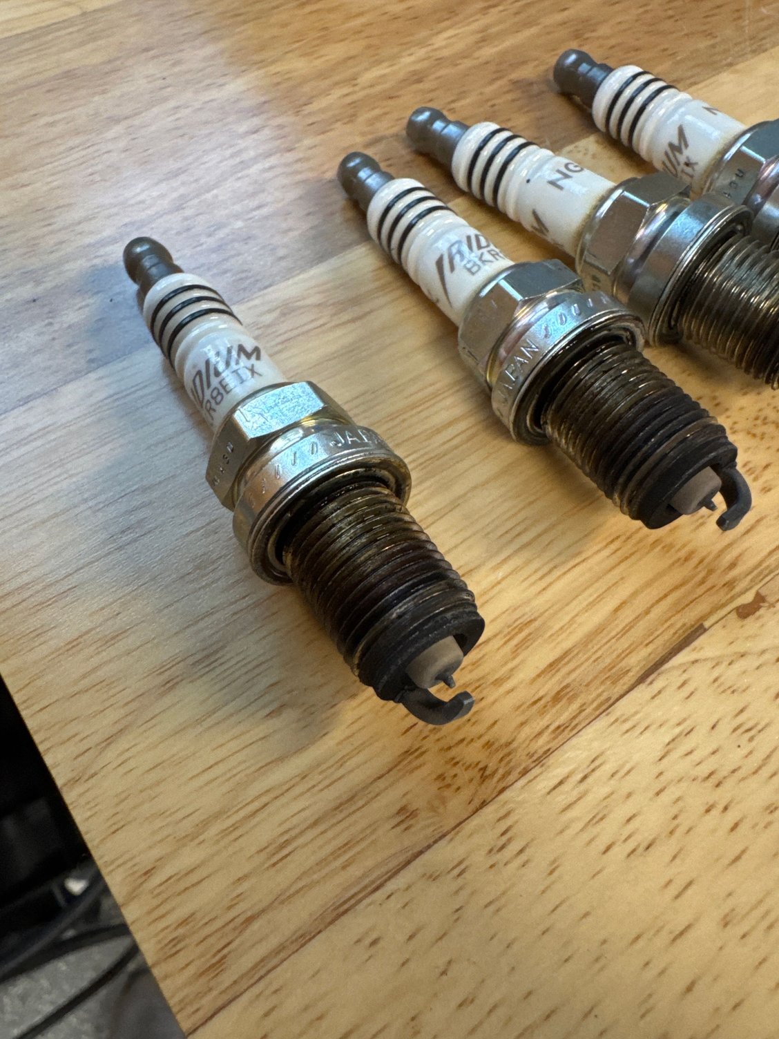

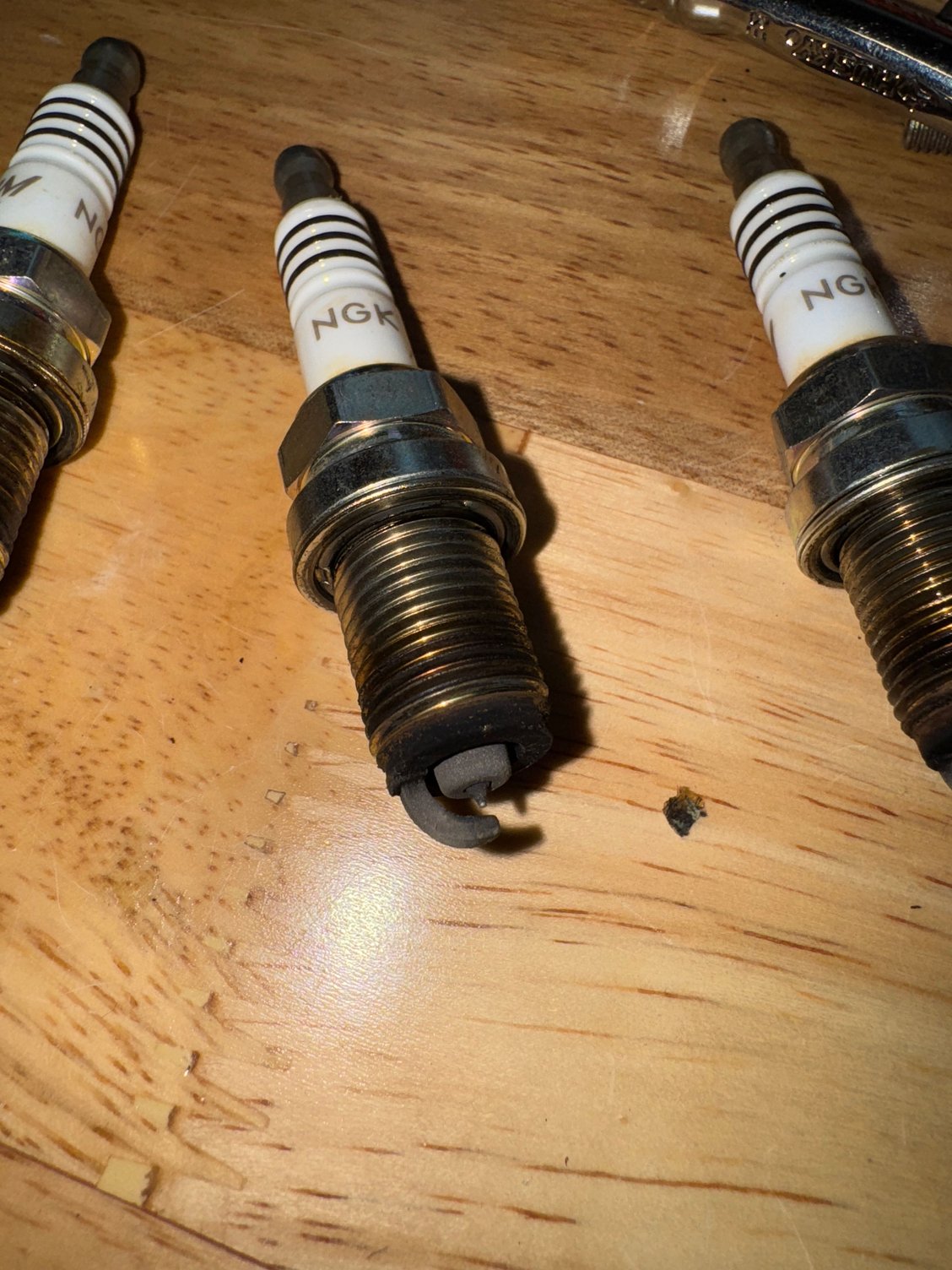

Car breaks up a bit around 5k rpm with around 50-75% throttle and it seems more common when it’s hot out (it was cooler out the other day and it maybe did it once). Not sure if it’s the tune or not.
Car was dyno tuned on a v2 Hondata kpro in 2011 (I just obtained the car). All I did was enable the AC Pin out and convert the old file to the new Hondata software version. Can the AC cause this?
plugs were gapped at .032. Gapped them at .030 with no change
