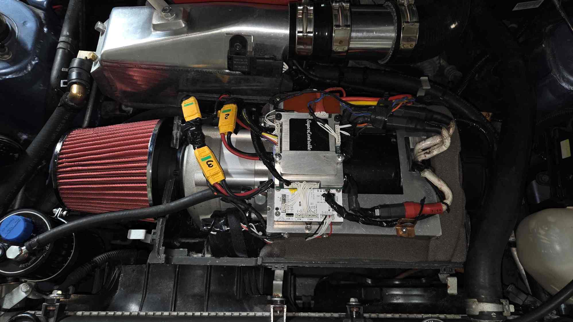

I have designed an electric supercharger consisting of a Rotrex C30 driven by a 14HP electric motor. The blower and motor are installed inside a stock air box. Seemed like a fun and different project a year ago when I started. It uses a VESC speed controller with an Arduino controlling the boost. My goal is a flat 6psi boost curve from 4k rpm to redline. My bench testing shows it should work. I managed to fit a water to air intercooler between the air box and front of the engine. There is an 80V LTO battery in the trunk. There are more details on Youtube. For my first test drives, I turned the boost down to 2psi (using the Arduino controller), and I'm running straight 100 octane Sunoco unleaded, for now. The A/F is running around 12.0. I have an FMU for fuel and the MAP sensor is clamped, so I'm trying to use the stock ECU. One of the advantages of this setup is it leaves the car almost complete stock - fairly easy bolt on stuff. The blower seems to work fine. But the ECU is apparently going berzerk when the electric motor starts. At 6k rpm in 3rd gear, the timing is reported to be about 24 degrees with the motor off, but it drops to around 8 degrees when I switch on the supercharger. The clamped MAP sensor is reporting +1 psi of boost with the blower on, and about -1psi with it off. There is no bypass valve so the blower is a restriction when not running. Obviously, the massive timing reduction is killing power. All I can think of is the knock sensor is confusing the supercharger noise with knock and killing the timing. I've heard the AP1 knock control is very basic and sensitive.
Anybody have any thoughts or suggestions?

I found the problem. It was not the knock sensor. When I disconnected it, I got a CEL and the ecu pulled about 8 deg of timing (with or without the blower running). Then when the blower was enabled, timing dropped another 14 deg or so. So now the ECU is pulling timing for 2 reasons. I hooked the knock sensor back up, then changed the MAP clamp from 3.1V to 2.9V, and the timing problem went away. I read somewhere 3.1V was the correct number, but it's too high. I'm using a very precise clamp. I'm surprised the ECU pulled all that timing because of a high MAP sensor voltage and didn't throw a code. The MAP sensor is now reporting 14.5 psia under boost (I'm at sea level in Florida). The boost is running about 2psi from 4000 to 8000 rpm, which is as high as I have run it so far. The FMU quit working, so I'm not going to 6psi of boost until that is straightened out. I have a little extra fuel because I faked the ECT sensor into thinking the car was running a little warm, which gives about 10% more fuel and pulls a couple of degrees of timing. The ECT tweek is active only when the blower is making boost.
My early impressions of an electric blower on an s2000 are all positive so far: 1) I was worried about how it may sound, as unlike an engine driven centrifugal, this one runs at pretty much constant speed as engine rpm rises. I had to have ear protection when I was bench testing it. But in the car I could barely hear it. Intake and exhaust noise completely dominate blower noise at 2psi. 2) For only 2psi, the car feels stronger than I expected. The mid range pull through VTEC feels really good. The engine doesn't drive the blower, so there is some extra crankshaft power. 3) unlike a normal supercharger, this one is not turning until needed, so it takes a little time to spool. I didn't feel or hear the blower turning on, it was very normal. With more boost, it may be more noticeable. The turn-on can be tuned in software. 3) I drove around for about 20 minutes and did maybe 20 pulls of 2 or 3 seconds each. Typically in 3rd gear from 4500 to 7500 rpm or so. The 84V battery voltage didn't move at all. The charger runs all the time and kept up with the power drain from the small pulls. The battery can run down to as low as about 74V. 4) I saw about -2psi of boost at high rpm's with the blower off. I'm thinking this is probably ok and I won't need a bypass valve. There will hopefully be enough battery capacity so that running without boost will be rare, and -2 psi should be ok occasionally. 5) IAT barely moved during boost although its only 2psi. My gauge runs on its own sensor before the TB that shouldn't heat soak as bad as the stock one.
I would appreciate your comments and suggestions. I don't know of anyone else running this configuration, so this is all new to me.
