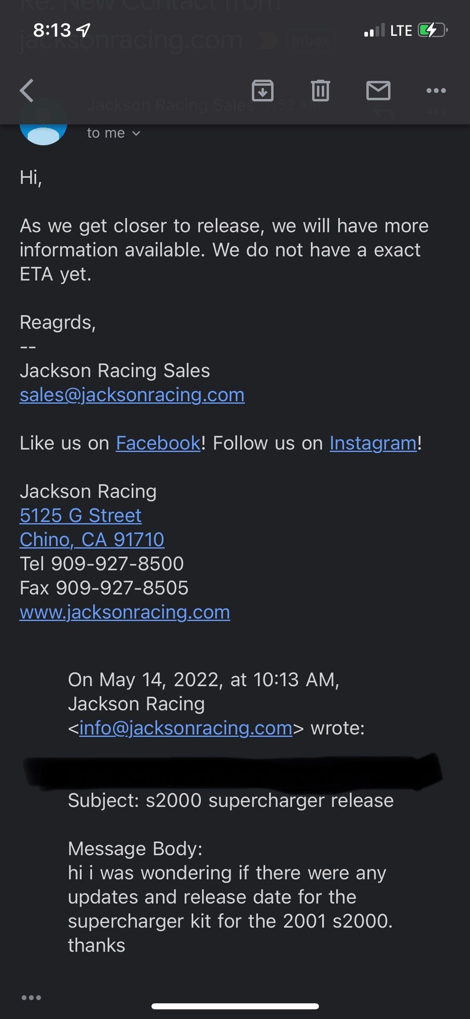

Just throwing this out there if anybody is still interested
