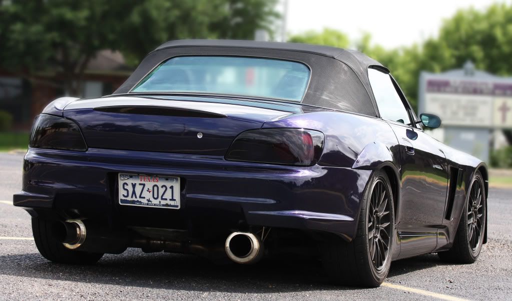

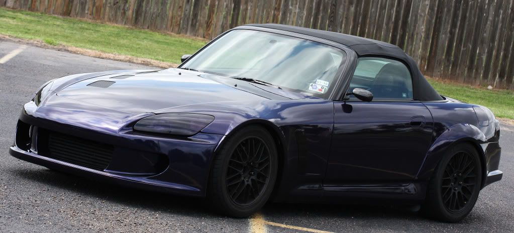

Car in question so this isn't a boring post.
