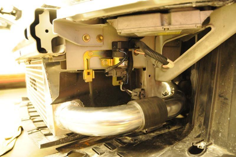

Here are some pictures. I will post up more details as this project gets wrapped up. They will actually be removing all the parts soon to take some detail pictures once they have everything perfectly mounted in my car.
Pictures:
Before ceramic coating
Ceramic coating done, and painted flat black
Install phase 1 - Test fit manifold and DP
Install phase 2 - Test fit Intercooler core. The piping on the intercooler are welded to the end tanks.

Very nice man and very clean! That turbo placement looks much like mine. I love the catch can too. Where did you get it and what was removed to make it fit? I dont see the throttle cable that loops around that area anymore. Did you rearrange it?
