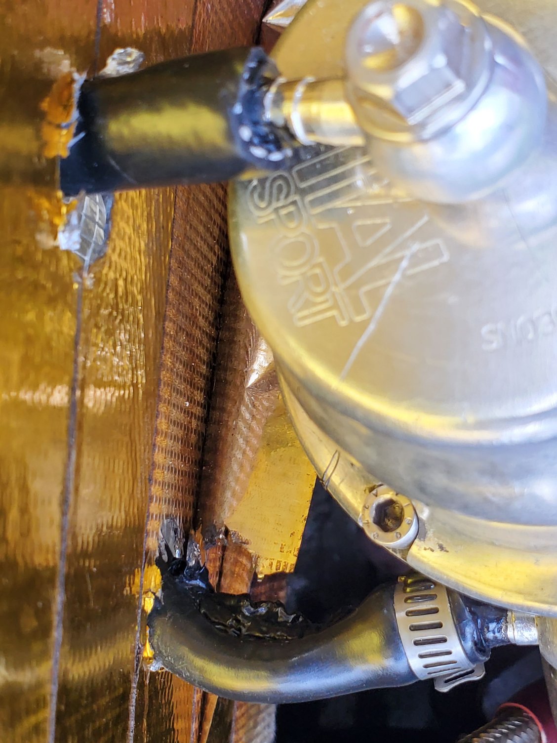

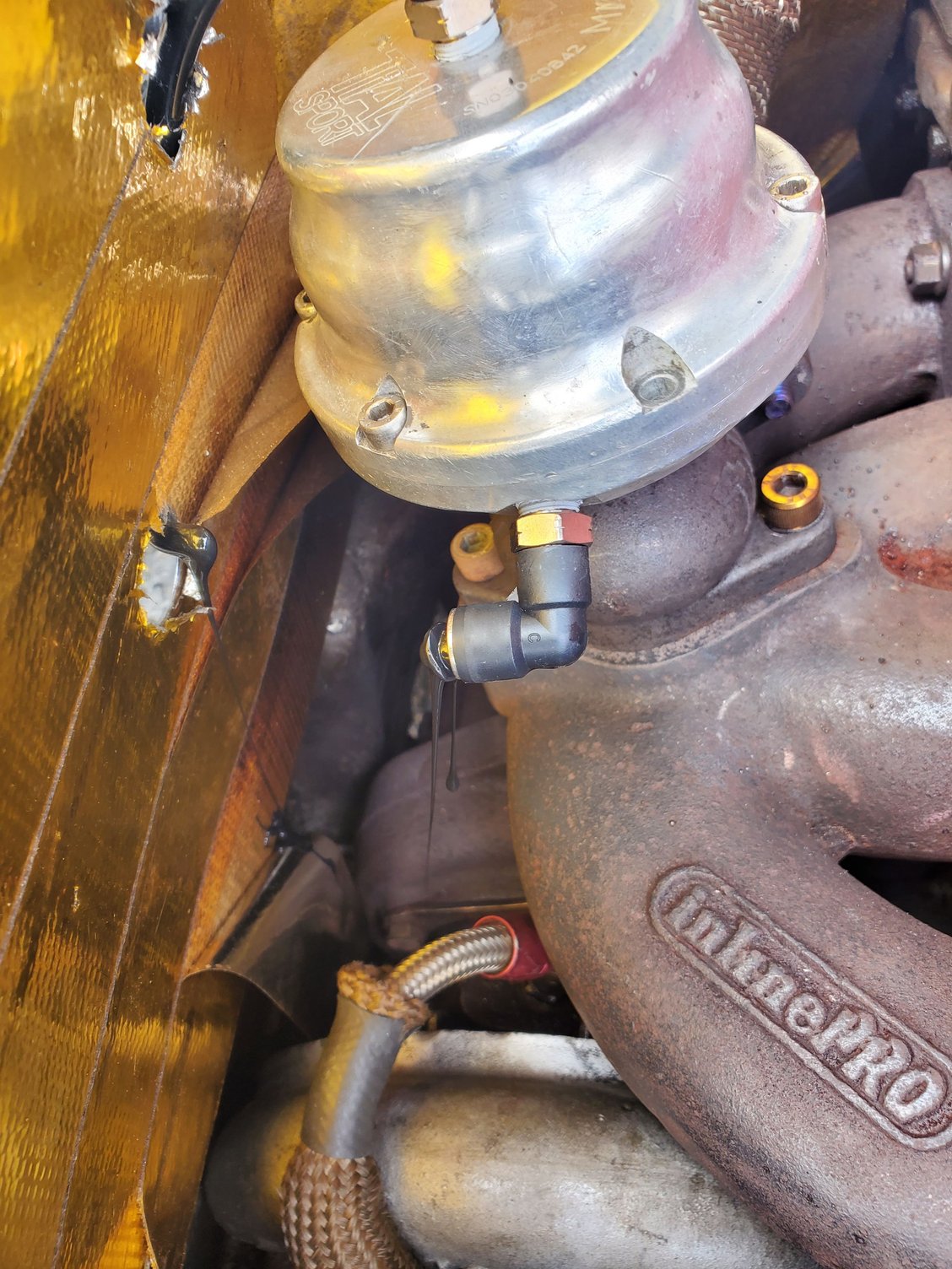

first session was semi-dry, getting a feel if i corrected the car trying to kill me the second i fed it any throttle in a high speed corner, feeling out where there was grip, shaking the car down basically. got a sight lap at moderate pace and felt good grip wise, all weird issues with throttle application seem to have been corrected so i decide to go for a 80-85% lap and almost instantly hit boost cut. pull in and i super melted all the push to lock lines and fittings. I had a few people tell me they thought those might fail and so just incase i brought my banjo fittings and a few barbs. run to ace hardware in town grab a couple more barb fittings and a tee fitting along with the best hose they had which was some fuel line. get it all fixed.

3rd session: i go out and even on my out lap the car is feeling very sluggish, getting louder and louder. half way threw the lap its no longer making boost, pull into the pit from my outlap not even completing one lap. turbo was hanging one by about 3 threads on one bolt. the other 3 are lost to the track somewhere. me and my buddie i had come crew for me and a buddy that was crewing for a team mate and i all jumped into it immediately. randy my crew guy called his wife to run in a tool i needed from and hour away to get it done. while we wrenched and randys wife was enroute, randy ran to ace and grabbed a pile of bolts. luckily this isnt the first time i have had my turbo almost come off. prior to this event i ordered some rb25dett factory turbo tabs that lock in the turbo hardware i just ran out of time to install prior to the event, but i had them on hand. in record time we reassemble the entire hot side now with locking tabs so the bolts cannot back out and about 30 min to spare before the next race.

Great report! I had an old SR20 back in the day and I swapped on the JDM T25 turbo setup. I forgot to bend up the tabs and I ran into the same turbo hanging by a nut situation. It did take a few years and tons of abuse before it happened though. Considering you're melting vacuum hoses, I'd look into plumbing some cooling air into that area. Also, the wastegate will fail too without cooling, either by air or water if you have one of the water cooled ones.

well season closer in the books and boy what an adventure. first off it was supposed to be dry from friday afternoon through the weekend. it rained friday into the night so am track was wet, but by 8am the sun was shining and in the upper 30s temp wise. by lunch the track had fully dryed and temps into the mid 40s. ok let go do this. do my warm up lap, go to punch it down the back strait so i come into turn 11 at speed and cross start finish as if i was in a run. instantly hits boost cut... no matter what i do boost cut. temps arent much different from last event, and my boost cut is set high enough im not going to get a swing that high. but silly me left the laptop at home. spent 2 hours diagnosing why and came to no conclusions other than just tossing a old ball n spring manual controller on the car, few street rips to dial in boost about where i thought it should be. get to grid early so i can be the first one out with nothing but clear track, it was pretty busy so its an easy way to ensure a couple clean laps. warm up lap feels great, t1 to t3 feels great, exit of t3 i apply throttle and nothing, wtf, i look down, cluster is off, million things going through my mind wtf just happened. i roll off track into a safe spot. turn key off and realize only one click, weird, turn key on and hit the start button and fires right up, guess i bumped the key with my knee during the t3 downshift, doh. well now the cluster of cars is upon me. so i cruise around at a moderate pace for two laps giving myself plenty of space while not pissing off the cars behind me. turbo and wastegate both decide to again come loose. oh boy here we go again.
fix the wastegate and baby the car an hour home. rip it all apart, one bolt is stripped, i helicoil it. reassemble two more bolt holes strip. pull turbo back off manifold and helicoil those two. get it all back together (snapped the helicoil tap had to wait for the am to get another) get back to the track at little after 1pm. my run group is already on track. but good news is there is maybe a 1/3rd of the people as saturday. which means lots of clear track. i unpack the car, do usual pre track checklist, tire pressures, torque lugs check over the turbo stuff from the drive to the track, etc. head out for the first of two sessions left for the weekend. warm up lap feels great, hit the first hotlap, 1:39.6 woohoo, thats over half a second off my pb and achieved my sub 1:40 lap time goal i had set out to achieve two years prior. do a cool down and figure man i know it has ALOT more in it, lets pick two corners to improve on while doing the same lap. ran a 1:38.9 oh shit full second beyond my goal, im stoked. pull off, check everythng. wastegate is starting to come loose but hasnt failed, another hot lap it may have.

So I think i have gotten down to the root of the issue with the bolts backing out, just kinda a brain fart/ oversight. when fitting the turbo to gain a bit more room I had cut the t3 flange down with couple degree slope on the turbine housing, just to kick it a little more under than manifold, I never did cut the matching angle into the bolt seats so they would sit flush. dont mind the washers, that last event i was hustling to get it all back together and had to heli-coil the manifold and the bolts were too long I had on hand. but you can clearly see how the bolt is seated, this is fully torqued.

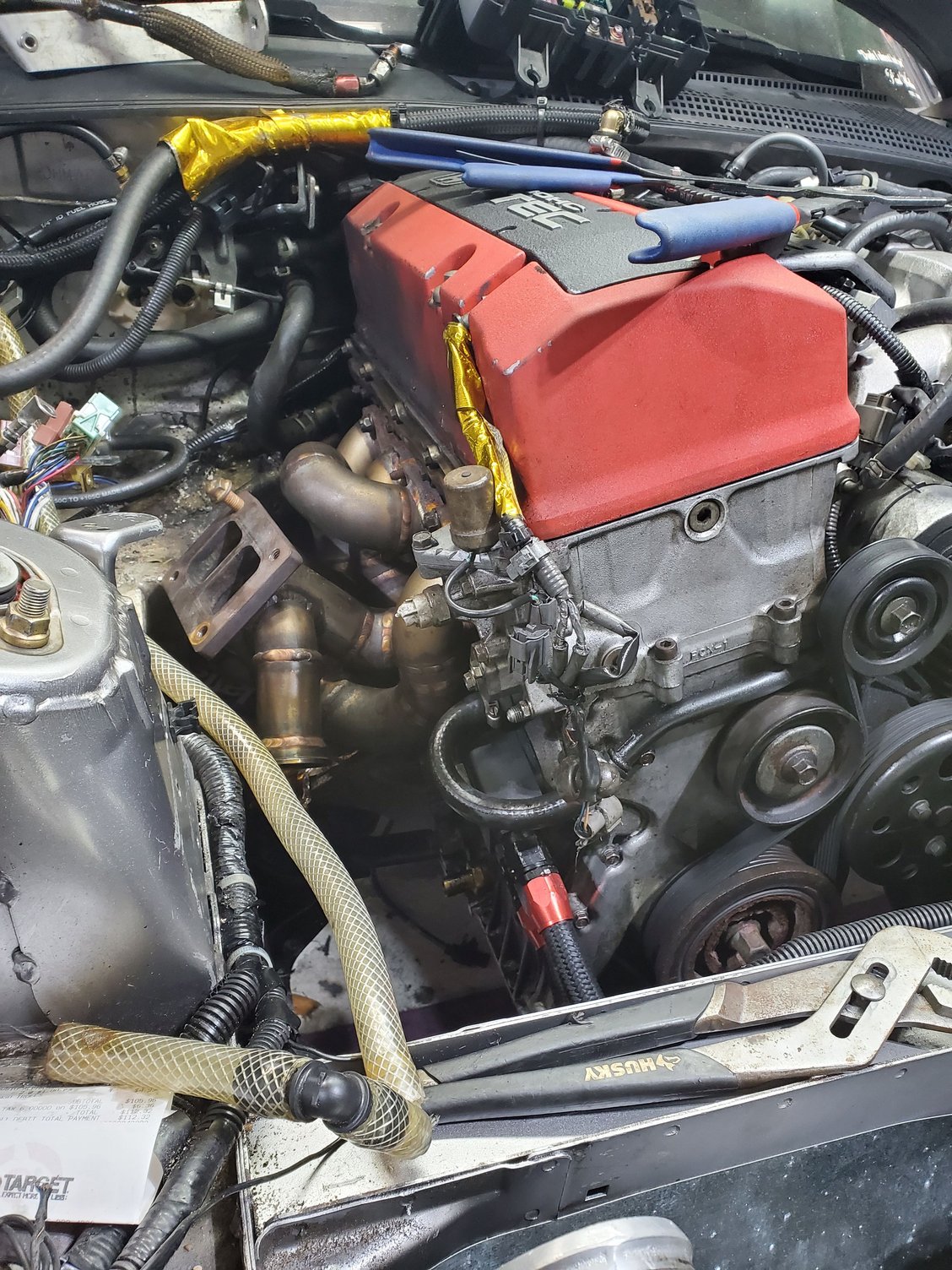

so i have a couple solutions, cut the seat and add some tack welds because i really never want to go through this again. or move on to something else for the hotside. Well we are at a crossroads of both. i'm going to move forward correcting the current hx35 setup while piecing together the next round of upgrades to the hotside. I purchased a second hand (because this is stll a super budget built car lol) pfab elt twin scroll top mount for a killer price. downside is that it is a t4 manifold, the twin scroll should help with responsiveness to offset being cornered into a t4 housing. i could also run a t4 t ot3 adapter but thats just one more failure point.

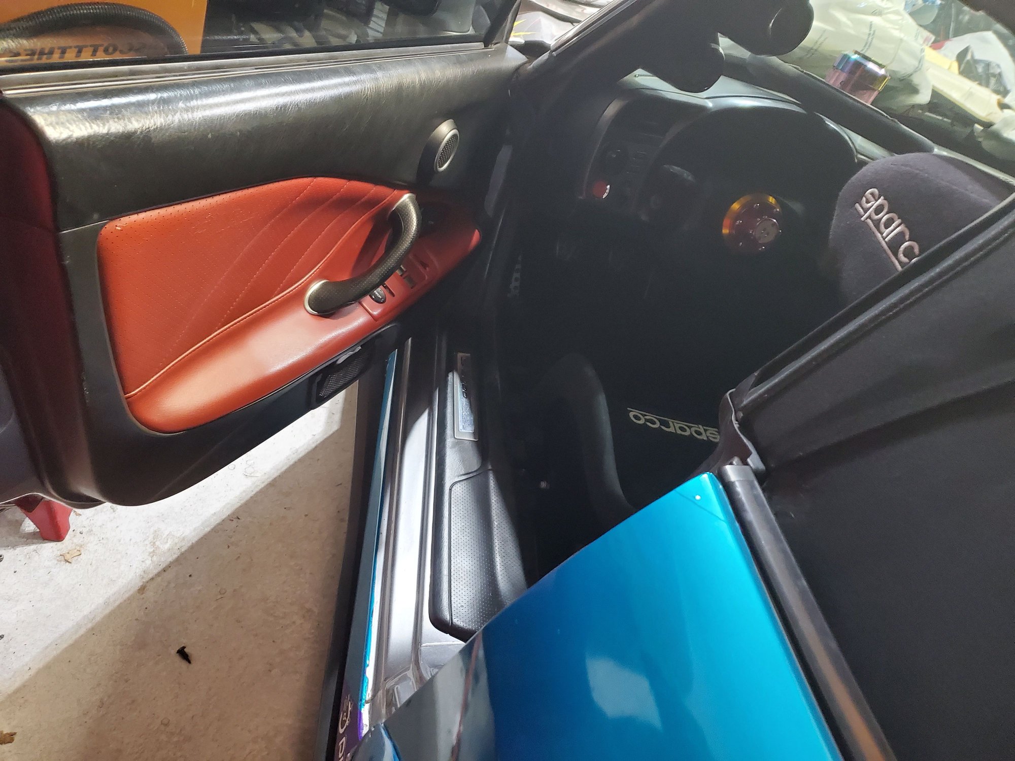

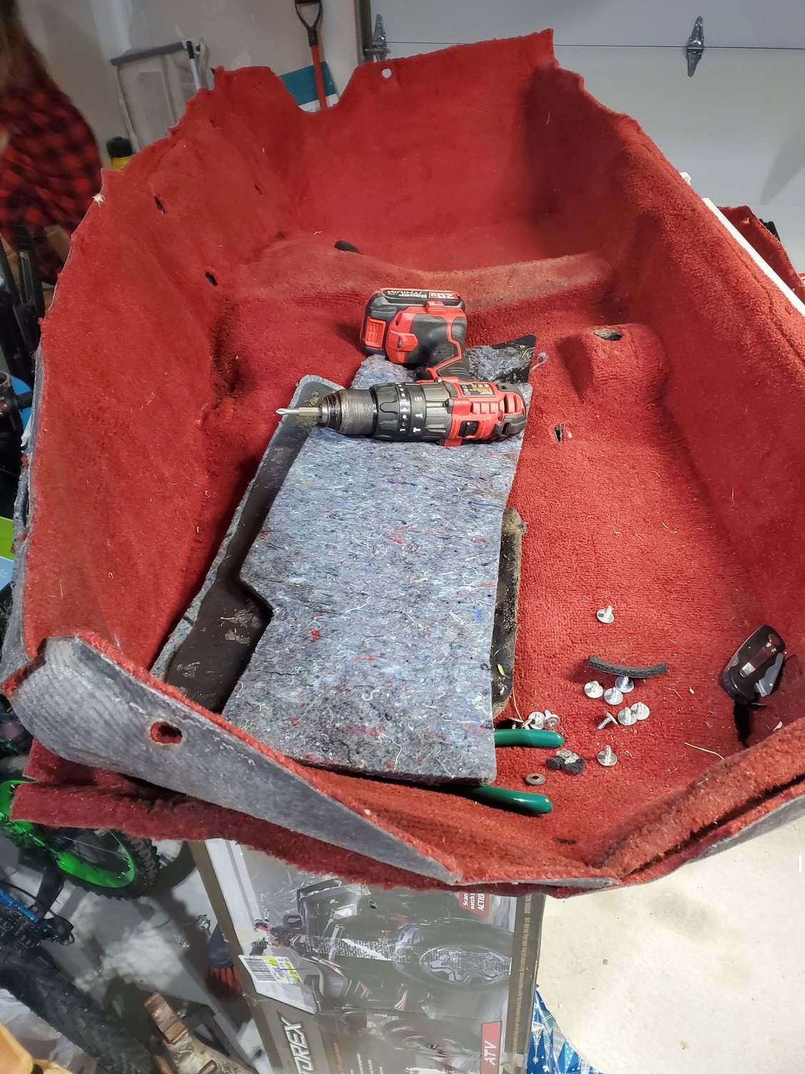

and since i run in #gridlife street mod class i have to have a full interior. finally got to check off a bucket list item here. buddy did a all red to all black conversion. his door panels and carpets were pretty trashed and he gave them too me for free. the door leathers were good so i swapped my black for red leathers. and i have yetto install but have the red carpet ready to go in. they need a good cleaning which i will wait for spring and not snow on the ground and pressure wash them really well. there is some holes my the heals and wear on the hump im not to concerned with as i have extended floor matts that cover up all the shitty spots. always fun doing little things that just make you smile.
