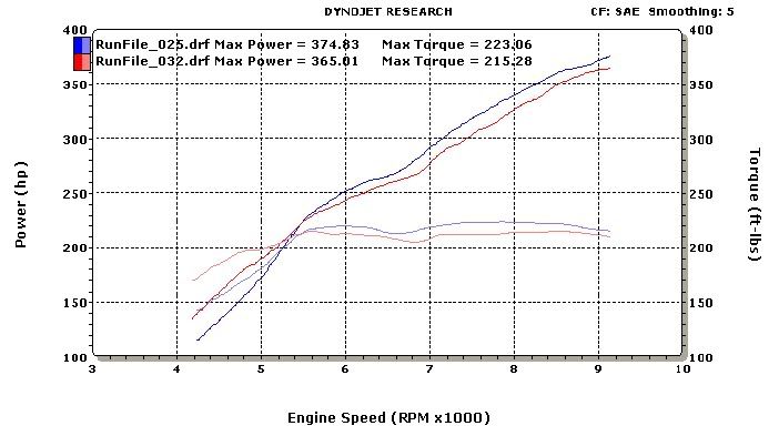

also a recent local member with a s2000 at 9.5psi made 374 with the clutch slipping. Alot has to do with the TURBO SIZE DIFFERENCES.

hey, thats my dyno plot...haha, i am the local member if anyone missed my post. The dyno is right there...375whp at 9lbs. Trust me I was suprised too ive always thought too that tubular made much more than a log type but my setup proved me wrong.
