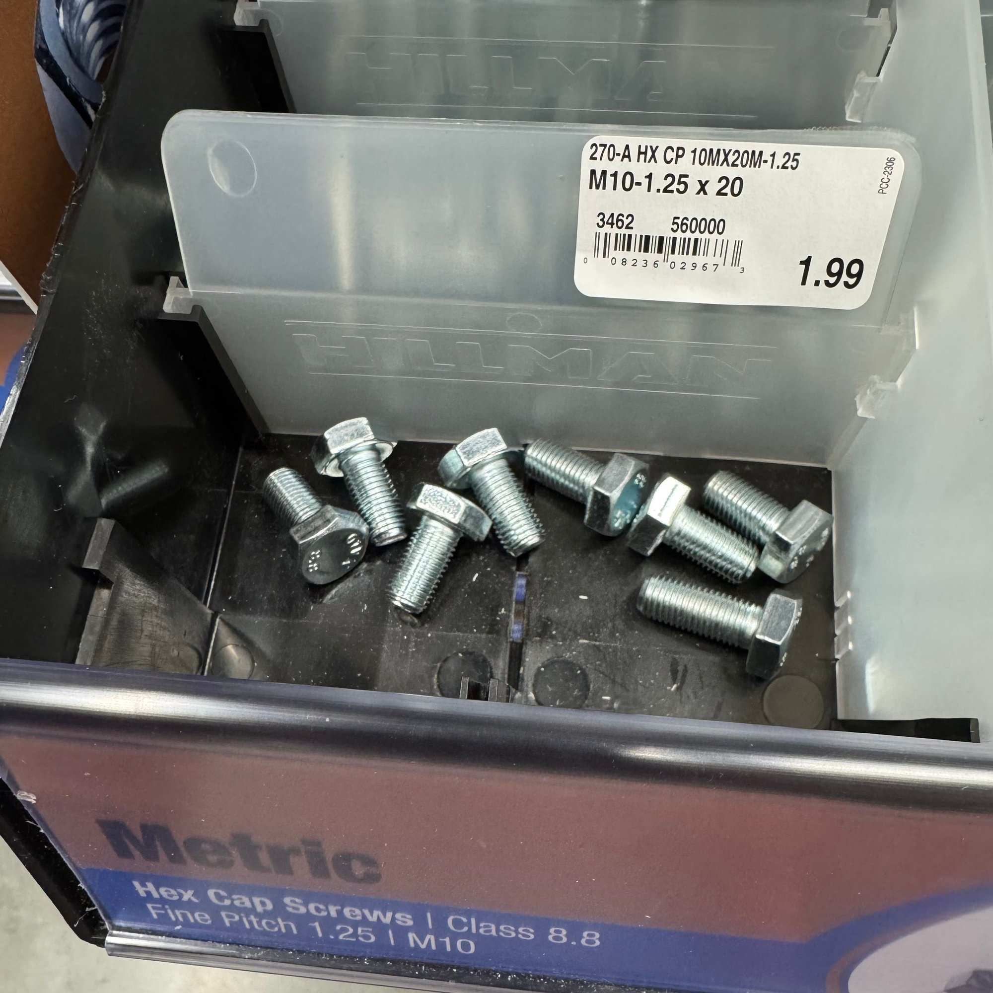

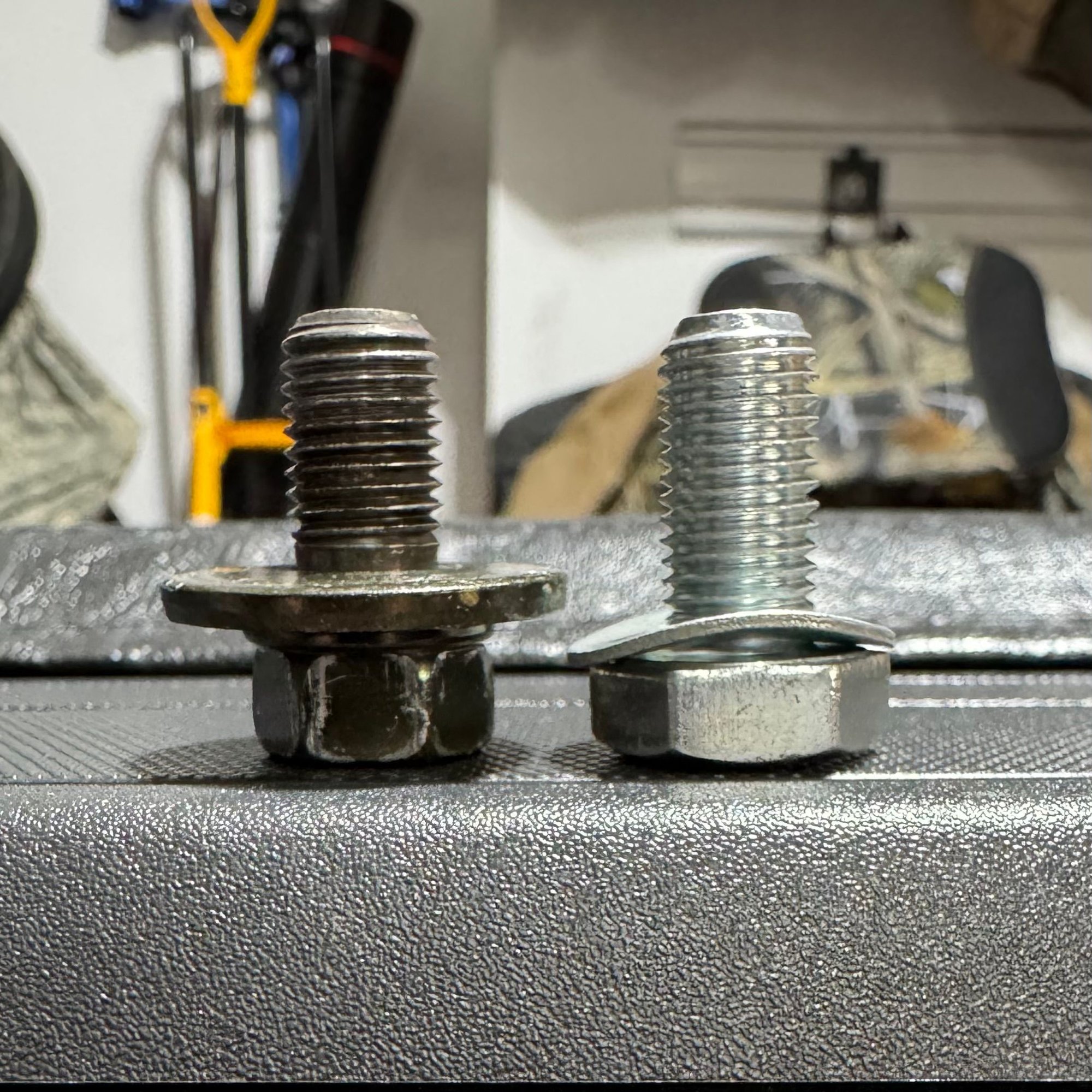

I just ran into this issue myself with a new installation. The rear floor bolt on the inboard side (closest to the tunnel) was interfering with the rail, preventing the seat from sliding back fully (and getting stuck if slid forcefully).
I bought some lower profile bolts at Ace Hardware, and now the seat slides without issue.
Photo attached for reference. Stock bolt on the left. New bolt & spring washer on the right.
Thread Pitch & Length: M10-1.25 x 20
