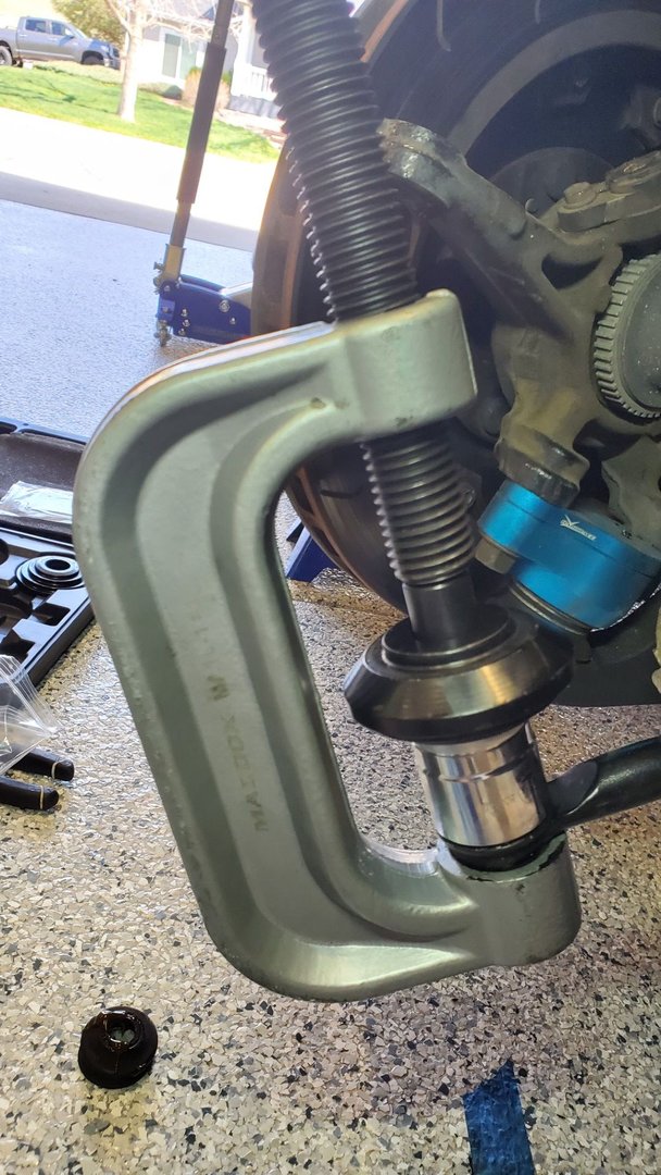

I installed the tie rod boots today. Easy-peasy. Total time for both sides was about 90 minutes including jacking and cleanup.
The 32mm 12-point socket is a perfect fit. And the Maddox ball joint/bushing tool from Harbor Freight worked a treat. It didn't take much force to put the boots on, and I almost got them on by hand tightening the tool.
The old boots came off with a small flat-head screwdriver, I packed the joints and new boots with Lucas Oil Red 'n Tacky which was already in my grease gun.
I also replaced the nuts and cotter pins. The nuts are not castle nuts like I thought I remembered, and probably don't need to be replaced. 40 ft-lbs is the torque spec.

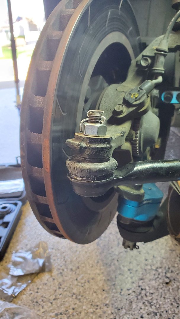

Old Apr 26, 2025 | 05:17 PM
B serious's Avatar
Joined: Nov 2007
Posts: 8,842
Likes: 1,700
^Looks good
You got a little too much grease in there though, from the look of the boot.
Otherwise, congrats on the successful install.
What is the effect of too much grease in the boot? When I test drove it, the steering felt like it wanted to hang up in the last position turned rather than return to center. Is it possible the ball joint is not moving freely and causing this?
This is a track car and I only have about 5° of caster. I could be just imagining things.
Old Apr 28, 2025 | 11:02 AM
B serious's Avatar
Joined: Nov 2007
Posts: 8,842
Likes: 1,700
The grease will probably just ooze out of the boot and make a mess. In rare cases, the boot can rupture.
It won't cause your steering hang up.
