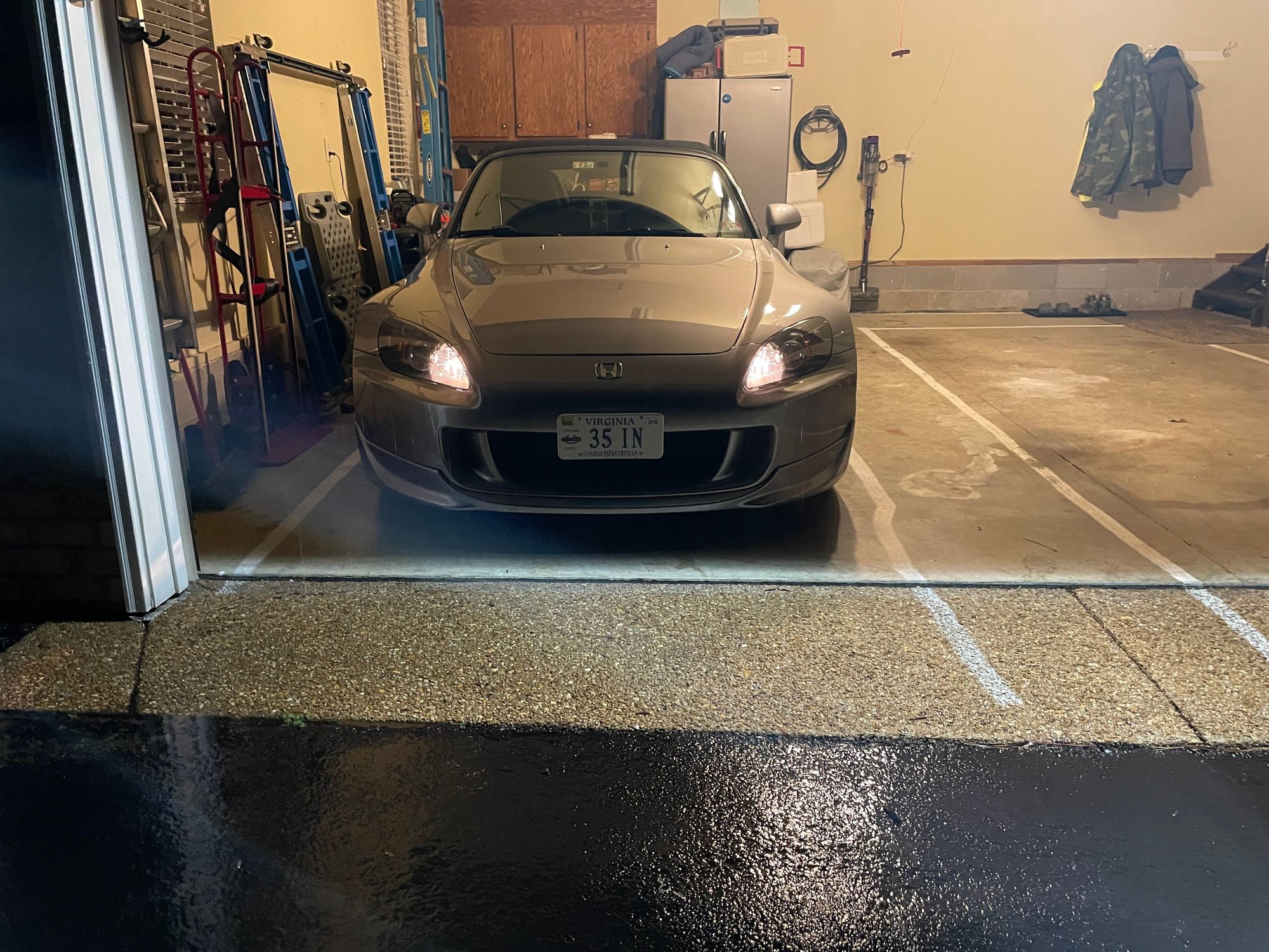

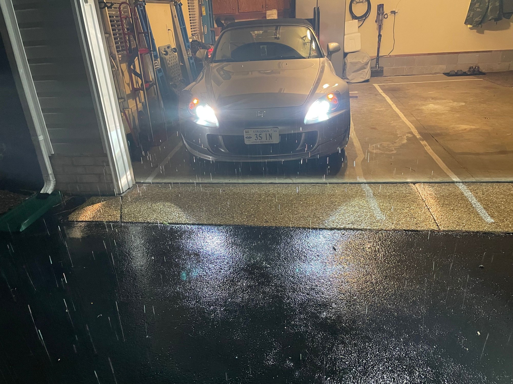

Do you have pics of the lights in DRL use?
Old Jan 12, 2024 | 03:35 PM
Chuck S's Avatar
Joined: Jul 2014
Posts: 13,864
Likes: 1,561
From: Chesterfield VA
Here ya go.
DRLs (reduced voltage high beams):
High beams:
The bulbs are premium priced Sylvania halogens with a blue tint or coating over the top 1/3 of the glass. Sorry but it's raining here. (The things I do for y'all. ) I may be able to find the bulb package. I suspect the color is warmer in DLR voltage. They may be brighter or whiter with the engine running vs just the ignition on.
-- Chuck
