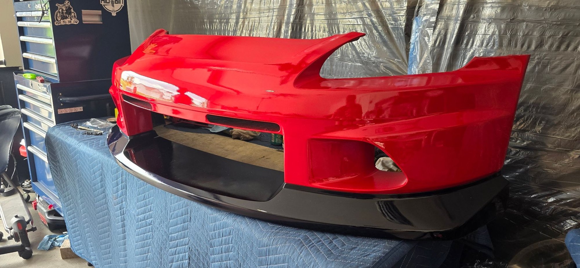

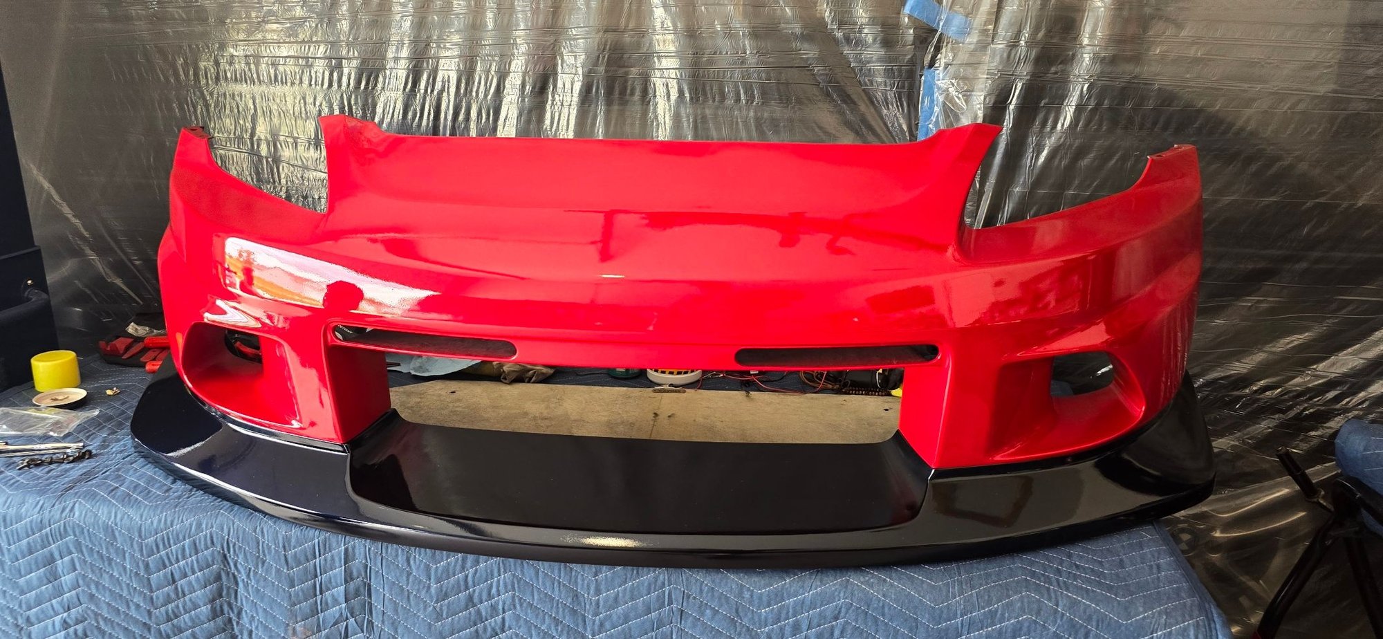

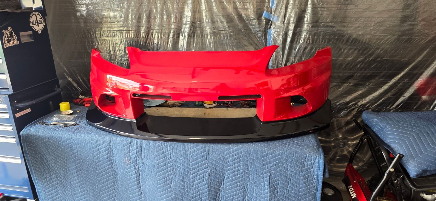

I took your word on the rustolem color and went ahead and painted my voltex bumper lol, so far looks pretty good got a little bit of trash in the paint but going to sand it down and polish it up but here's a picture. Still need to install it and see how close it matches my paint.
