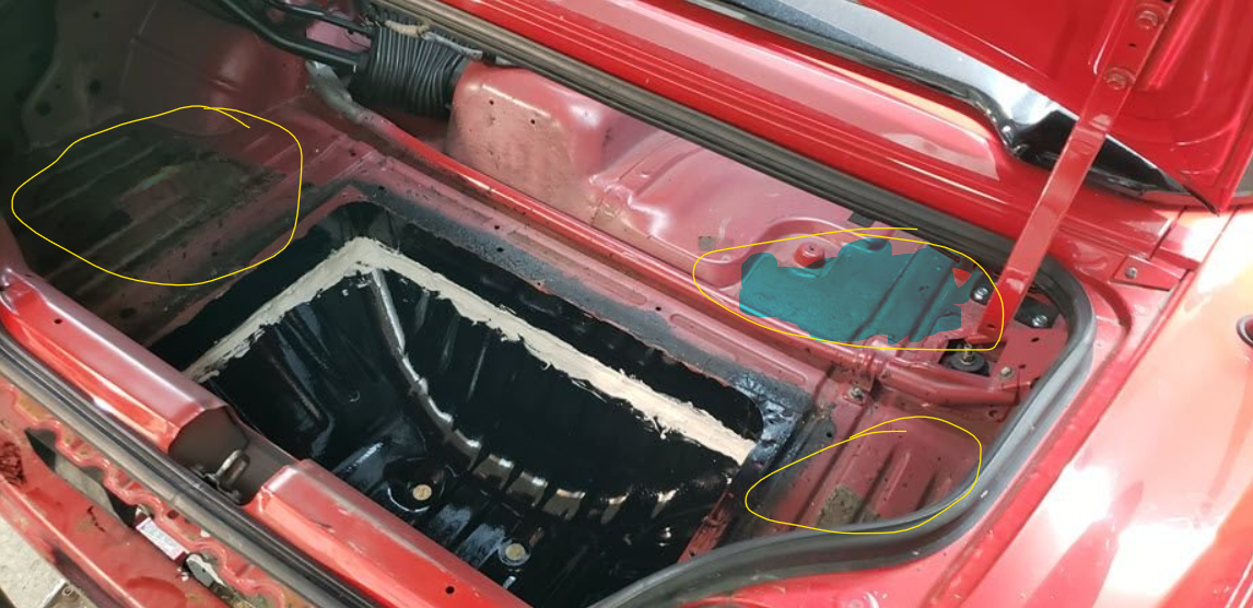

bumping this up as a thank you to B-serious - buying some of this rustoleum sunrise red.
Stupidly put dynmat inside my car - did very little to reduce NVH, but sure a F--- made the car heavier. I instead, got a 5 lbs sound curtain and used it to fill the space where the rear tray used to be and that did wonders to reduce all of the echoing.
Back to the dynamat - don't ever do it. Went and did the dry ice bit yesterday. worked decently well to remove stuff, but also removed paint and a lot of the OEM sound deadening material in the process. Now have bare exposed metal in these areas.
Source picture - B-serious. Editing with yellow circles - Me.
Anyway, got some cans on order to un-fu** my interior.

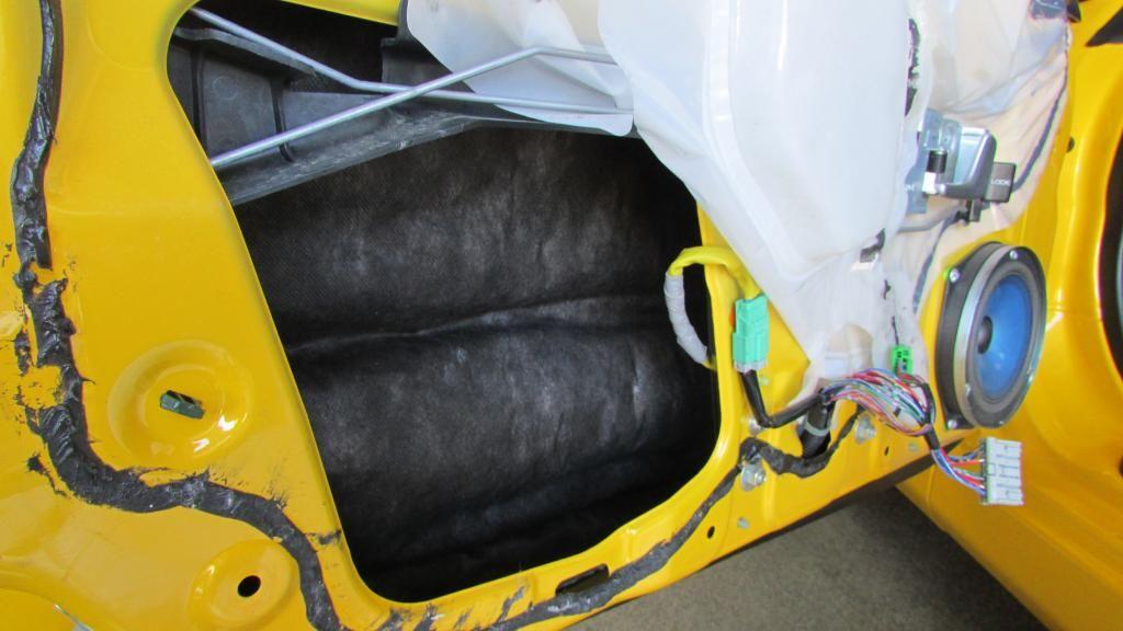

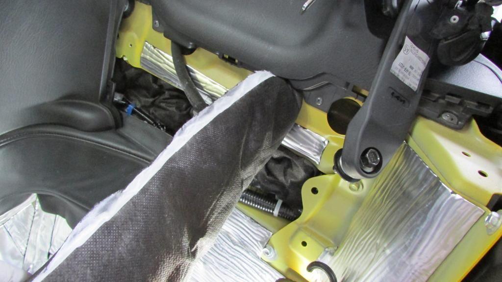

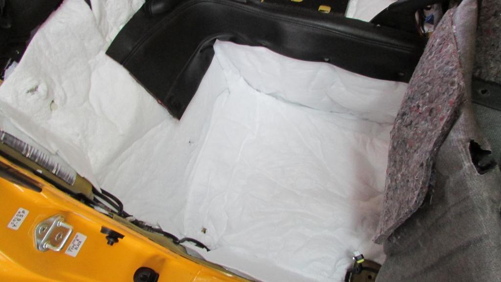

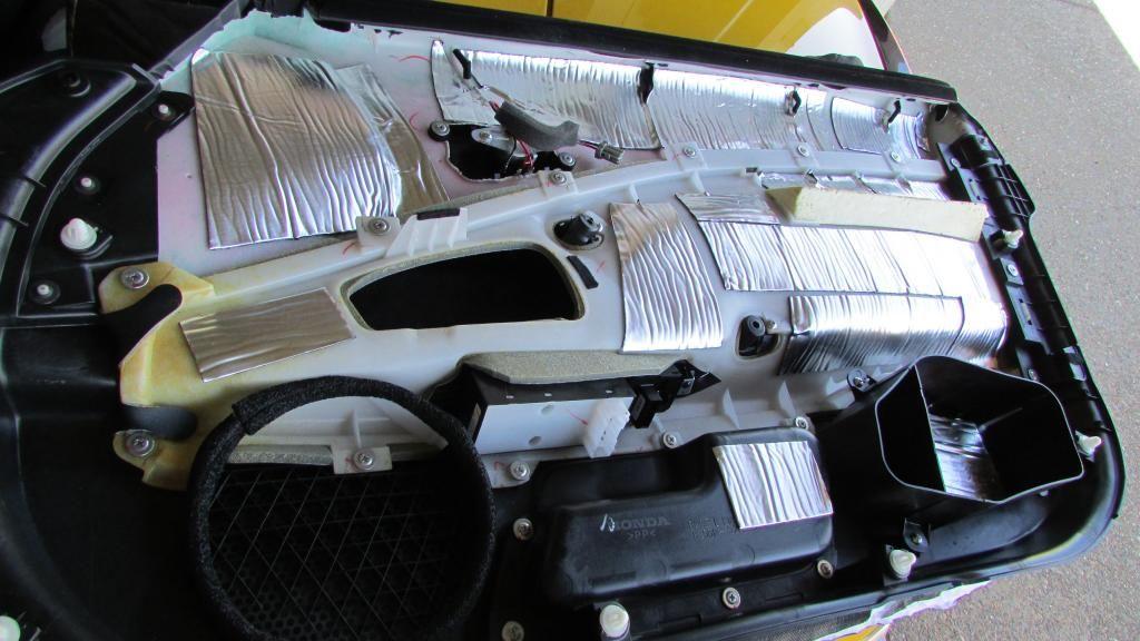

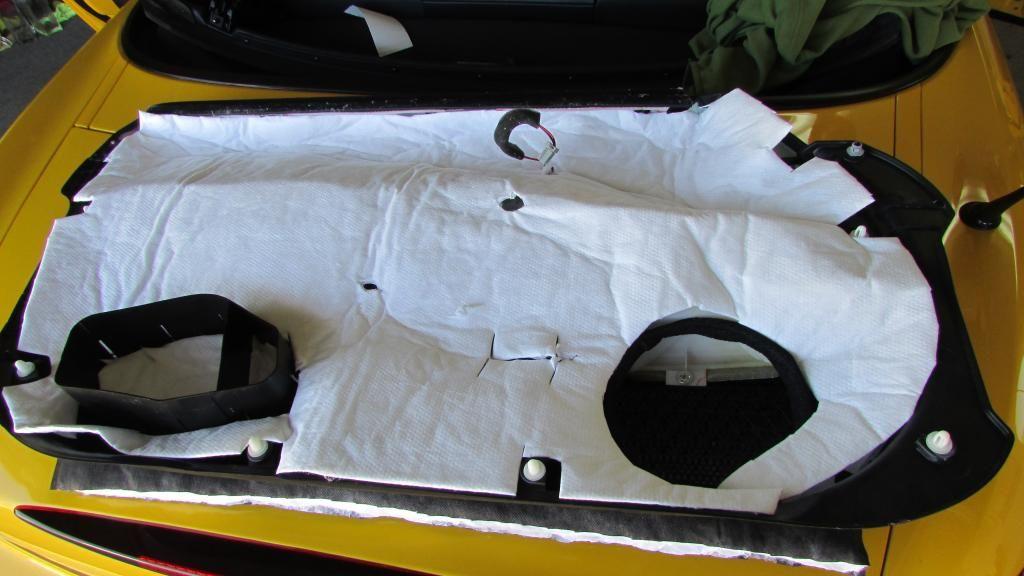

As far as the dynamat is concerned, you don't have to completely coat every inch to gain benefit. I used 3M Thinsulate (automotive material for Acura/Honda vehicles) which is very light and hydrophobic. Does a great job.
You are correct about the Dynamat adding weight. Would not use it on a track car but for a lot of road trips, it is nice.

haha yep!
Unsurprisingly, dynamat does not quiet down booming or droning noises.
The most simple way to think of it is to think of a popular use of dynamat in the car audio market. Tpically, in audio installs, it is used to amplify booming noises. Drone is similar to what a subwoofer does.
I have only dooe a small amount of audio engineering in my past career, to meet an EU noise emission standard.
You would want a sound blocker/reflector on one side and a sound absorber or diffuser on top of it. That would cut down on cabin noise.
Dynamat will just make the booming sound more solid and punchy.

Proper use of dynamat is apply 25% coverage. Divide each flat panel area into imaginary squares. Add a piece 25% in center of that square. So a patchwork of square patches of mat here and there.
Adds mass to change resonant frequency. Use only on flat panels that can easily vibe. Door panels perfect example.
Thought experiment. Imagine a bell, like at hotel desk. How much dynamat would it take to make it not ding? Only a small bit would make huge difference. While adding a ton barely makes it better.
So it prevents road noise from turning panel into a crude speaker. Repeating the road noise into cabin.
But now you also need something to block sound passing through panel. Something full coverage, like the automotive thinsulate example. Fibers are cut to exact length to kill typical car sound frequencies. So its not just ski jacket thinsulate.
