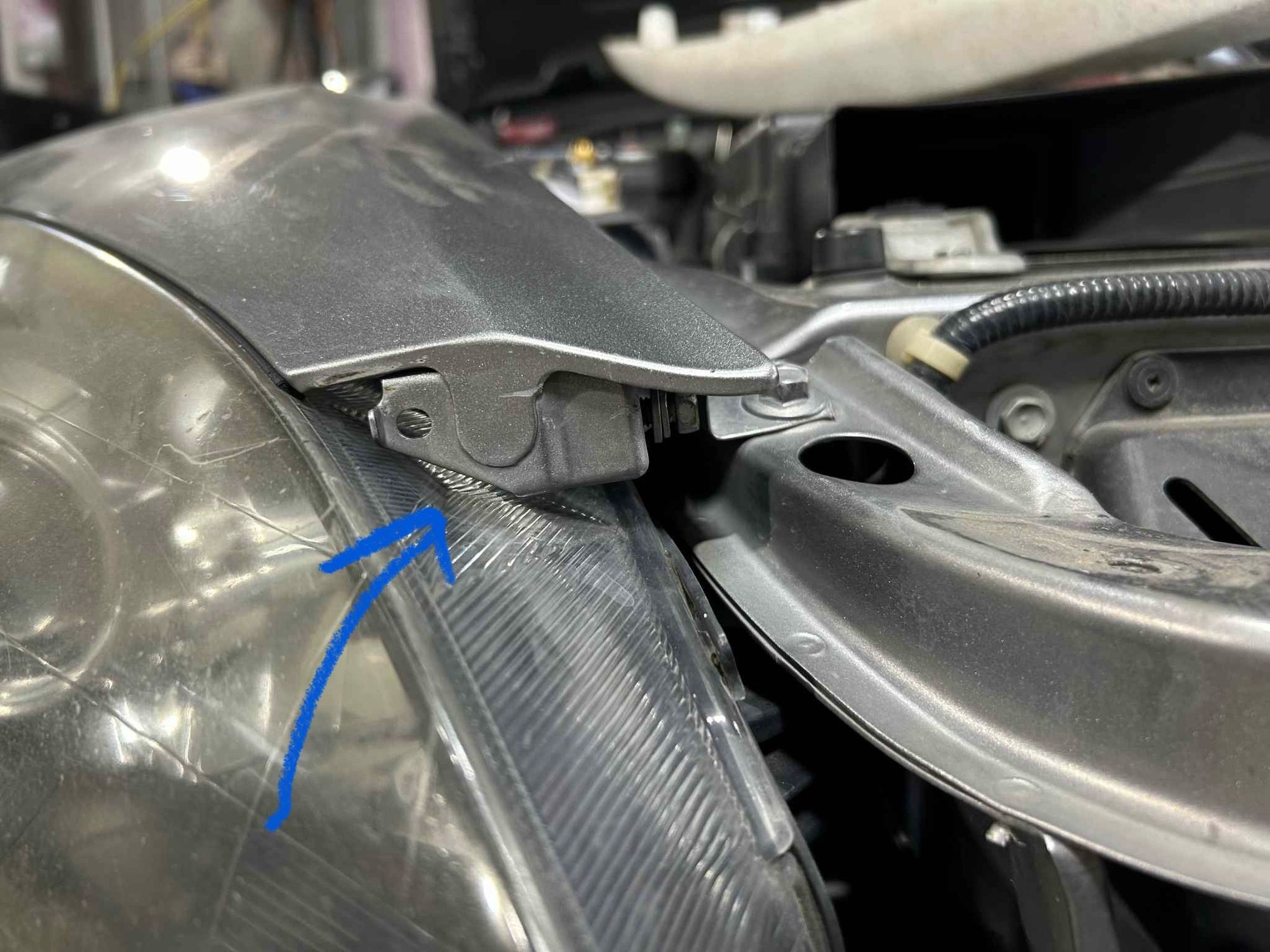

There’s a tab on the underside of the fender for mounting the bumper that is meant to be installed in line with the front edge of the fender like this on the OEM:

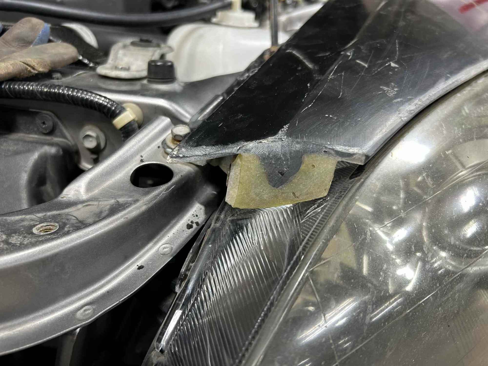

Here’s what it looks like on the drivers side of the downforce fender. Nice and flush with just a little bit of manipulation required to not interfere with the headlight:

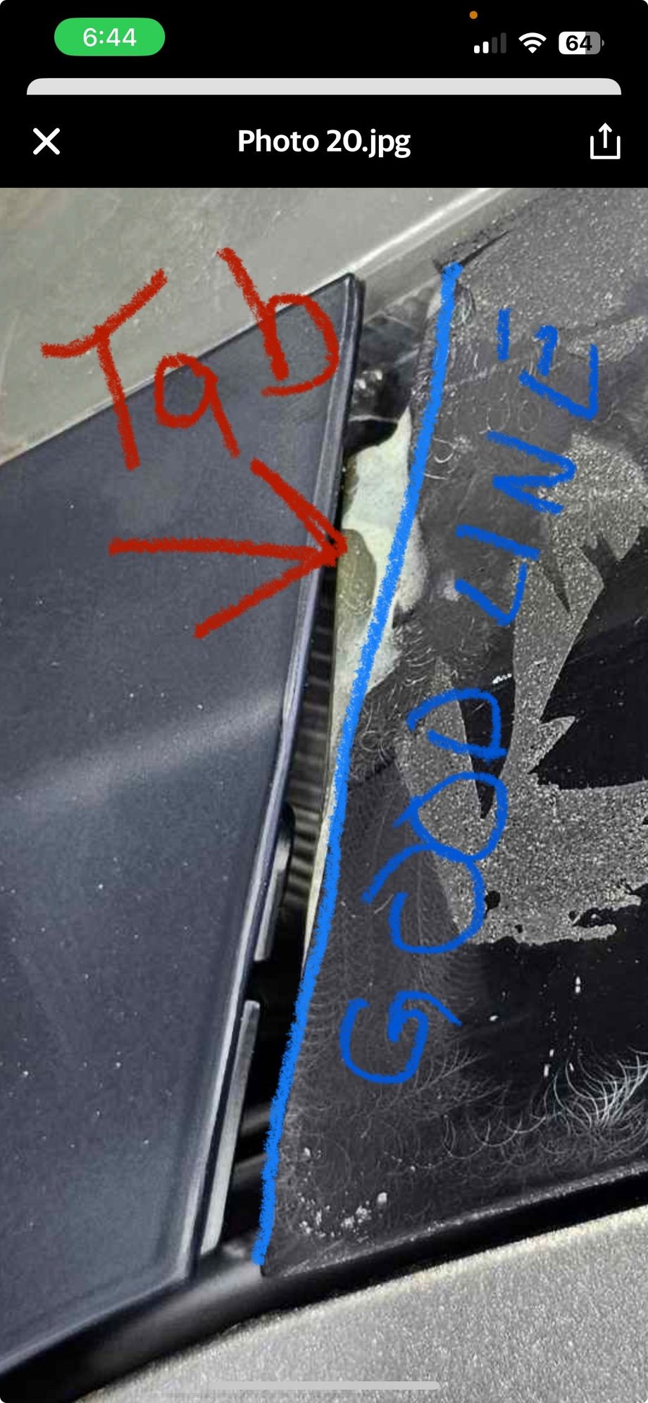

Here’s the top down view of the passenger side. The blue line shows the natural line of the fender and you can clearly see that the tab has been mounted at an angle and is very proud of the fender edge:
Downforce refuses to replace the fender and insists that “aftermarket products are not always a 100% direct fit and sometimes do need manipulation by a body shop in order to make them fit - whether that be shaving certain areas, adding fiberglass to other areas, or additional brackets / methods of fitting in order to make components fit.”
While I totally understand and agree that some fitting is required, in order to make this fender work the shop would have to shave off half of the length of the tab and fabricate an extension for the bumper mounting point, or completely cut off the tab and then re-attach it to the fender in the correct location. Either way, it’s clear that their casting is not done correctly as it’s no where close to the driver side.

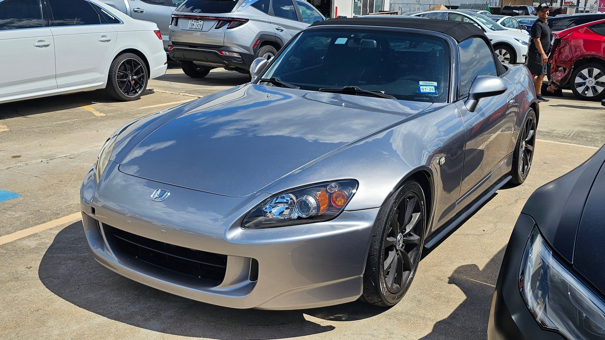

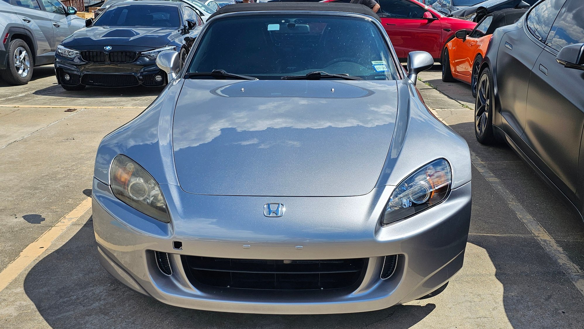

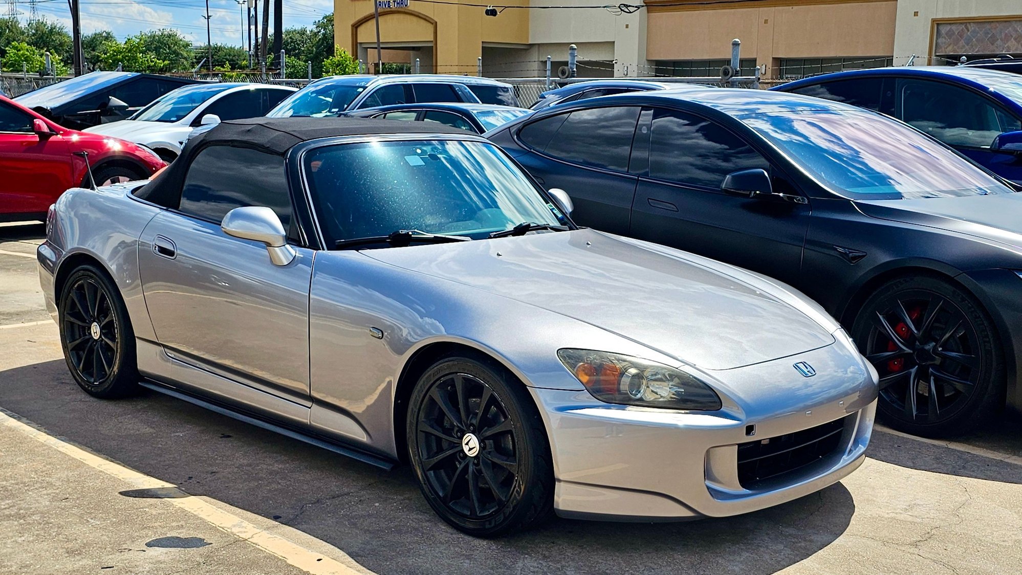

Sorry, but at least -- how does she look? Pics?

From: Houston
In the end it came out great…it’s not terribly noticeable unless you know the car, but it gives me so much more room for wheels!

From: Orlando
Looks beautiful. That dude in the background is so happy for you lol.
