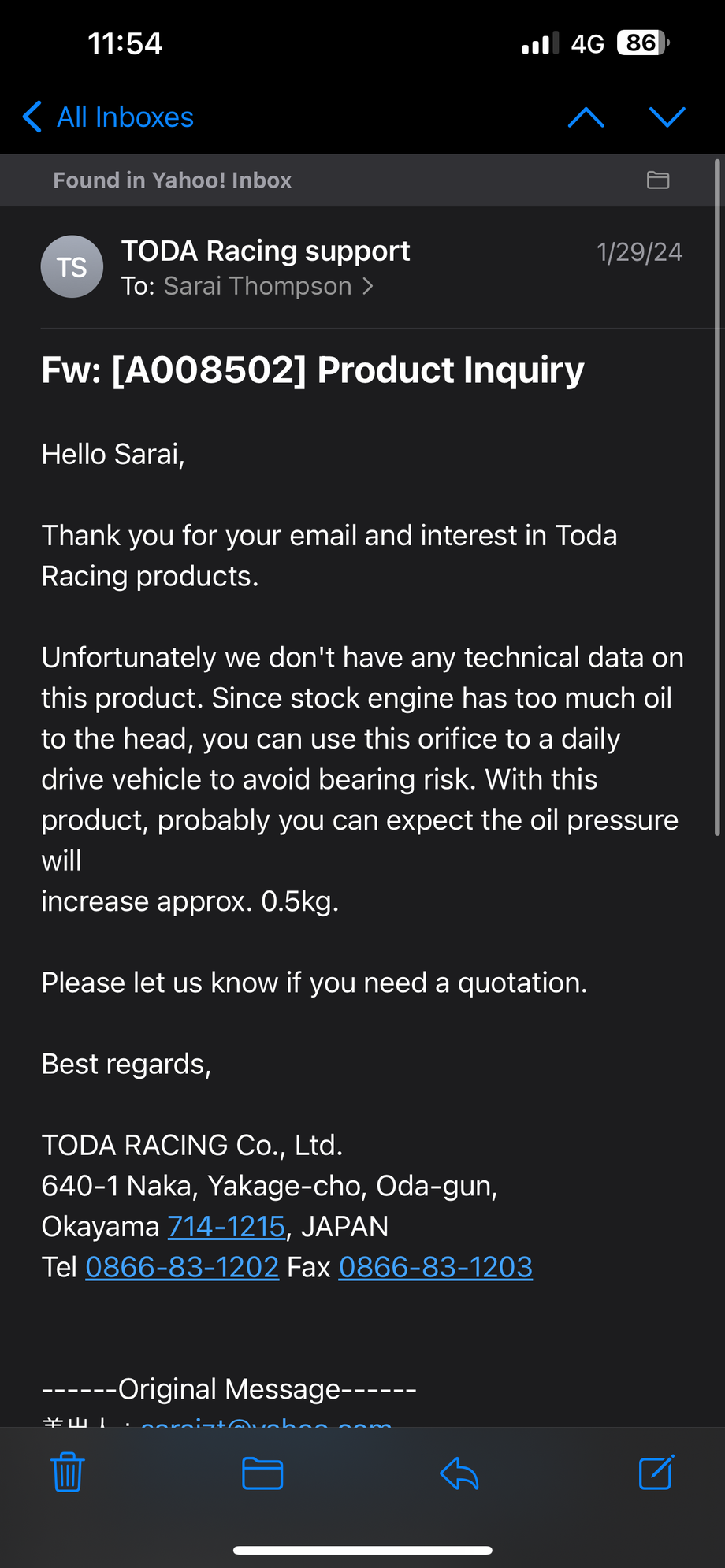

So i recently just installed mine in my car about a month ago. So far im still hitting vtec and having no problems. i got in contact with toda as well because i was worried over potential increased wear due to less oil as well as kore heat since less oil is cooling the head but if toda says its good im gonna trust them!
