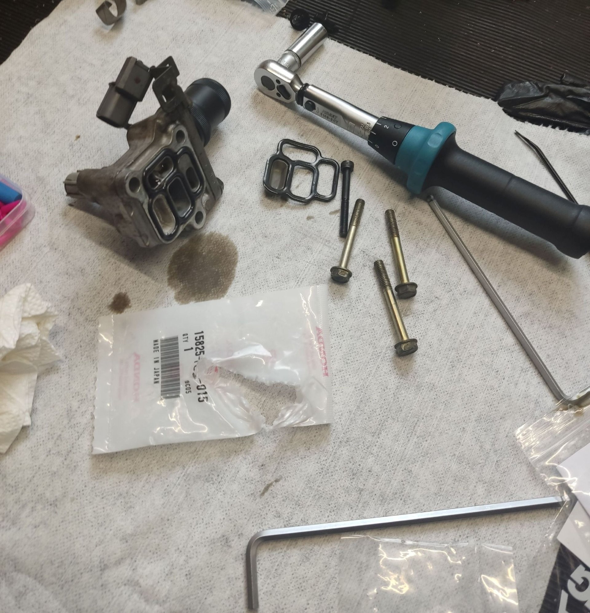

I installed the orifice today. It reduces the diameter of the oil channel from 8 mm to 3 mm.
Installation is easy,but here is a word of wanring: Clean the orifice thoroughly before installation. The reason is brass creates very tiny chips when it gets machined. I found a small one in the clear plastik pack in wich the orifice comes.

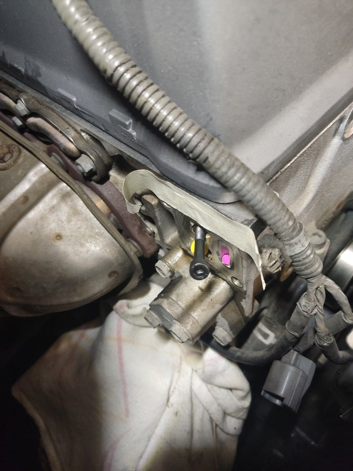

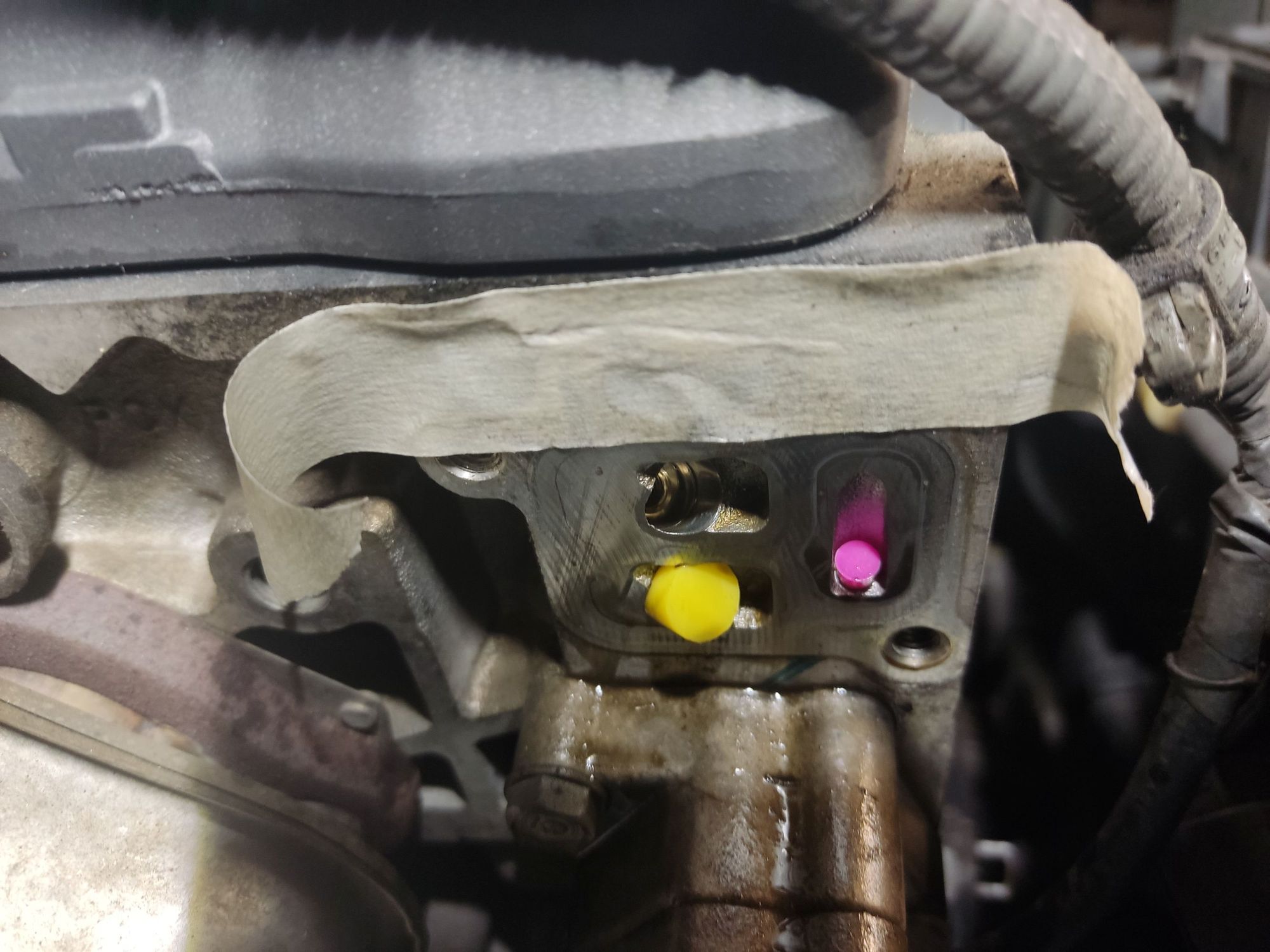

Remember, you work on oil channels of the engine wich are located AFTER the oil filter. No dirt or or dust should enter this. Work as tidy as possible. I coverd the other oil channels with tape and rupper plugs to avoid that dirt enter the engine.
Place a rag over the water hoses of the Oil cooler to catch oil drips, water hoses dont like engine oil. Use a new VTC valve gasket.
Installation is easy, but my heart skiped a beat while installetion. Why? Judging by pictures, the Orifice should sit flush with the mounting surface of the VTEC valve after installation.
Mine just fell into this postion losely, with play. I tapped it a litte bit with a regular size hammer.. still not good... One more tap with a little bit more oomph... and it slide into the hole, about 5 mm deep.
I almost had a heart attack this moment. But there it was, sitting thight. I could not remove the bolt wich is used for installation with my fingers, i needed a allen key.

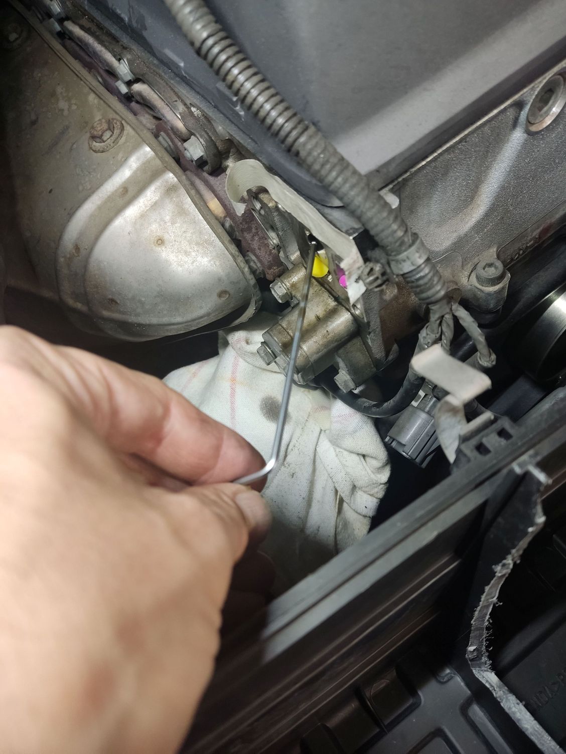

Becaus i was concerend that something went wrong, i run a small, long allen key down into the hole and find to my great relief tha the oil channel is about 6 cm - 2" deep until the allen key stops.
So, the orifice in my engine sit about 4-5 mm deeper as advertised, but it´s O.K. Beside that i have some additional grey hair in my beard...
Test drive showed that everything is O.K. VTEC works, no oil leaks. Inspection of the filter screen in the old VTEC valve gasket showed onl a few very small black dots, the size tenths of a millimeter. Looks like i have a healthy engine.
