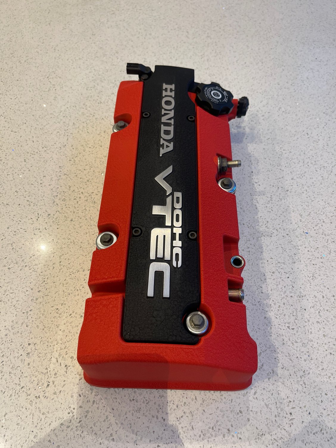

So spent the day painting and doing valve clearances, this is the end result. Thanks for the help and hope this helps someone else in the future

Looks much better! What brand did you go with?
Old Apr 14, 2024 | 02:16 PM
Presario21's Avatar
Joined: Apr 2024
Posts: 14
Went with Halfords etching primer then VHT wrinkle red SP204 and wrinkle black SP201

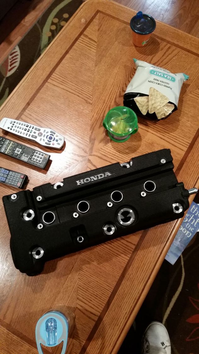

Yeah looks good now. Yeah you def have to use primer that's for sure. Here's my K20 valve cover that I did in vht wrinkle black a few years ago and has held up great over the years. No issues.
