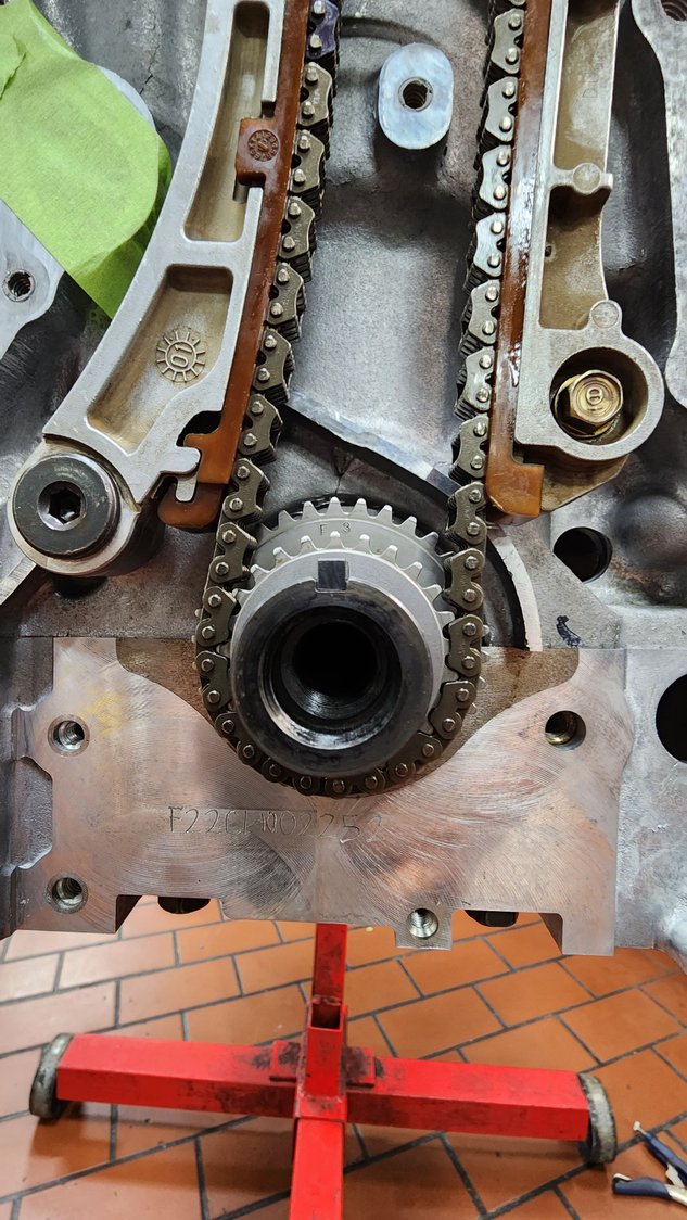

The prior F24 engine I built 3 years ago finally caught a rod knock 37,000 miles later after being overreved at 8600 sustained in 3rd gear for about 1 month or so.
https://www.s2ki.com/forums/s2000-un...-build-1195919
That engine made 259whp/187tq on a Dyno Dynamics on 93 fuel.
So now, I will put together a replacement engine.
GOALS:
I want to see how far I can get with the build with stock bore (87mm) and stock ports on the head. I will retain 93 fuel. It is truly a waste of research to see a nice engine build only to have the data ruined by an E85 setup. Some of us love to not have our fuel system ruined by that poison.
THE SETUP:
  • K24 crank from an Accord
  • InlinePro rods for OEM pistons
  • PZX OEM pistons (-1.4cc) PCX OEM pistons (2.3cc)
  • Abradable powder coating from Line2Line on the pistons

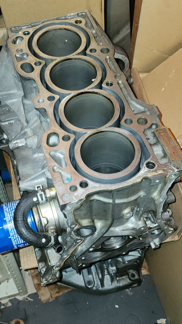

  • Factory block with 30k miles and completely undisturbed FRM. The crosshatch is still visible.
  • Cylinder head has stock ports but has been milled 0.5mm (0.020). Stock head with Toda valve springs to save time and to keep CR with the AP1 pistons.
  • 12.8:1 13.2 target CR with stock head gasket
  • Urge camshafts ** No longer using on this setup. Using BC Stage 2 Cams
  • Toda camshaft gears ** Obtained Skunk2 gears
MODS CARRYING OVER FROM PRIOR ENGINE:
  • Urge Unicorn header
  • Toda tapered test pipe
  • EVS single exhaust
  • TODA TCT
  • SOS throttle body
  • Subaru Blue 565CC injectors
  • Toda lightweight pulleys
  • AEM EMS v2
NEW SUPPORTING MODS:
  • Oil pressure and temp gauges
  • EVS oil pan baffle
  • AEM wideband
  • Toda oil control orifice
