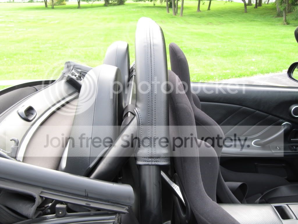

Originally Posted by Fasting
Old style HD DD sits further back, but is a little tougher install.
https://www.s2ki.com/s2000/topic/851...winter+project
For comparison, can you post a pic of your 2 bend bar from this angle?
thread

Originally Posted by rosica
thread
