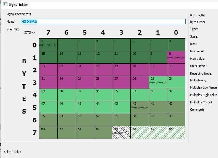

This is the format for the individual wheel speeds coming from the 06+ abs unit.
Ahhh lol, that makes more sense. So it just looks like each 2-byte pair is getting increasingly precise because it's bit-shifted by 1. So my equation works because the least significant bit gets rounded off and doesn't make any difference, but it's just giving the LF speed. I'll have to see if I can se up multiple speed traces in RC, as it would definitely be interesting to compare wheel speeds at times.

And it looks like you can track individual wheel speeds in RC, so these should be the equations unless I've made a mistake (haven't had a chance to test yet)
Wheel speeds
PID: 448
Equations:
LF: bitstouint(raw,0,15)/32767.0*200*0.44704
RF: bitstouint(raw,15,15)/32767.0*200*0.44704
LR: bitstouint(raw,30,15)/32767.0*200*0.44704
RR: bitstouint(raw,45,15)/32767.0*200*0.44704
To enter them, you pick Wheel Speed (kph) or (mph) (depending on your units setting) for channel, and then tap "Show More", and choose the specific wheel under Channel postfix.
