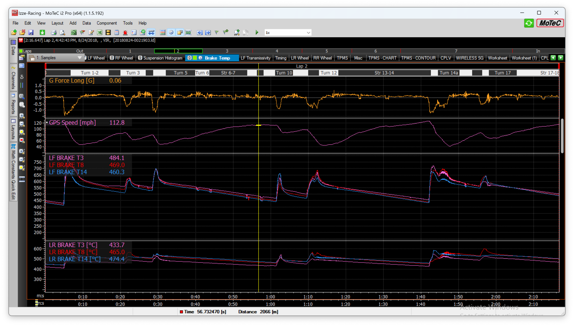

Rear pad life has not been an issue for us. As shown in the data below, the S2000 rear brakes run hot and cool at a much slower rate than the fronts. This heat soaking does nothing good for the bearings and hub fatigue life. The plan is to run the Urge kit in the rear this year and compare the temperatures.
Note that there are three temperatures per rotor: Insider, Middle, Outside
