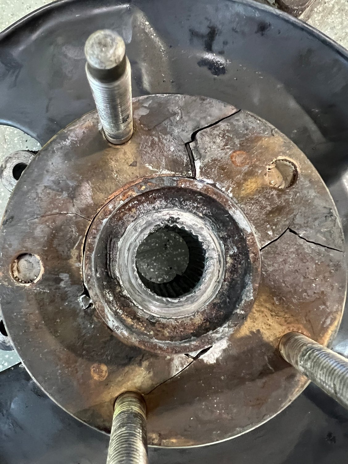

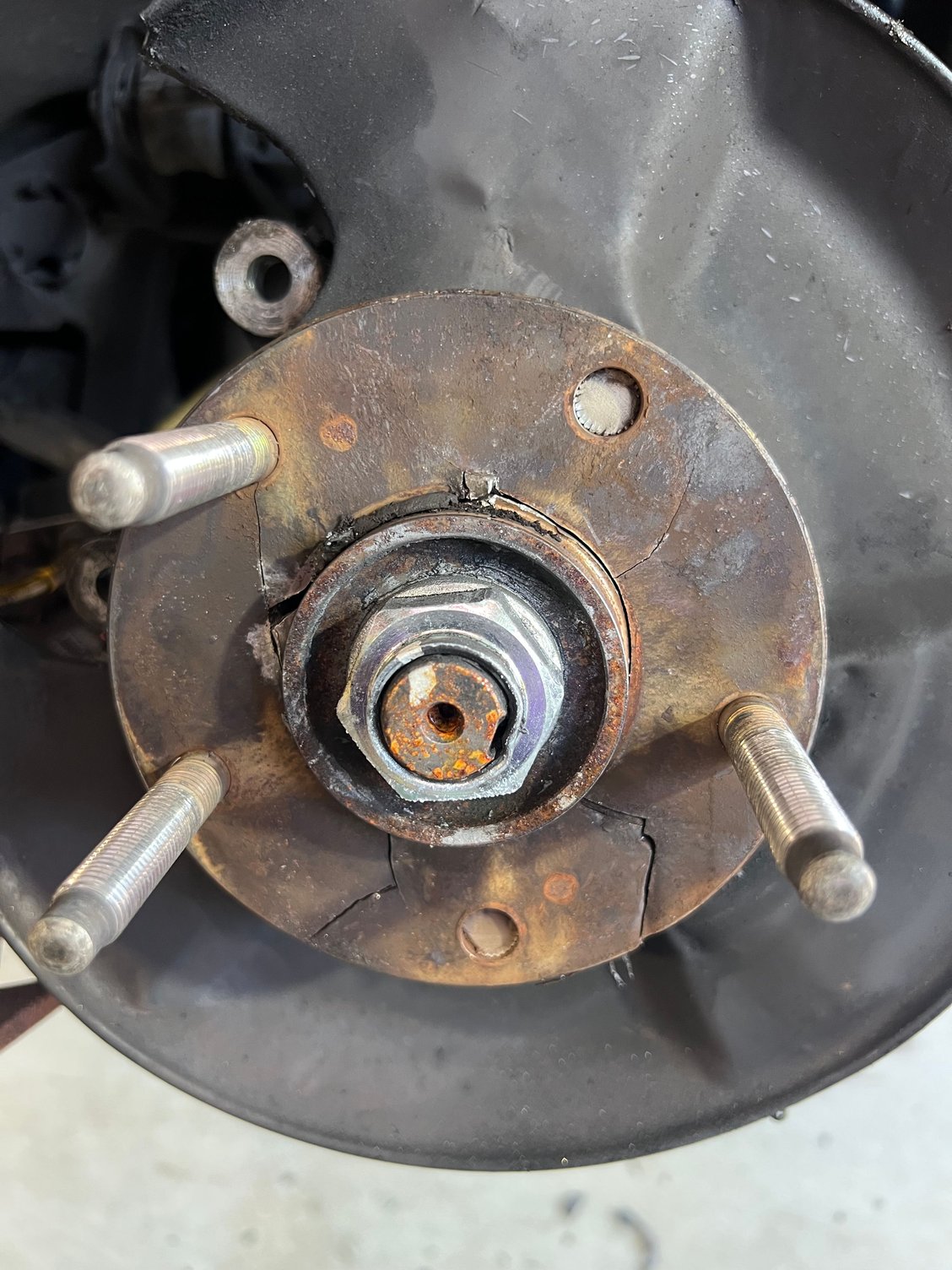

Finally after 3 seasons and 33 events (~80 track days) of real abuse my Karcepts hub on drivers side has failed. It gave up in Hog Pen at VIR as I was matching my PB. I felt serious vibration and backed off fortunately. Result - cracked hub with 2 shaved off studs.
I yet to press the bearing out to see what it all looks like disassembled, but I am guessing it all originated from failing bearing. I was getting some warnings - some noise, which was attributed originally to CV joint going bad. Then it was clear that the side was getting too hot when axle was being rebuild by Ben from puddymodracing. In 2-3 sessions leading to the failure I started feeling the vibration but thought it was from the lack of wheel balancing - Hoosiers spinning on the wheel (seems like a common issue).
Not to self - change hubs/bearings proactively after 20 (max 25 events). I definitely have more faith in Karcepts than OEM. New set is in.

thanks for reporting back.
What brakes are you using in the rear? What was the cause of the bearing failing?
