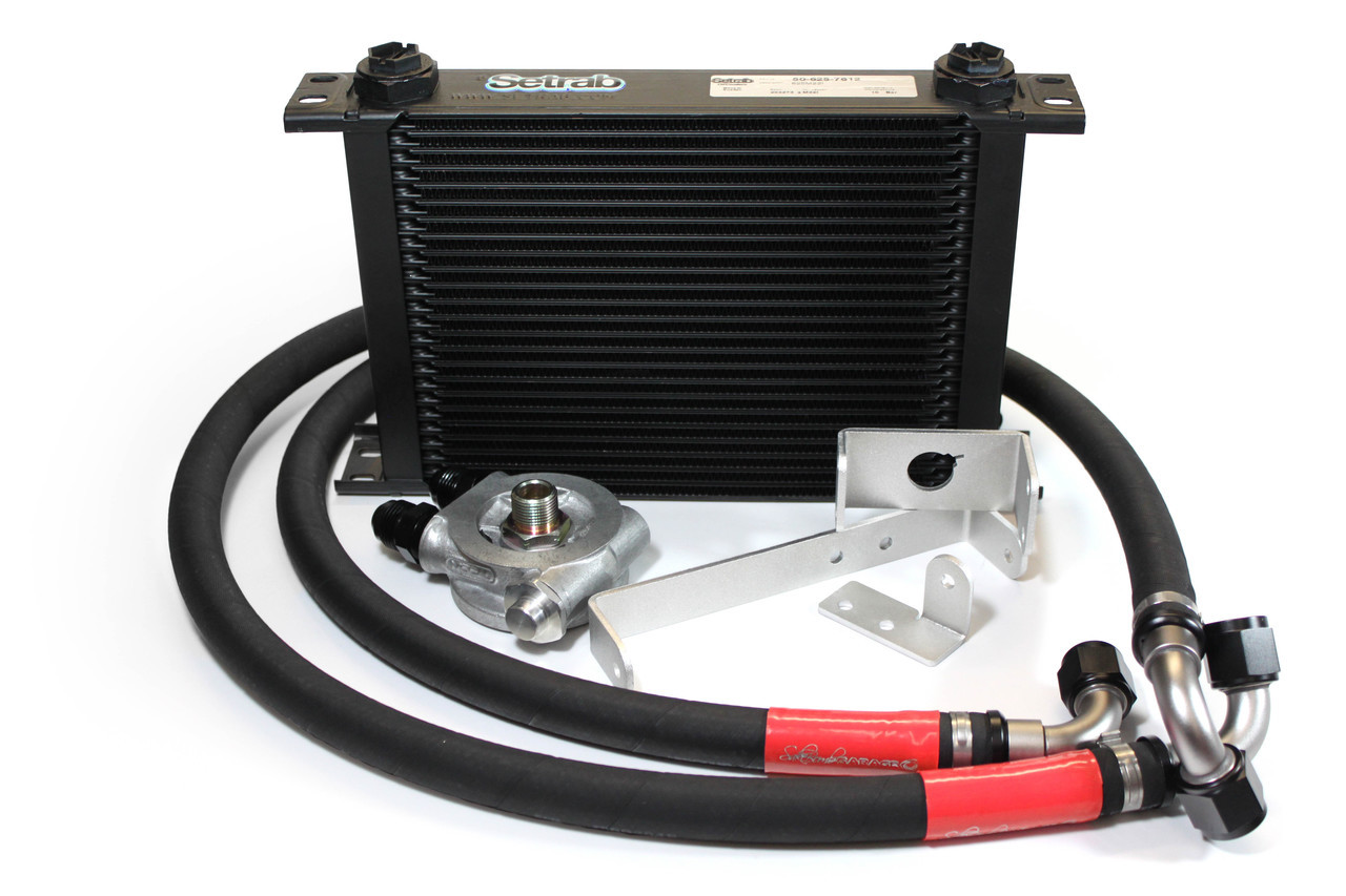

Originally Posted by yamahaSHO
Looks like a nice kit, and configurable!
Questions: What kind of temps are you seeing on the street with the 180F thermostat? I ask because with a 200F thermostat in 40-50F weather, I sat in the upper 130's while cruising to the track this past week. Also, what temps were you seeing on track with both cores in 100F weather?
Back to oil coolers and questions - We’ve put this kit through its paces on the street, backroads, and track over the course of the last 8 months, with rock solid results. Buttonwillow, Thunderhill, and Sonoma Raceways to name a few. The worst conditions this year were at Buttonwillow Raceway here in California during a particularly hot day topping out over 100 degrees F. ambient. We ran the car almost 7 sessions (lost our brakes a couple times and had to pit so it wasn’t a full 7). Sessions were 25+ minute and mid-day temps were damn hot. Temps ranged from 205 early on in the day to a max of 228 at the hottest point in the day, though were rock solid and stable around 220F most of the day. This was with a baffled oil pan, intake, exhaust, basic bolt-ons, and the 25 row cooler. Running the 19 row cooler on other days for comparison (though they were cooler) I would guestimate an average of 230F, so a rough 10 degree difference between the two cooler sizes. There’s a lot of variables but that’s roughly what we’ve found so far. If anyone wants to do some hardcore testing on these things there’s a t-shirt in it for ya but I can say from our experience that we’ve put this kit through its paces over the course of 8 months and quite a bit of track testing… we’re damn confident with it and the Setrab coolers are some of the highest efficiency out there.
So 10,000 ft view is: 220-230F depending on cooler size and track temp.

Originally Posted by 99SH
Do you have pictures of the oil cooler mounted with bumper removed? Curious to see how it's mounted - I can peek at the radiator center mount being used as a mounting location.
Under hood shots would be helpful to see line routing. Some folks may have parts co-located they need to maneuver around.
May be worth mentioning, you're including the M22 fittings at the oil cooler too, correct?
+1 for using Setrab. One of the best!
Pics of cooler mounted:
We've added a bit extra length to the lines to allow clearance for additional parts such as intakes etc, but will also work with stock intake. You can route the lines lower if you want to clean up the runs a bit, we just took the path of least resistance with them and ran them where there was ample room to sneak them by the airbox, but there are a few ways to do it.
Hose Routing:
Yes we include everything needed for the kit including m22 top fittings, every nut and bolt, and a pictorial instruction manual
Thanks, we love Setrabs too and use them on all our cars from Miatas to twin coolers for the ridiculously hot rotaries . They are indeed the absolute best out there in coolers!!
