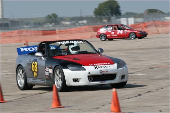

Originally Posted by TheNick,Apr 16 2010, 08:08 AM
I do not believe FP allows the aero stuff you have.
Yep. No wings in FP, thus my giganto-spoiler:
That said, the wing looks like the only thing keeping you out of FP, off the top of my head. If you wanted to run FP, just unbolt the wing from the uprights. I used to do that when I had the APR wing.
