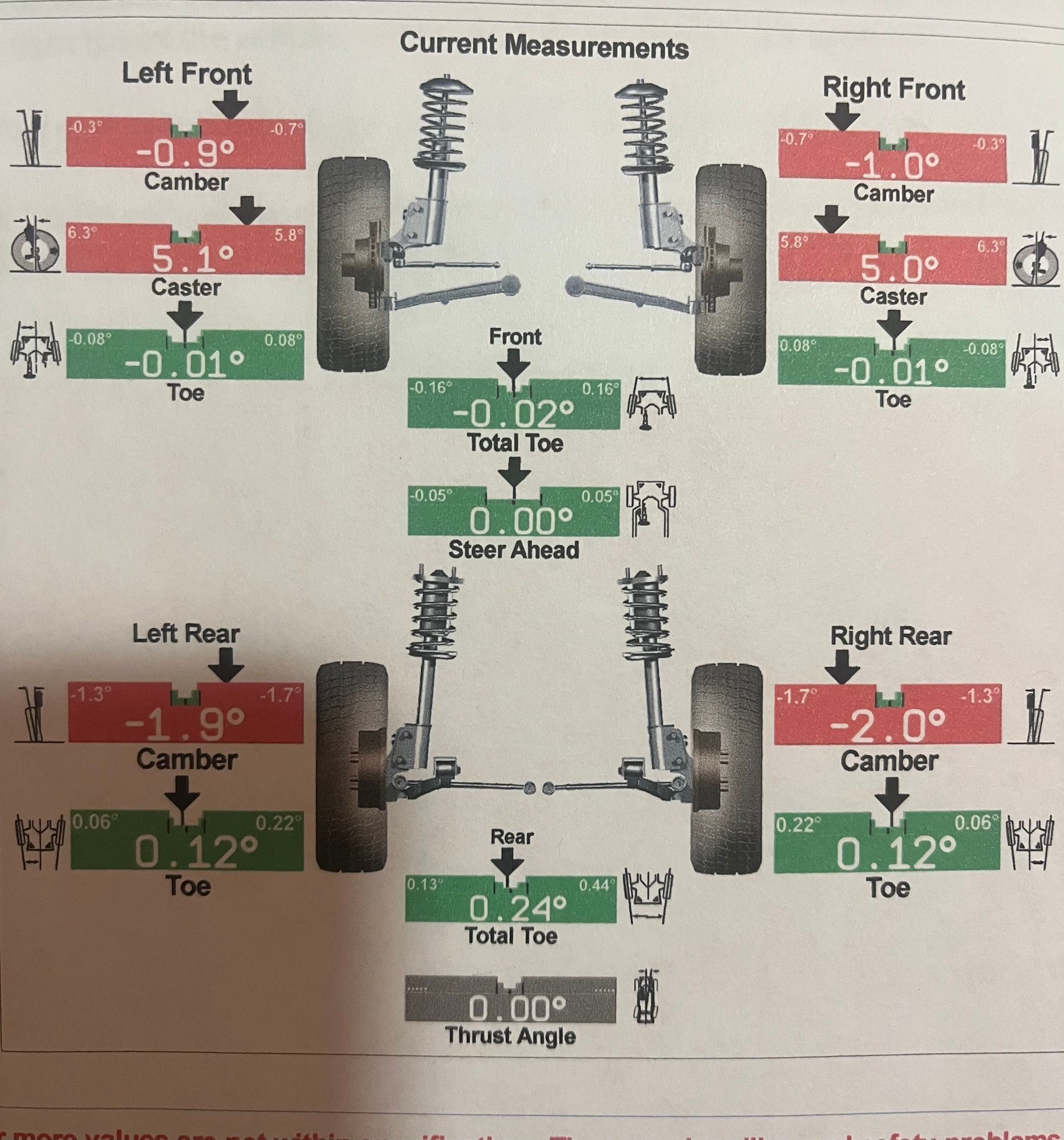

19 year member here, joined the forum when my dad owned an S2000 in 2004 but never posted. I just picked up my first S2000, a 2005 with 27k miles.
The previous owner had it aligned and said it was aligned to be slightly more aggressive than stock. Car will be a weekend driver with the occasional AutoX. Suspension is 100% stock and has new Continental Extreme Sport 02’s all around. Are these alignment specs suitable for street driving and occasional AutoX? Thanks

Yea, that looks fine enough to be fun. If you want to be competitive, you can ask for different specs and tires but you don't need it to start.

Yeah, nothing wrong with it.
You'll be beating up the front tires a bit when autocrossing. But whatever.
