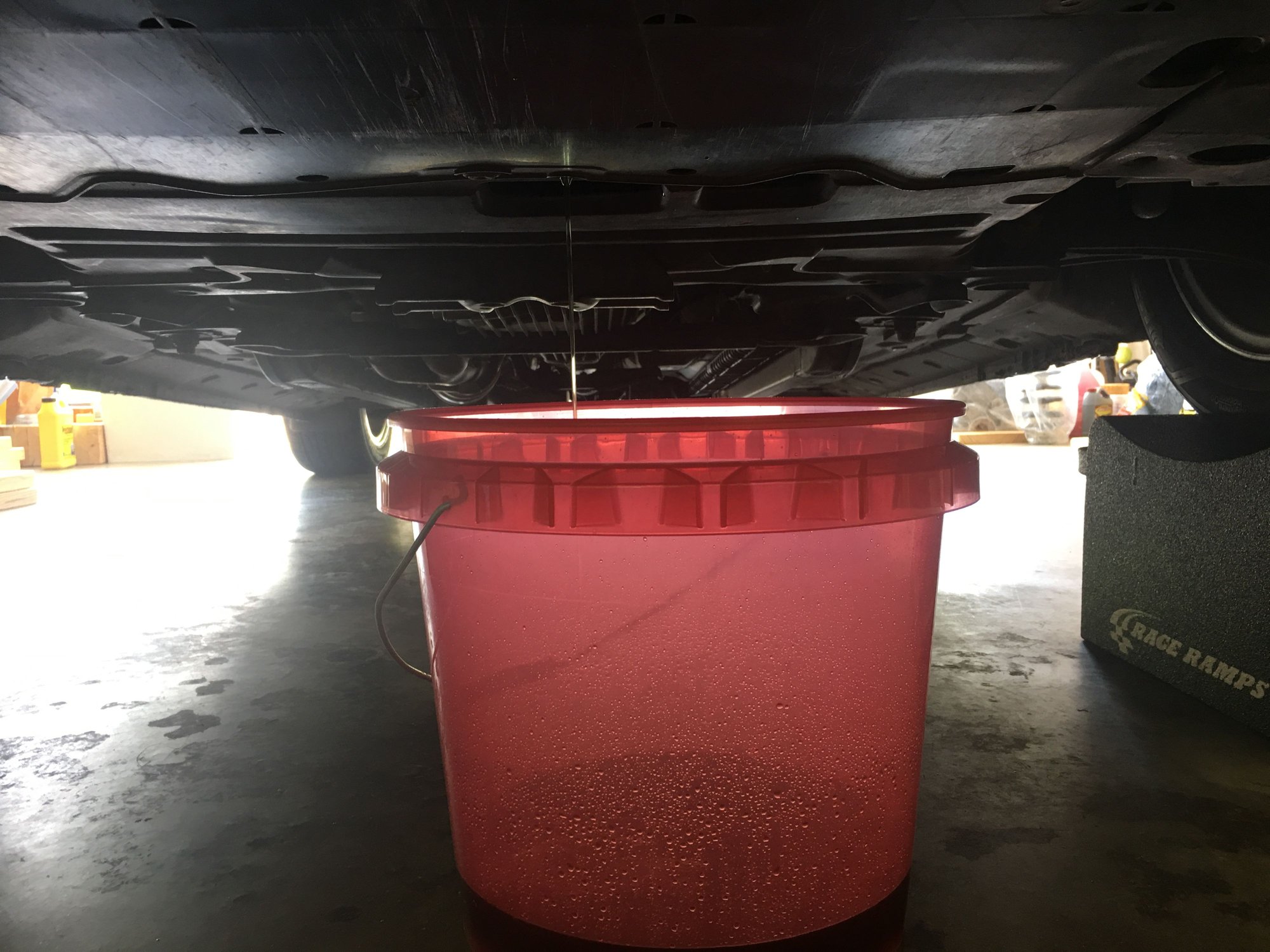

I don’t have any from the side showing it up on all 4 cribs, but I got two from under the car when doing a coolant flush recently. I’ll get a couple next time I have it up on all 4 cribs. For reference, that’s a 3 gallon bucket under the radiator.

@CH53Driver thank you so much for the pictures! That looks like it has adequate room.
