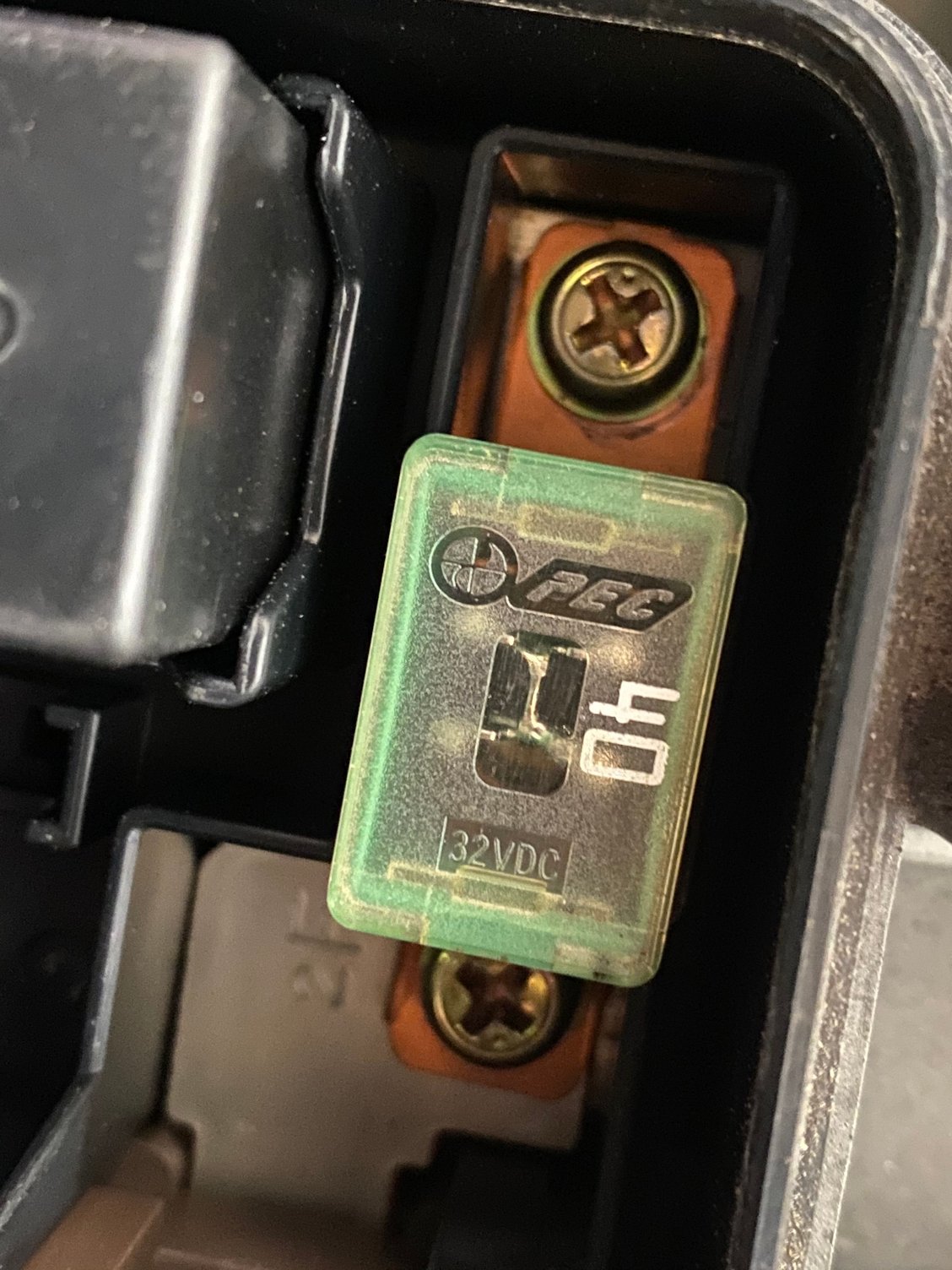

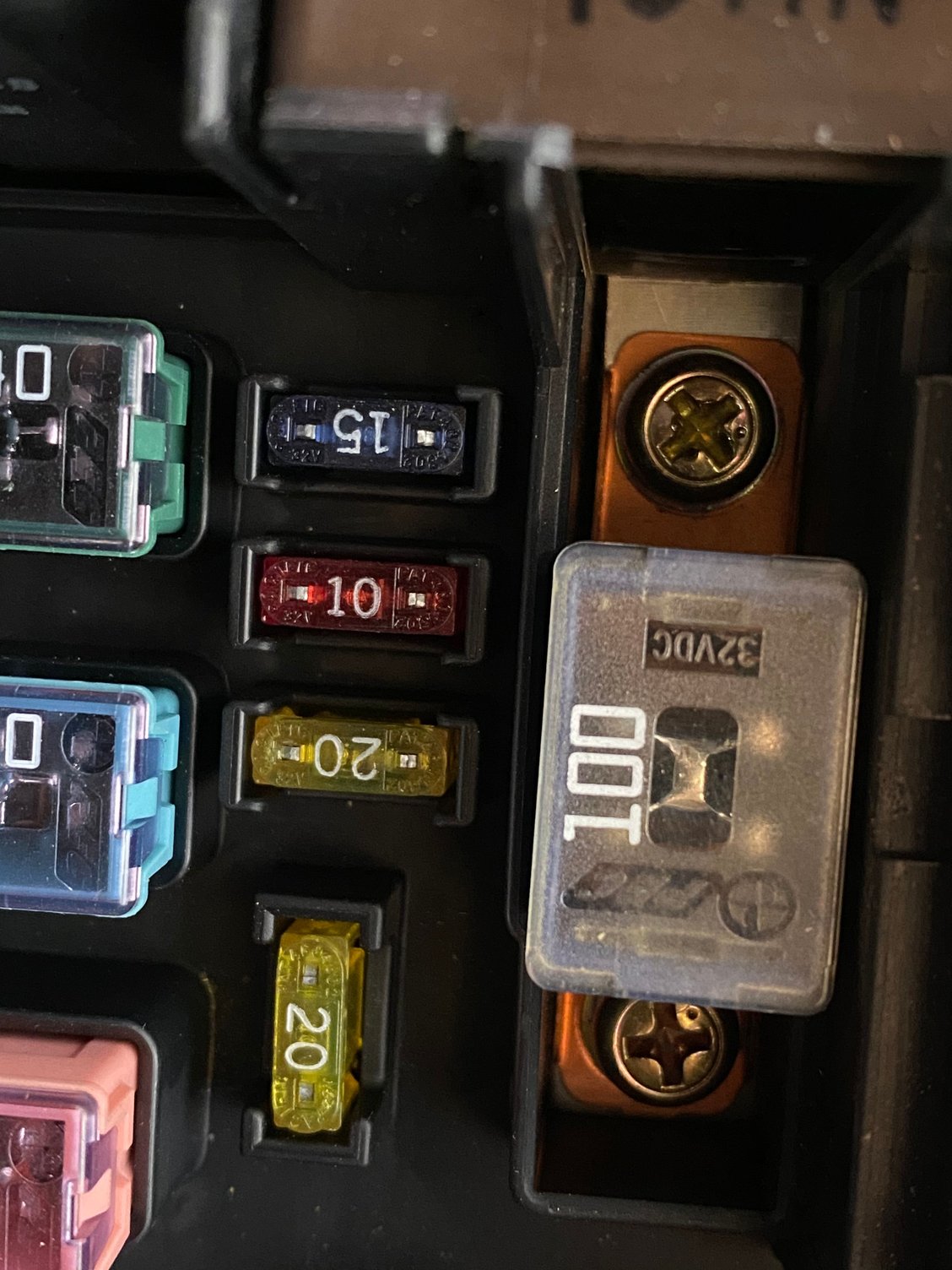

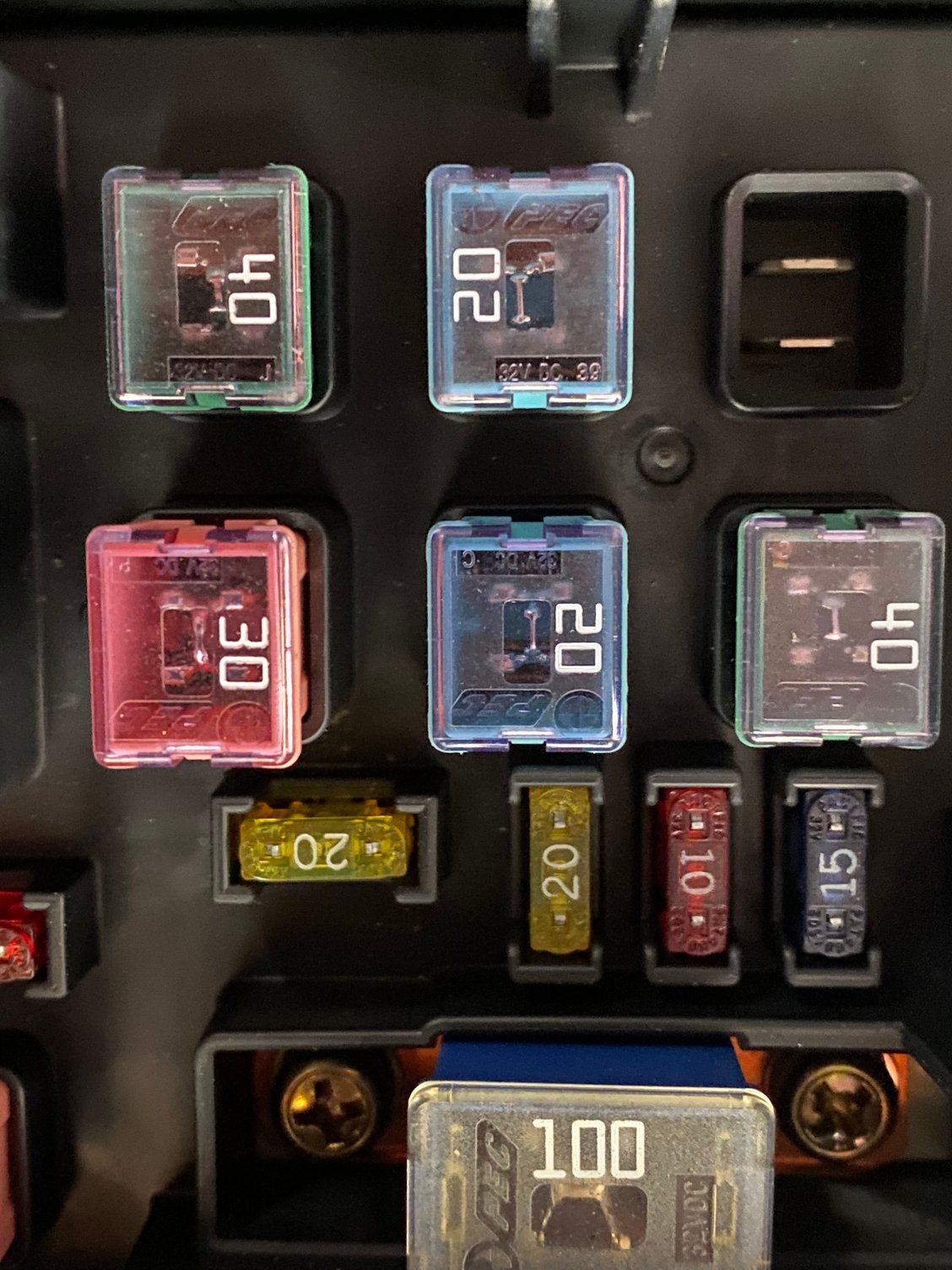

In the under hood relay box, Fuse No. 41 (100A) and 42 (40A) are in line with the ignition switch. Fuse No. 3 is connected between the ACC HOT line on the ign switch the Engine Start Switch but if you have no dash lights then that one would not affect that.
Without the key in it do the headlights come on when you turn on the headlight switch? I am guessing the answer is no but just checking as that would further isolate the issue if they do work.
Also, while those fuses most times will show clear visible signs if they are bad, they do not always. They are best checked with a meter or a test light. You can get a test light for very cheap (grounds on one end, probe end for power) and you should see voltage on both sides of those terminals. The two main fuses are very easy to find in that fuse box. They are labeled Ign Main and Battery I think. They are in the lower center and right hand corner looking at it with the label right side up
If those look good, I would still remove the battery cables, clean them well and re-attach just to be sure that is not the entire issue. The tool is a metal can looking device with a female end that has a metal brush around it and a part you pull out that has a metal brush to clean the inside of the terminal ends. Good to keep around and good to remember to give them a quick clean when you remove the battery cables.
