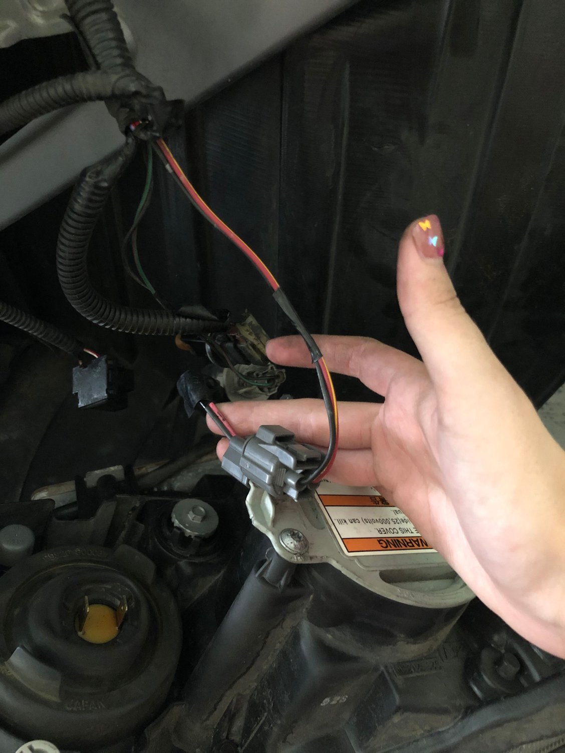

Hi everyone!
I am having a tough time disconnecting these from the headlight, how do I do it? Just pull apart?

There is a tab holding the connectors to the gray colored cover. You need to slide it off of it. Then you'll press the small release tab below your right thumb in the first picture and separate the connectors. If its not coming off, you can use flat head screw driver and gently pry them apart while holding down the release tab.

thanks! I got it!
