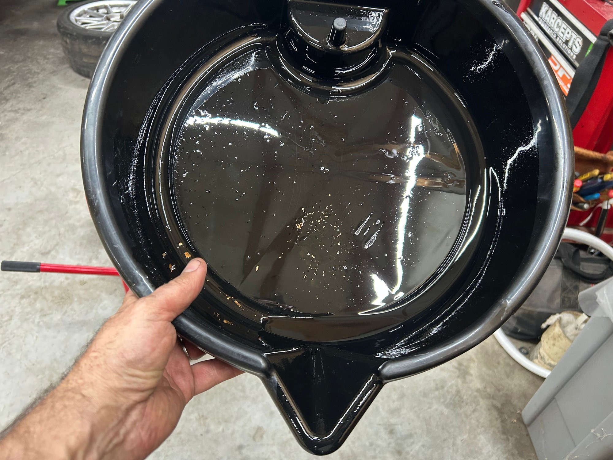

Eventually, I drained the oil collection pan. I found several large metallic flakes roughly 3/8” x 9/16” (some copper / bronze and some silver in appearance).

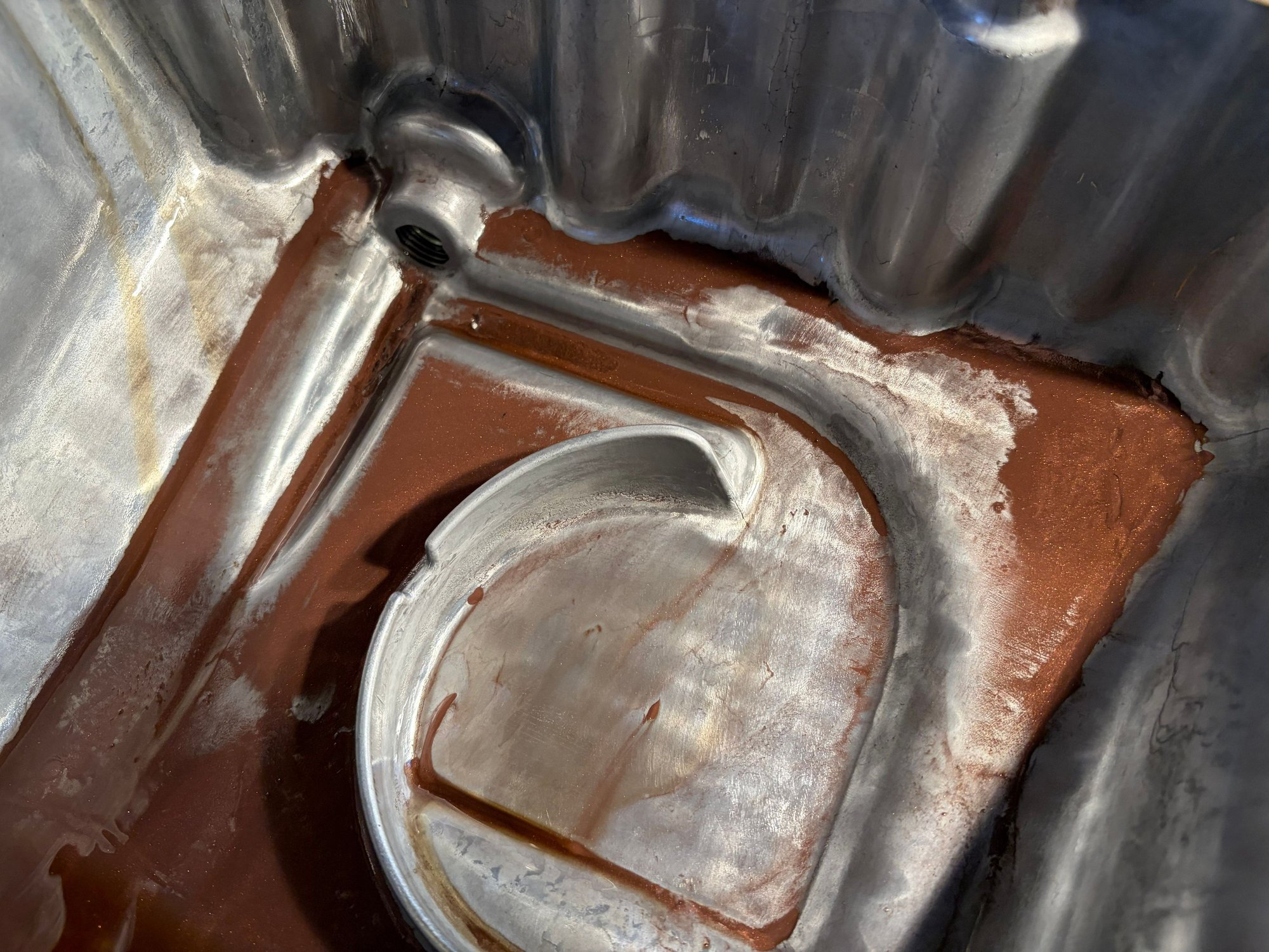

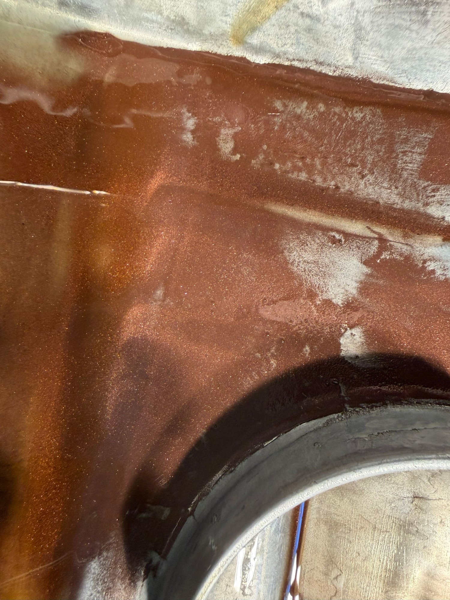

I removed the oil pan to examine for any additional metal flakes, especially the oil pump pick-up. Oil pump pick-up screen was clear – no metal debris. No additional metal flakes in the pan, but residual oil did look sparkly. A thin layer of sludge on bottom of the oil pan. Initially, I considered this consistent with engine mileage as the oil pan had not been previously removed. But after decanting virtually all of the free flowing pan oil, the “sludge” at the bottom of the pan appears as a very fine, copper colored material, presumably metal.

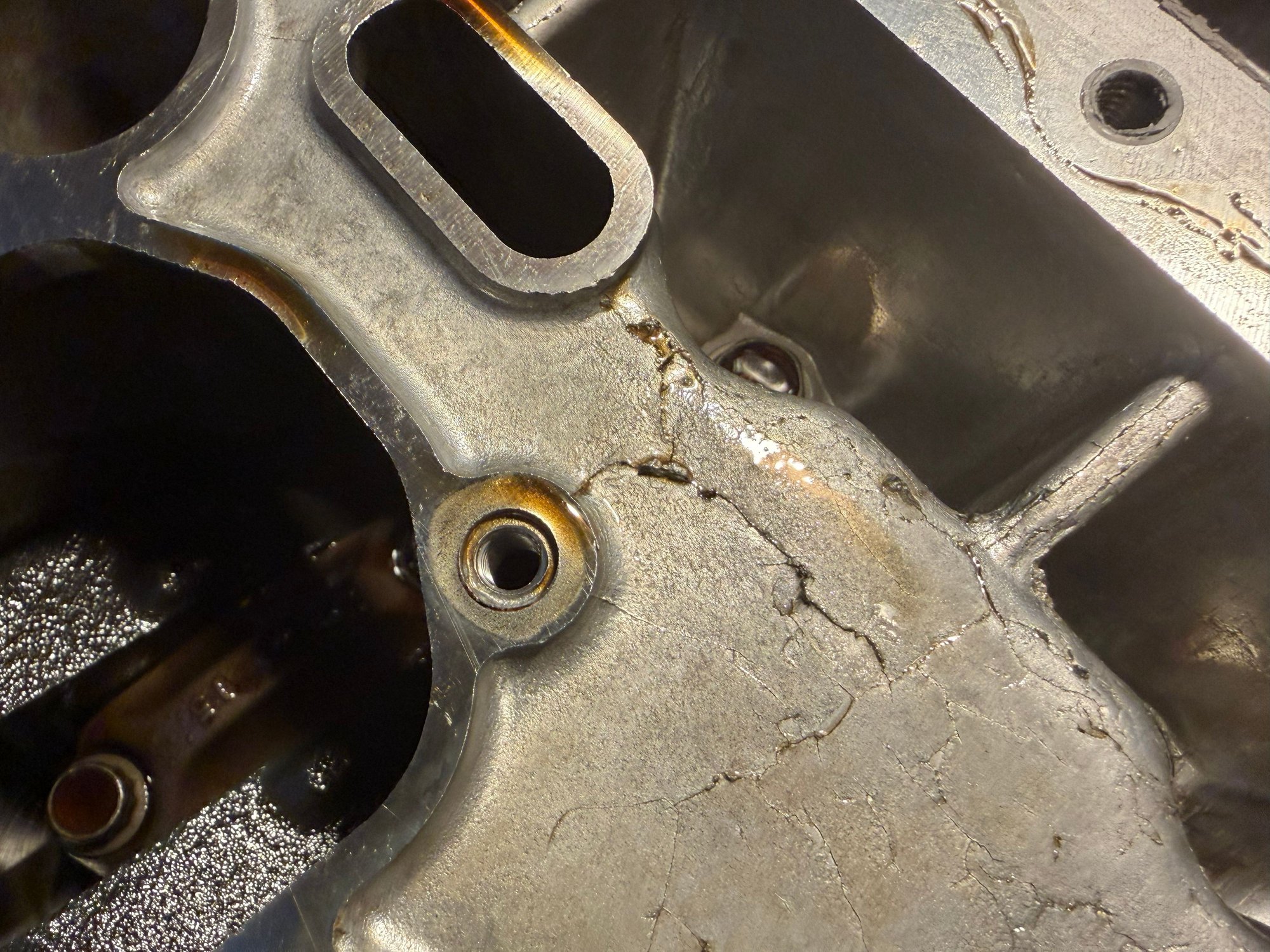

I did a close examination of the lower engine block. There seems to be a fair amount of casting defects (fine cracks), especially in the lower girdle. One area appears a likely source for some aluminum cast flashing; and that is perhaps the source of the large silvery metal flakes found in the oil pan.

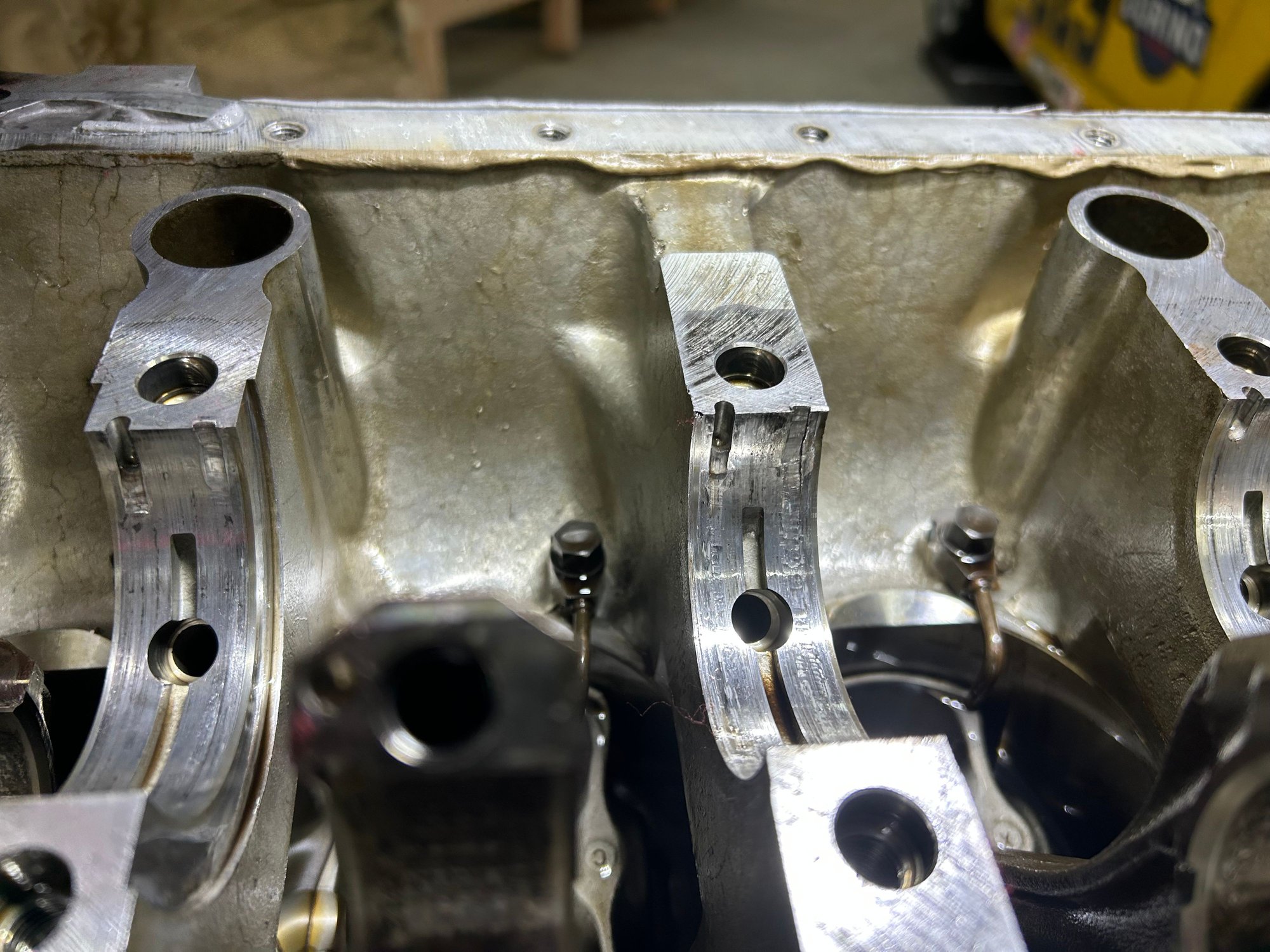

At this stage, my strong suspicion is that I have valve seal failure, perhaps combined with valve guide failure. But now I’m stuck on the bottom end. With the boroscope, I’ve pulled the codes for sizing rod bearing replacements. Of course, I don’t want to do that job but fear I must. My plan is to order a set of rod bearings and new rod bolts. I can then button up the bottom end and get back on top.

You sure that additive isn't the source of the paste?

Yeah, thinking same. Additive crap. That much copper from bearings, you'd have massive knock.

Well hate to be negative guy here but ... if you have copper pieces that large, you have at least one toasted bearing (that is the inner layer of the bearing material). And if not knocking, it very likely is the main bearings. Friends engine did this in the fall. Warm up lap at the track, oil light just barely flickered so he backed off and nursed it back to paddock (oil light stayed off at this point). No noise whatsoever from the engine. Oil filter had copper flakes in it like that so he loaded the car up and we tore it down at my shop a week or so later. Again, no knocking, no oil light on at idle. Rod bearings showed some signs of damage but nothing down to the copper. Pulled the main section and found 2 spun crank bearings. Talked to a well known builder of these engines who said the center mains tend to wear out first. All of the oil runs through those journals so once one spins of course, oil stops and more damage occurs.
If you really have copper pieces that big (or even just sparkly oil) its not clearing up, not going away. I would keep tearing down until you find the issue. Rod bearings at the point you are at are easy to inspect and if none of them show significant damage you likely have damaged mains. Check the head (pull valve cover) first to make sure it is not coming from the cam bearings.

Those are clear bearing shards, not a fine reddish paste though. I suppose OP has nothing to lose at this point since the pan is already out, may as well pull a rod bearing and see if there's any damage. The rods usually go out before the mains.
