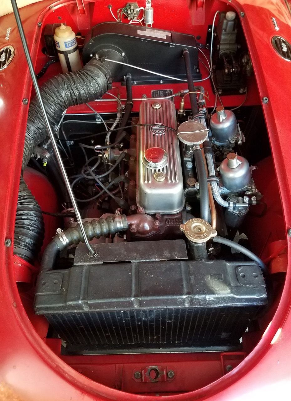

Mike, just for grins I'll show you the Mich car I mentioned since he is asking $18.5k. It's in excellent condition, solid body, new tires, new top, rebuilt MGB 5-main 1800 engine (great engine for a driver car), 5-speed tranny (again, great engine for a driver car), enlarged radiator, new hi-torque starter, etc. and includes the original 1600 engine. It's no trailer queen but it has all the mods that are well received by those who really know these cars and 'drive' them. Note that his doors and trunk could be aligned better. Not the car for anyone into complete 'originality' but one that you could jump right into a drive anywhere.

The MG is sweet. I like the idea of the B 1.8 swap. And actually that is the kind of driver I would want. But not red. And not from so far away. We'll see. Again thanks so much for sharing your experience and wisdom.
