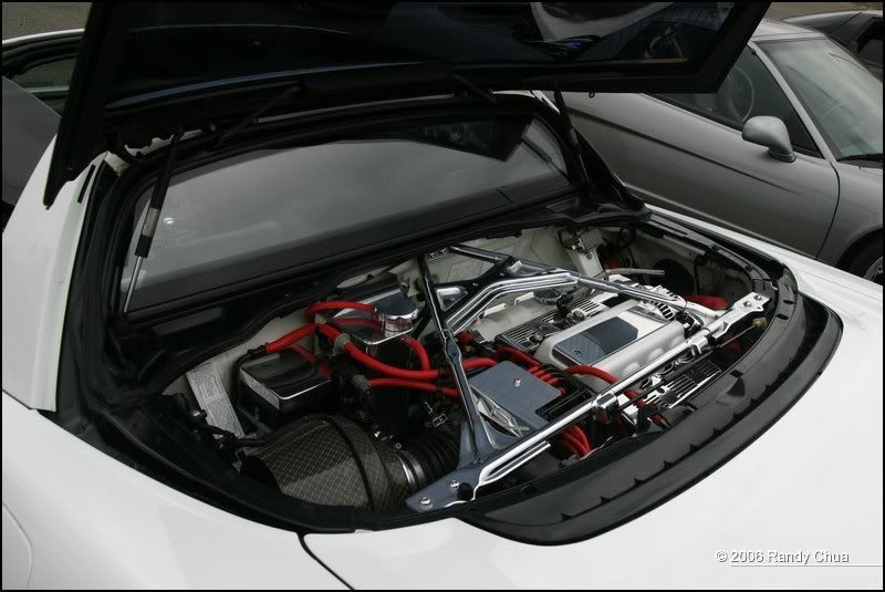

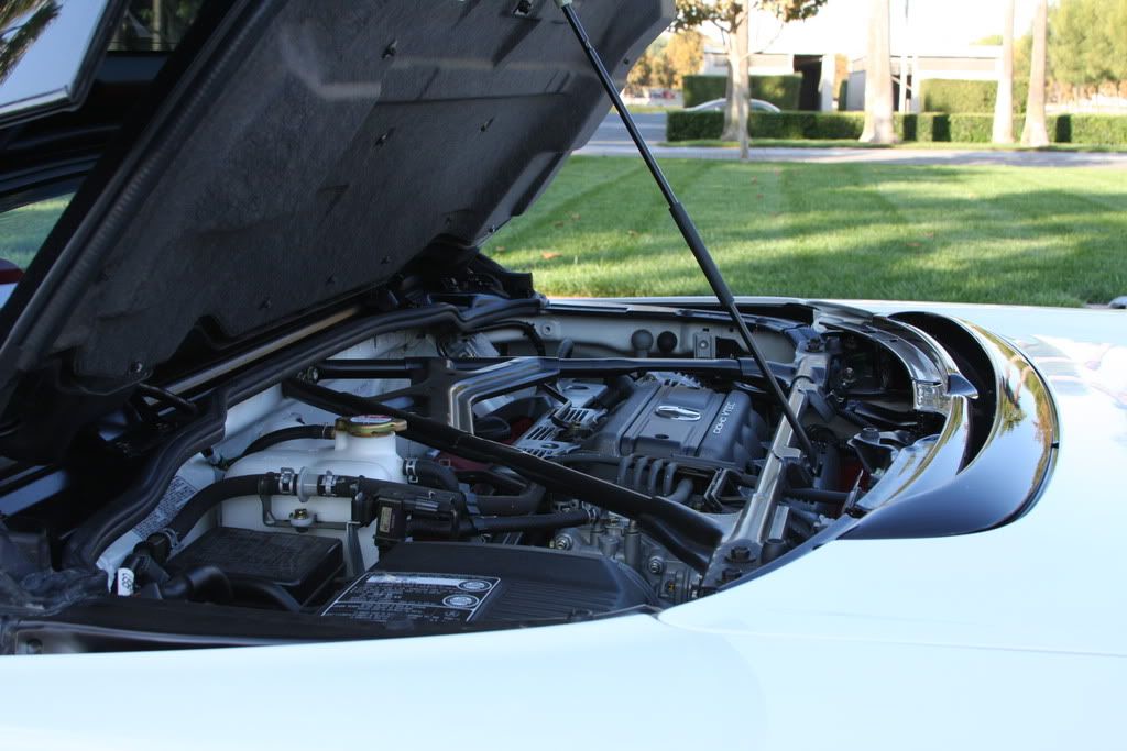

Pretty simple, I want to take my OEM STB from my nsx and polish it out.
I have access to basic tools, sandpaper, and a Dremel of course
BEFORE (what I have now)
AFTER (this is how I want it to look afterwards)

go to home depot. look for paint stripper in an aerosol can. made by kleen strip. i cant remember the name, but it works great.
of course you will need to remove the STB from your car first.
if it comes out pretty smooth after the paint has been wiped off, you can use rouge to shine it up a bit. if not, start with the least agressive sandpaper, around 3000 or 4000 grit. follow up with some good metal polish like 1Z or Adam's (both can be bought from our sponsor).
A tip about the paint stripper. Let it dwell for a while, after each application, then wipe off as much as you can befores having to scrap/sand any off. this will sve you sanding/polishing work in the long run.

Id use Jasco paint remover to strip off all the paint, than if it is smooth underneath I would start with 220 grit or even 400 and wetsand all the way up to 2000. Buff out with some mothers billet aluminum polish after that. All this would be done by hand. Bling Bling with some elbow grease.
